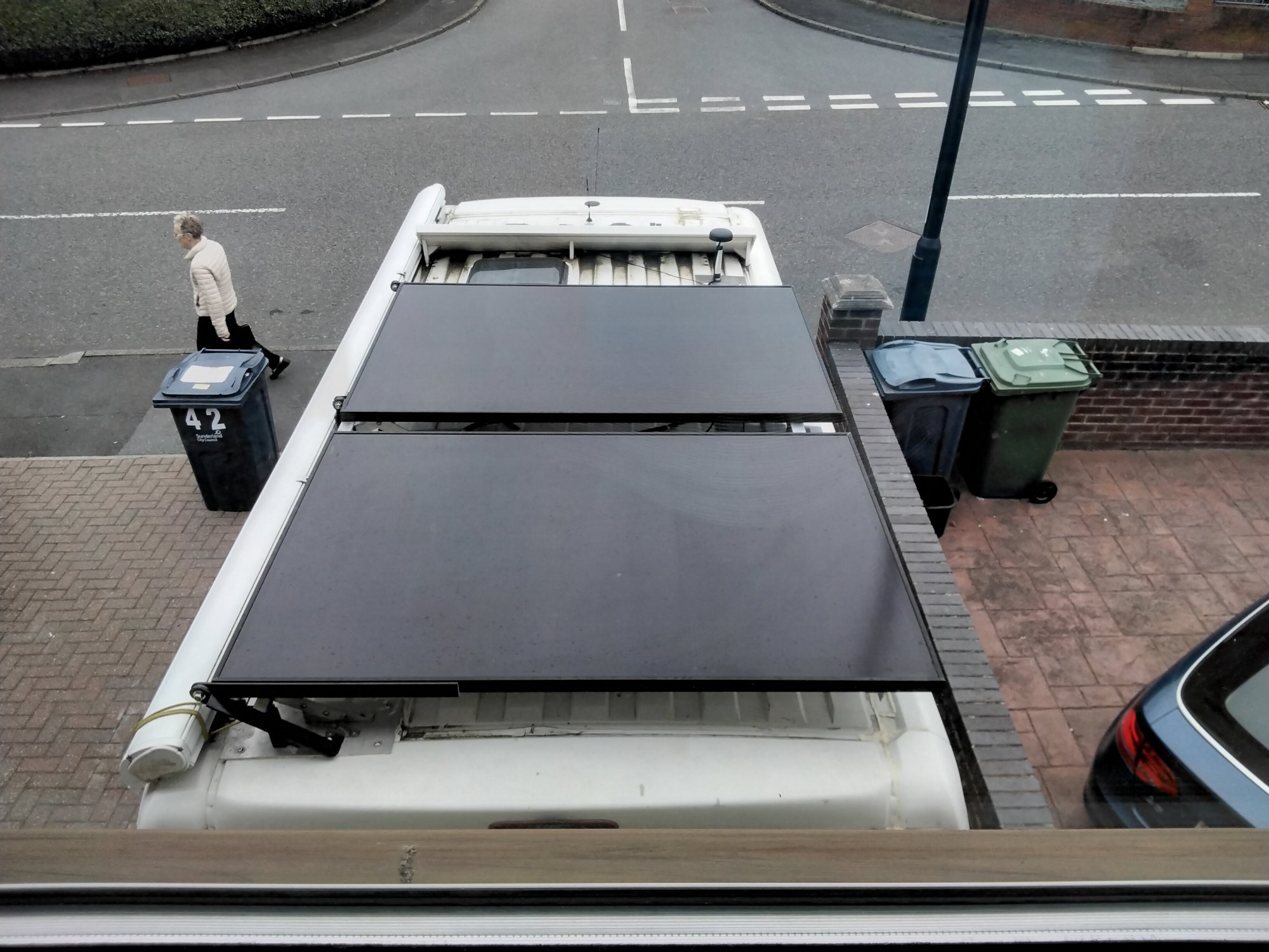

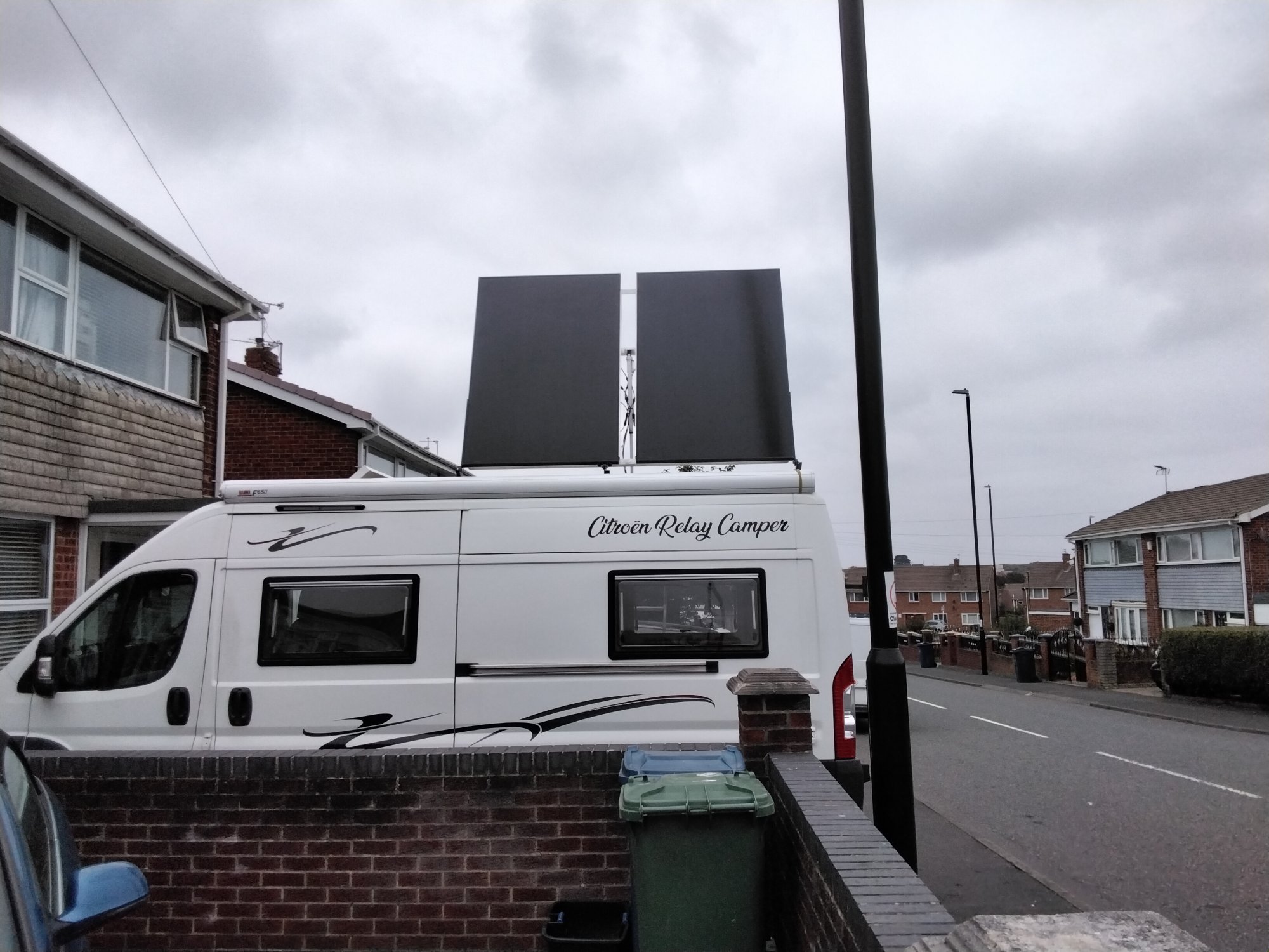

As you can see Barry I have two small 295 watts of solar lololol I did have to cover one of the sky light but it still vents

You have lots of room up there for two extra panels, just link the wires up to old main panel and then buy a good mppt regulator.

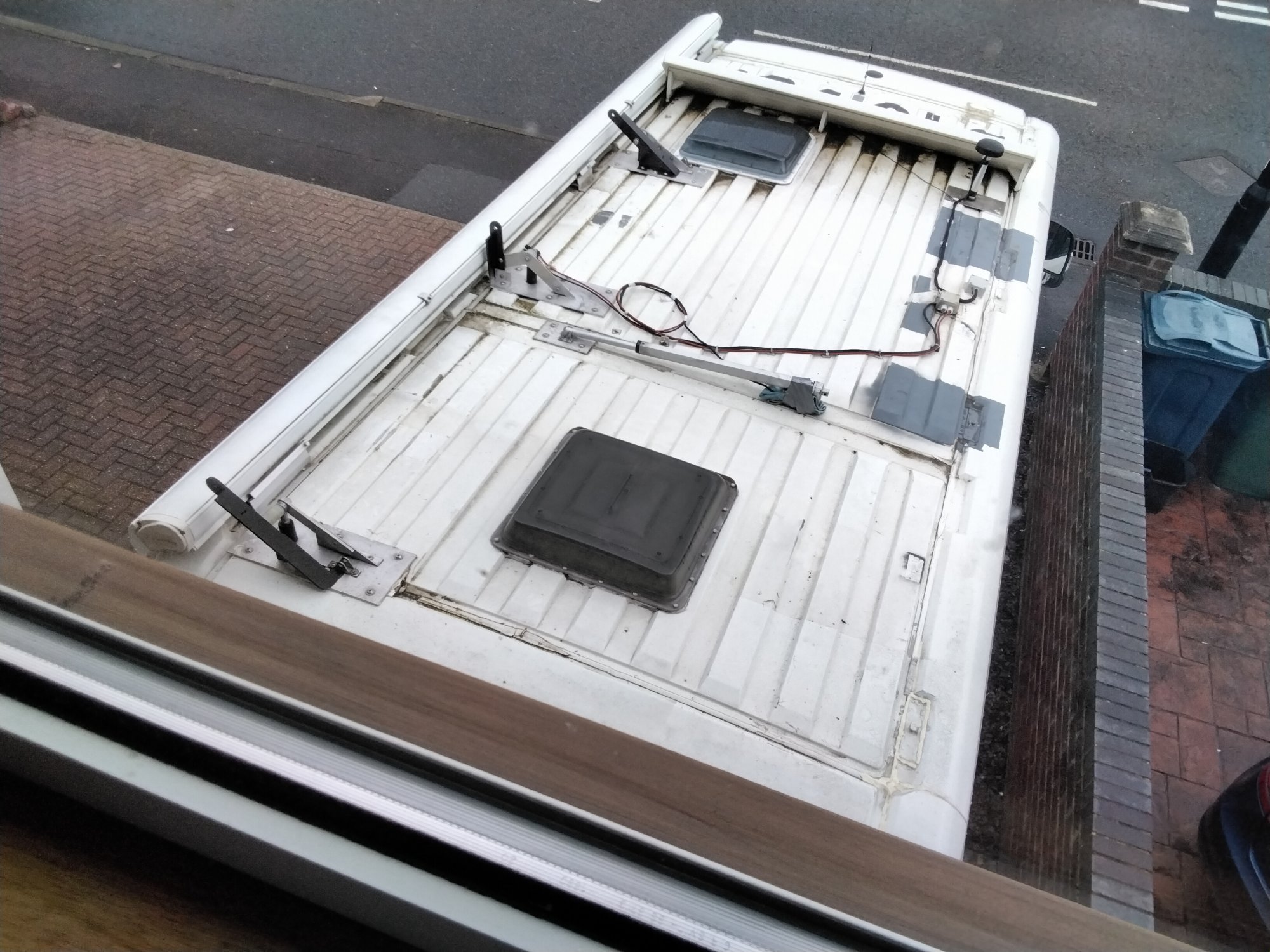

A few observations. My internal measurements were wrong. Its going to be too tight for even a 100w panel down the shorter side behind the roof gland for the existing panel I think and it will be the length that is too long. The cabling from the roof gland on that side restricts some length and the overlap on the roof light restricts some width. Also at the very back of the van the roof slopes slightly up so its not flat right to the back. As best I could measure from the roof gland cable to where the roof starts to curve up at the back is 115cm. The panel I found is 120cm but then you have to allow for the brackets. However what I did discover is the distance between the current panel and the back of the roof light is actually 57cm so about the same width as the side so you could fit a 100w panel directly between the current panel and the rear roof light across the roof and length wont be an issue there. It was really flipping awkward on unstable steps with just my head over the top with Michelle holding the ladder but I think I got it right. The only other alternative is the other side. I think you could get it far enough from that Aerial to avoid shade but remember, its spring, summer and autumn use for us anyway.
The arrows in red across the van show where I think a 100w panel might fit. It will be tight and it might restrict opening the rear roof light fully but it might be the best place for it.
Few more pics attached. Yeah I know. the roof is minging. Working on that.
