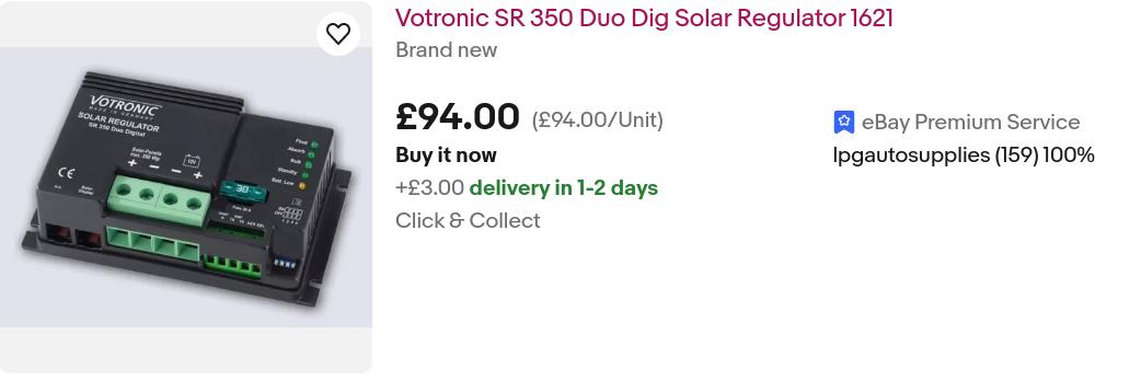

Think my viltron is a100/20 and is good for 290W of panels
Just have them overhanging . With your self confessed heavy right foot you could fly over the channelIt would be a bit tight when you add in the brackets. The same width brackets keep them narrow but they add a fair few cm to the length. I don't want more than one anyway.
2 or 3 will hit over a 100w & maybe higher no bother.Not really. Little ones perhaps. I've not spec'd lower than 100w but will have a look.
Yes I am aware or that one Trev. I think it was discussed up thread. Ill talk to Merl about it as I think he has a solution for the cab battery. The Victron MPPT seems the more widely known though.If not going down lith path then this will charge hab and starter battery.View attachment 141152
The 75/15 Victron would suffice Barry if you're never going to add more panels, it's available on Ebay for just over £41

Ah, all the ins and outs of this blue stuff isn't my forte Barry. As you say you'll really need bluetooth and a phone app so you can shout "Whooo Michelle, we've just hit a new high of 14.173 amps" and then high five each other.The SmartSolar range though has the bluetooth connectivity built in I believe though and the Blue Star unit which the one in your link is needs a dongle so the 100/20 Smart solar might be the better option. Then I can sit with my phone like a twat watching the amps etc.![]()
My MPPT from Photonic universe charges the VB too, so worth having anyway at a similar priceYes I am aware or that one Trev. I think it was discussed up thread. Ill talk to Merl about it as I think he has a solution for the cab battery. The Victron MPPT seems the more widely known though.
