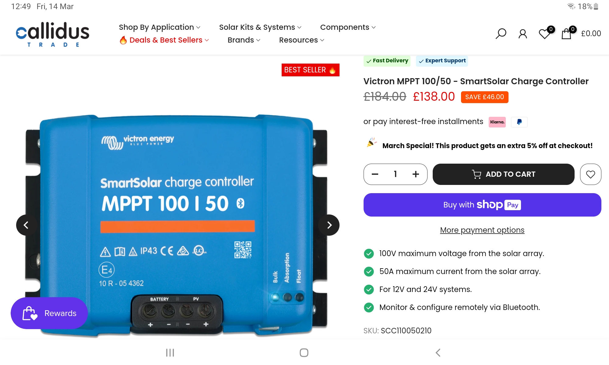

This is the one I have Barry and I am sure I payed the 184 quid for it lolol

Are you sure about that? 30 amps output means it will only cope with 420 watts of output, but I'm pretty sure it will cope with a LOT more than 420 watts of panels. It'd just limit the output to 30 amps when insolation was high. As long as the panel.voltage didn't exceed 100v, which really means you're limited to four 12v panels in series.
Your right but the mppt will only see a max of 420watts and doesn't see the other 180 watts of solar.

The mppt will only produce a max of 30A output, which limits output to 420 watts, but if it requires 700 watts of panels to give 420 watts due to UK weather, that's fine.
Sorry. I don't understand what you mean.
But I want 595watts of power and the old mppt would max out at 420 or 30amps which is no good me As I can tilt my panels up to about 85 degrees in the winter I can max out at near enough 50amps even In the winter .
