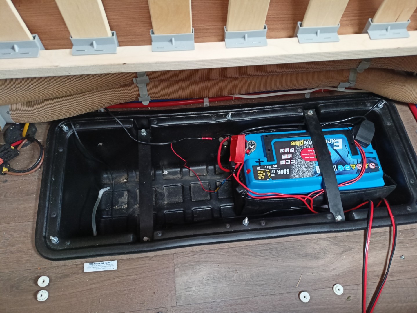

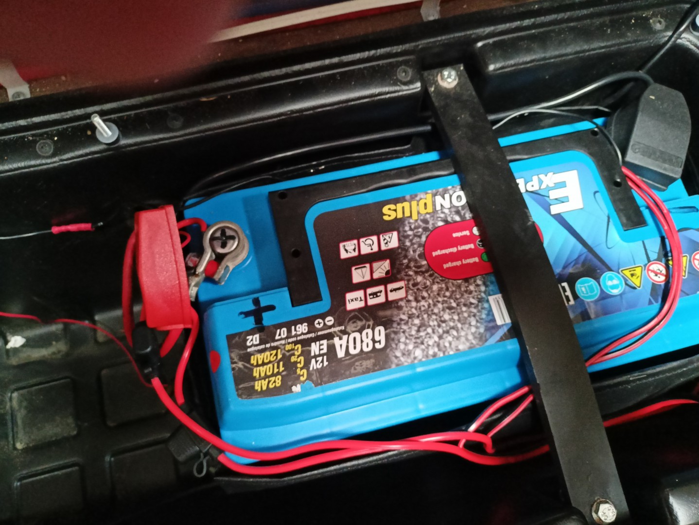

Can't you twat it wit thammer lad?Yep that could work cheers. As said ill get posted on here photos and vids and what I can tomorrow, get the gear sorted and ordered and take it from there. Im going to do a Whatsapp call with Merl also hopefully. I think the biggest battle might be getting that second battery holder out as the bolts that go through the box are knackered. Might have to saw them off. I can probably get that done though I would think.
That looks pretty straight forward Barry.
Whoa Kev love those, think I'll have to invest in some myselfNot keen on the cheapo battery clamps, I prefer this type, then once tightened they don't get touched again, but easy to remove if needed & not expensive

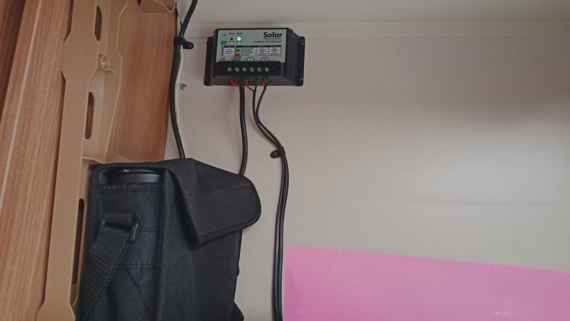

Great pics Barry but is your solar controller MPPT? If not would suggest you look at Votronic which have twin outputs ie one for charging hab batteries and another for charging vehicle batteryOk so here is a little video for you to look at. It should show in detail the controller, the feed in to the controller and the two output cables. One goes to the leisure battery and one out the bottom and somehow up to the cab battery. It also shows the fuse for I think the solar feed to the battery which I guess needs to come out before we start messing with it. Ive also shown the terminals. I think there is enough space for another identical battery. The issues are. How to remove that second empty battery holder as the bolts are knackered, do I need a battery bag, which cables do I need to connect the two.

View attachment 141020View attachment 141021View attachment 141022View attachment 141023
Been telling him that since before he bought it.Great pics Barry but is your solar controller MPPT? If not would suggest you look at Votronic which have twin outputs ie one for charging hab batteries and another for charging vehicle battery
Or these
I jsut checked out mine and they looked a bit manky so I invested in a set too.Whoa Kev love those, think I'll have to invest in some myself

I wouldn't be averse to that. Yes it's not mppt mine and yes it was mentioned but I'm not sure one was put forward with two outputs. I'll have a look.Great pics Barry but is your solar controller MPPT? If not would suggest you look at Votronic which have twin outputs ie one for charging hab batteries and another for charging vehicle battery

You need to bear in mind that there are only two wires Barry, one black and one red, and you would need to be pretty stupid to **** up, and although it would amuse me to say you are, you clearly are not or you would have done it all by now, at least buy the gear suggested that you need, basically a controller and a couple of cables, a 2nd battery and a MPPT controller then lay them out on the floor and just look at them, and you will figure it all out on your own (the best way) it's all very logical, even to a thick twat like me.I wouldn't be averse to that. Yes it's not mppt mine and yes it was mentioned but I'm not sure one was put forward with two outputs. I'll have a look.

Only the first battery gets MPPT. The second battery is just trickle charged very slowly. Nothing wrong with that, but worth being aware of.Great pics Barry but is your solar controller MPPT? If not would suggest you look at Votronic which have twin outputs ie one for charging hab batteries and another for charging vehicle battery
Are we talking mppt panel ? Sorry say yours looks a bit naff for my liking + the cable to you van supply look a bit thin for my liking .Could be but I did a Whatsapp with Merl this morning and we are going to have to be careful with the large leads that go back to the vans supply as they are not that long and I need to factor in getting that clamp out which is going to be a bugger. Also Merl thinks the connectors I need might not be the ones I linked to on ebay. There is talk of fitting another panel as well and Merl has offered to help with that. So I might hold off for now with your kind offer of dropping in on your way back from your trip. I dont think ill have it all in place by then and I think ill take Merl up on his offer to fit another panel as well. Much appreciated though.
That ok Barry .I don't know if your fitting a inverter or not if you are make sure the cable are well up to it .I had 35mm cable but ended up fitting 70mm as the 35mm where getting warm and you have to use the same cable to your batteries as well .Could be but I did a Whatsapp with Merl this morning and we are going to have to be careful with the large leads that go back to the vans supply as they are not that long and I need to factor in getting that clamp out which is going to be a bugger. Also Merl thinks the connectors I need might not be the ones I linked to on ebay. There is talk of fitting another panel as well and Merl has offered to help with that. So I might hold off for now with your kind offer of dropping in on your way back from your trip. I dont think ill have it all in place by then and I think ill take Merl up on his offer to fit another panel as well. Much appreciated though.
There are 100's of videos on how to do it all, just split them into different bite-sized jobs, not one larger one.
Take the controller you have, a bit of masking tape to identify which wires came out of where, mask ALL the red wires so they cannot touch the black ones, then fit the new one and put the wires back in, best to take the pos of the battery, but not essential.
For the new battery, place it next to the other, and just run red to red and black to black with the new cables, I prefer to feed into one battery and power from the other but that's just me and not entirely essential.
The new panel is not much more complicated, just two more wires to go into a junction box, then from there into the new controller.
