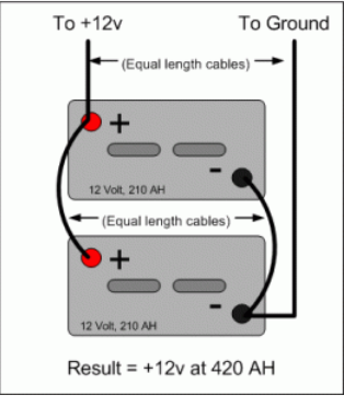

Not all Barry, when you get the new battery securely fitted alongside your existing battery remove your negative lead from original battery and fit onto the negative post of your new battery. Leave the positive connection where it is on the old battery. All you need do now is connect your new leads negative (black or may be blue) old battery to negative of new battery and do the same with positive old battery to positive new battery ( lead will be red or brown in colour) they will most likely be the old red and black colours I've just stated could be brown and blue as that's now the new positive and negative modern wiring coloursIll go out and measure again tomorrow and then get it all ordered. Ill then have to go and read the entire thread again to find out how to fit it all.![]()
Please learn about wiring colours before posting.Not all Barry, when you get the new battery securely fitted alongside your existing battery remove your negative lead from original battery and fit onto the negative post of your new battery. Leave the positive connection where it is on the old battery. All you need do now is connect your new leads negative (black or may be blue) old battery to negative of new battery and do the same with positive old battery to positive new battery ( lead will be red or brown in colour) they will most likely be the old red and black colours I've just stated could be brown and blue as that's now the new positive and negative modern wiring colours![]()
Make sure you have switched everything off and don't worry if you get a little spark when connecting your last connection, it just means something is "drawing" current. Just ensure you don't short negative and positive posts and cables can't "float" about or are trapped. It's a very simples job if you are careful doing it. Good luck and best wishes.
If that's directed at me could you explain further please? ThanksPlease learn about wiring colours before posting.
For positive and negative there is no 'old' colours of red/black, and 'new' colours of Brown/blue,If that's directed at me could you explain further please? Thanks![]()
Thanks for that information but if you read my post properly I clearly stated they would be red and black but I have brown and blue cables also connected to/from the batteries. You just can't help some people so end of from meFor positive and negative there is no 'old' colours of red/black, and 'new' colours of Brown/blue,
Thats for mains household, cars/vans are still red pos and black neg, here is the correct way to connect.For positive and negative there is no 'old' colours of red/black, and 'new' colours of Brown/blue,
Which is exactly what I informed Barry to do. Thanks TrevThats for mains household, cars/vans are still red pos and black neg, here is the correct way to connect.View attachment 140972
