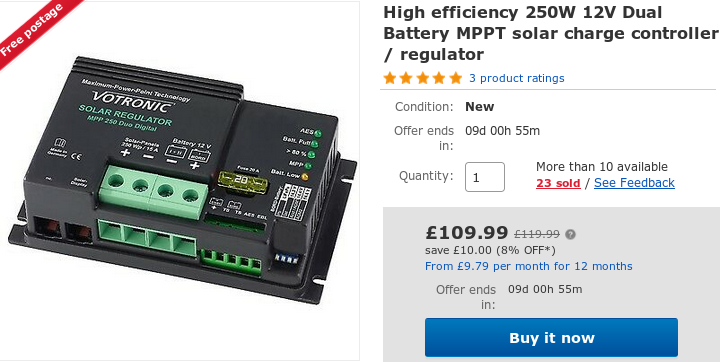

FLOWERY TWATSI nnever stay away more than one night, i have 2 90ah lead acids votronic regulator 200w solar, all running a 230v fridge with a smart 600w inverter, led lights and a tv which we never watch much, ph charging and some times a 400w plug in heater, again seldom used, but no way would this work in deep winter if staying off grid for more that 2 days max, each van owner must work out his use and sort to there requirements.
If this is way beyond you then book in somewhere LOL.View attachment 137284
That is simple, one panel controller and a battery.

Votronic.I think the point is if I'm doing it myself to keep it as simple as possible.
