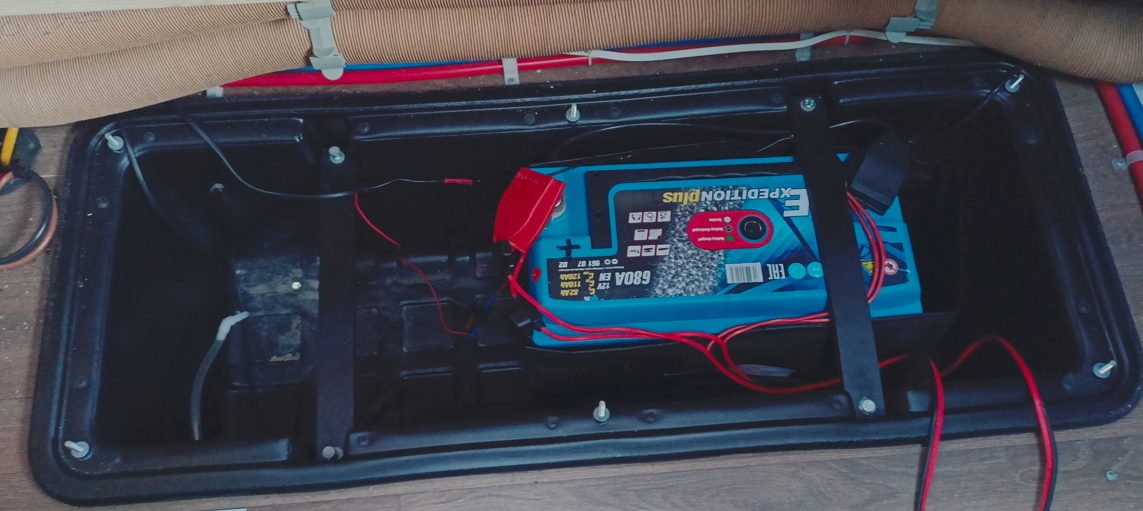

Bit of a development last night. It all went a bit pear shaped. I figured something was up Friday night when after three days of sun the Swift control panel was showing the last level at bed time on the last green light (around 12v). After a sun free miserable day yesterday around 9pm an alarm went off on the panel and the battery appeared dead right round in the red. It had also dropped to Yellow then eventually red on the solar control box. Interestingly though the lights, water pump etc were not dim.
This morning it's showing two green lights around 12.5 but my guess is it's knackered.
Either that or it's just not up to the job. I've already emailed VanBitz in Taunton who from another thread might be a good option to get it sorted.
The plan was to let it charge today and see what happens tonight and tomorrow.
All we run is two laptops, two smart phones, sometimes a TV and sat system, water and led lights.
I reckon it's a 100 or 120w panel, controller and a boggy basic 110 ah battery. Old van had an mppt controller, 100w panel and 120 AGM battery and would be fine this time of year under similar load.
So. What to do?
Pics and more info to follow.

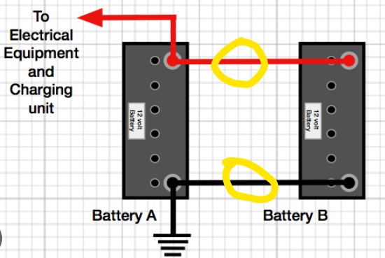

ThanksThe second battery simply connects in parallel with the first one, It's pretty simple to do. Once this is done then they can be viewed as 1 big battery so the SCC connects to this new bigger BIGGER battery just once.

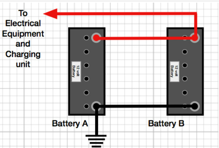

Ideally you re configure the pos and neg like this View attachment 137258
but as you're not drawing large currents it's arguably not worth the faff if the existing cables dont reach, in which case just connect another battery to the first one like this with some decent gauge cable and you'll be fine.
Bear in mind that no matter how big your battery is it'll go flat if you cant recharge it effectively, basically your battery is only as good as your charging system. What'll work for you will depend massively on how you camp and use stuff but if you've got double the battery it'll take twice as long to replenish on your existing solar.
