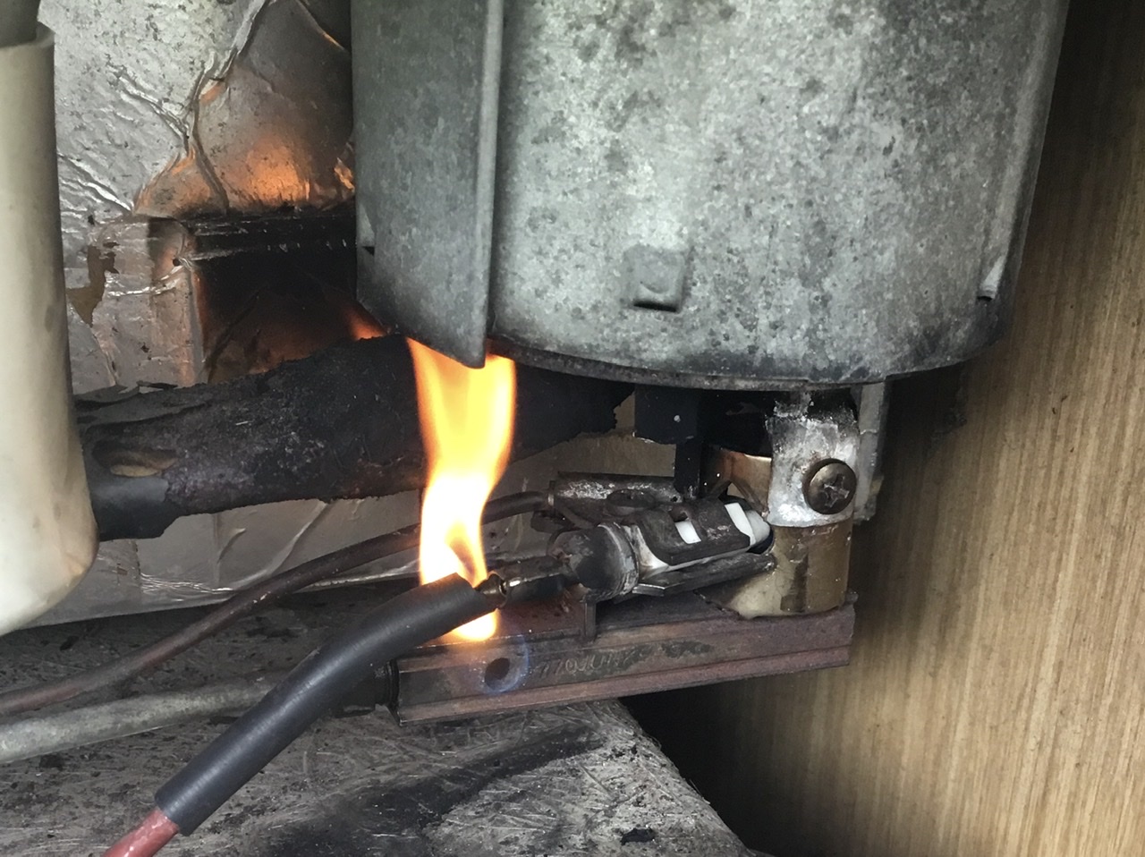

It looks as though you've put it back together & left the tiny jet out.

The flame is in the holes AFTER the jet bit. Taken the main pipe bit part out & am cleaning it inside - thought I had before, but it must have been blocked?
The sparks jump to ground they won't jump in mid air, and it very honorable to reuse the original bits but to be honest I would buy new replacements

If you leave the jet out, that's what you expect to see.
The jet was in place. Cleaned the main part out again & put everything back together but now not getting a dickiebird.

Put everything back together, put gas on & tried again - er...
From the earlier photo's this is obviously how it was running before, I'm no gas engineer so have little to guide you apart from saying that AFAIK air should be being drawn into that hole, assuming you have cleaned everything out quite why the gas is burning from it I don't know, others with more experience will have to guide you.

The jet was present, but it looks as if it wasn't "in place". The jet is just a precision hole that limits the flow of gas. Then it should point at the inside of the burner, mixing in air as it goes. If it was not properly seated, perhaps gas was getting past it.
If not enough air was mixing in, you get a yellow flame which soots up the heat exchanger/flue, so you ought to clean that out.
I use a small bottle brush on a long string that I pull up and down through the vertical pipe.
