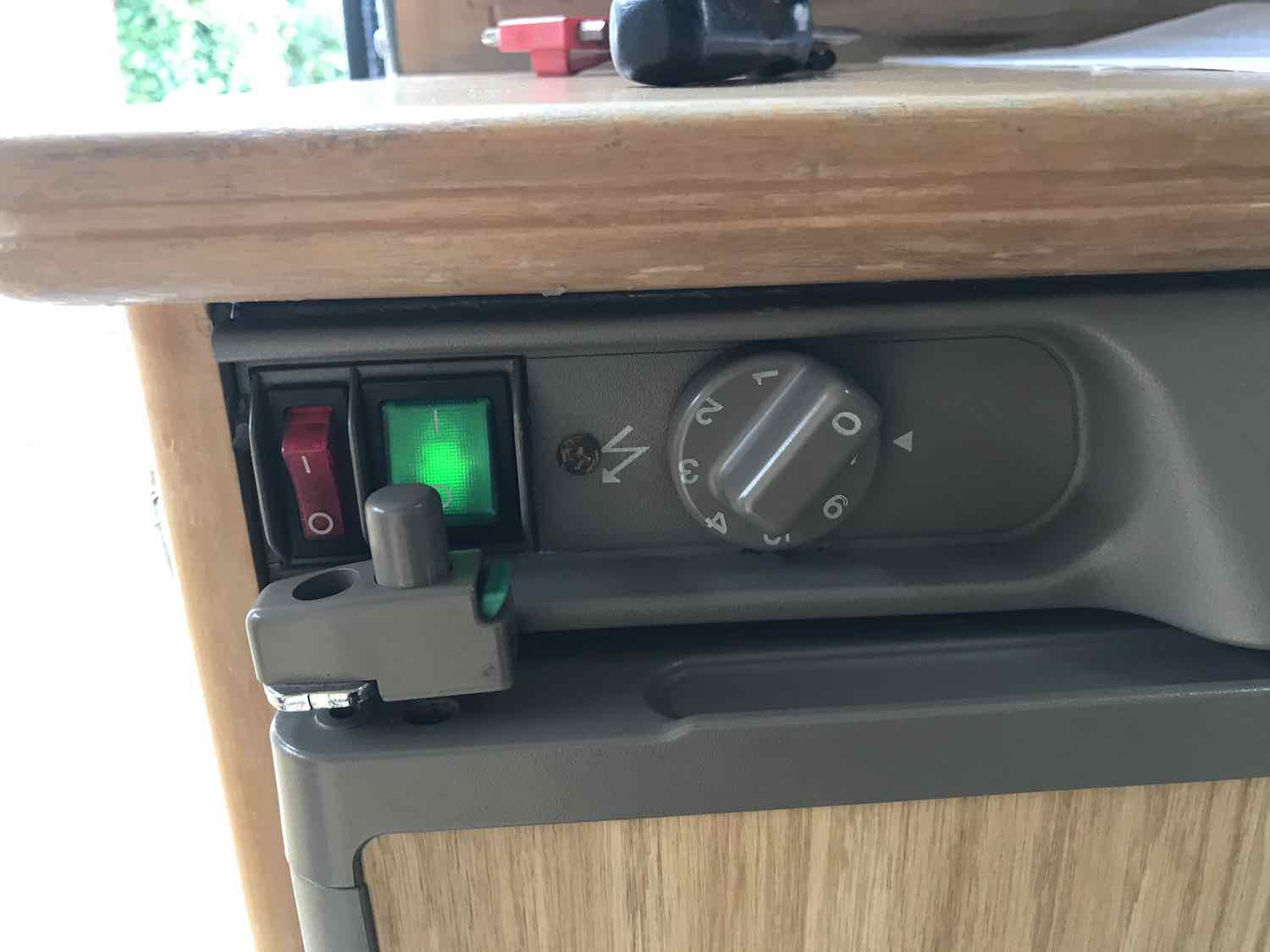

On ours the 12v and Mains are at other end of fridge and are red and green (IIRC), but the ignitor switch is next to gas controls and is orange
Here's the pics I took last night. Been out all day, first chance I've had to post up.
Sounds like our fridge is similar or same as yours, Colin?
Fridge LHS:-
Fridge RHS:-

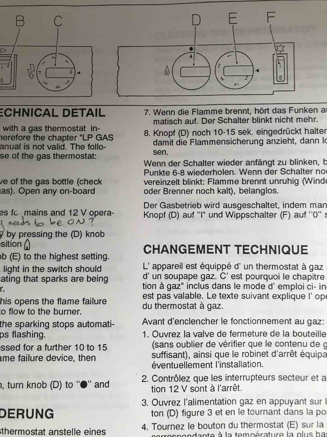

Ours is the same or similar model, although I had thought the control panel was flat, but might be wrong.

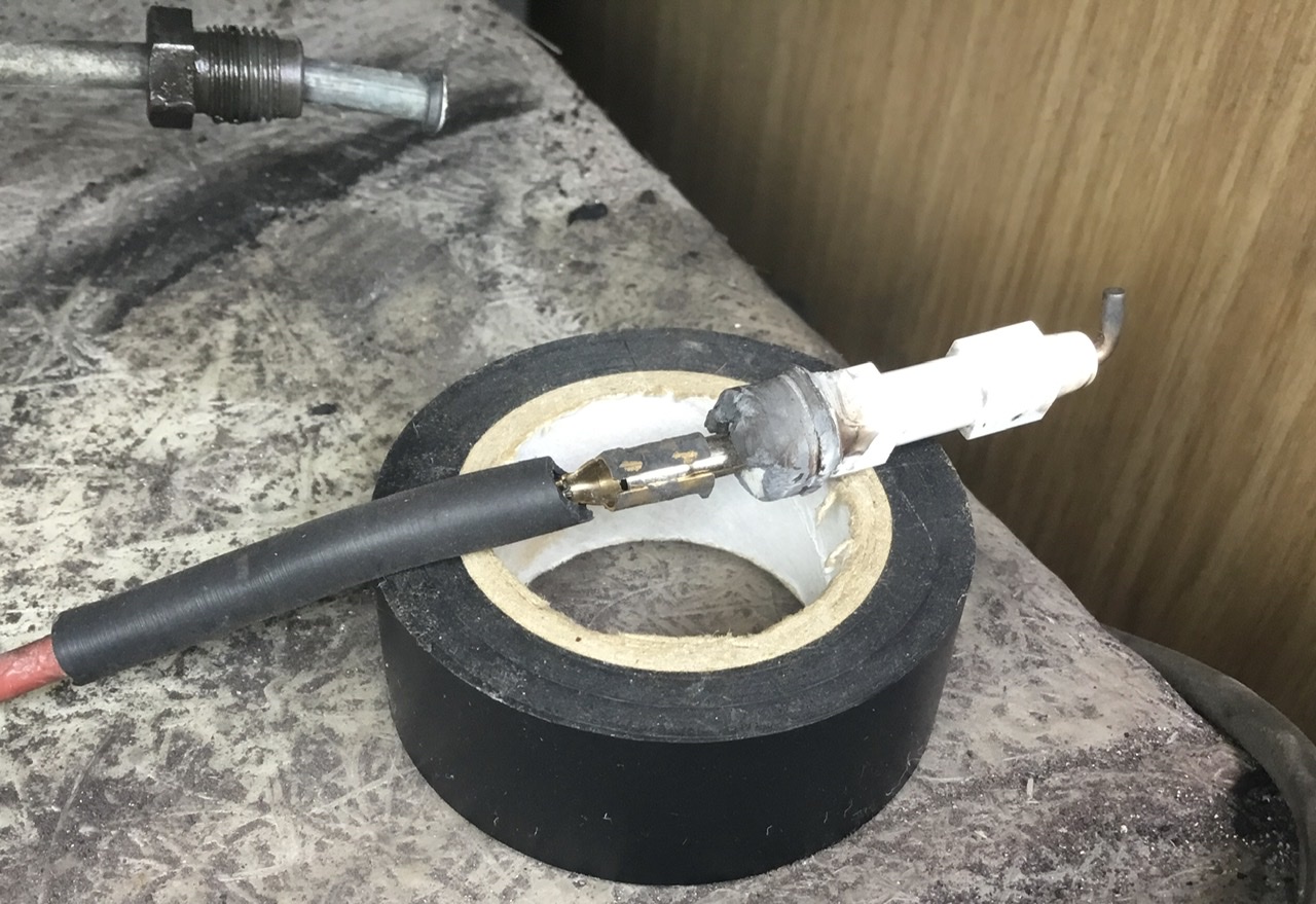

Taken apart - cabling insulation for spark plug corroded.
when these things leak ,there's sparks coming out of every crack . the electrode looks like it'll clean up ok , just needs the lead sorting out . test it at night to show up any leakage

Do you think I will need to take the fridge out & replace the whole lead - or can I patch up the insulation in some way?
(Used heat shrink once but don’t have any)
as long as you have enough slack ,you should be able to cut away the bad insulation and reconnect . not sure how hot that might get though ,but it must be fixable

I‘ve refitted the igniter, as shown below, then tried the switch which flashes away, but no sparks be seen.
Does it need to be totally insulated first?
Think I need a new lead & / or igniter?
The sparks jump to ground they won't jump in mid air, and it very honorable to reuse the original bits but to be honest I would buy new replacements

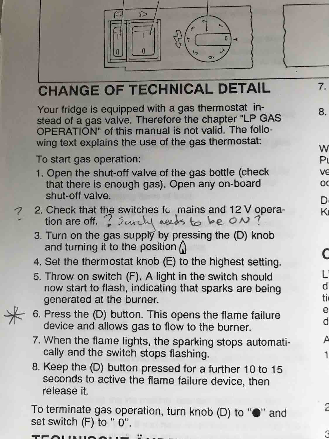

The written-in question: yes, the mains and 12v switches should both be off.
The user guide for my fridge (different model) also has a completely wrong "helpful" comment written in by a previous owner.
