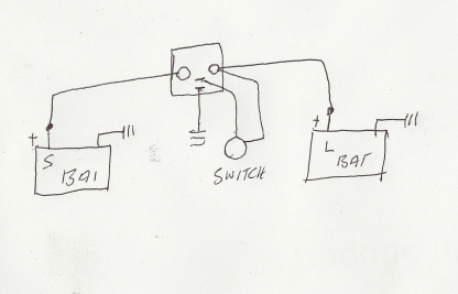

Simple solution in my van, 200amp relay and switch, use heavy battery cable.
