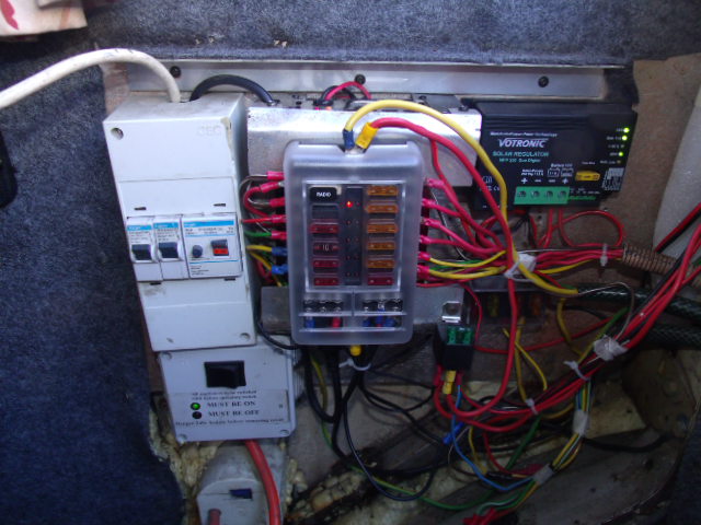

I have a switch and relay which connects my les batts to the starter bat for the avoe problem should i have left the lights on etc.
