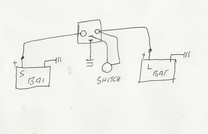

Or use jump leadsSimple solution in my van, 200amp relay and switch, use heavy battery cable.View attachment 123023
Hard to do if batts are way down the van & the starter batt is in the engine bay, switch and relay is the bogs dollocks.Or use jump leads
As we say in Yorkshire , nowts perfekHard to do if batts are way down the van & the starter batt is in the engine bay, switch and relay is the bogs dollocks.
You are right, many jobs also not as easy as folks say.As we say in Yorkshire , nowts perfek
Recent Ducato vans have battery under the floor in front of the swivel passenger seat if RHD. If you have dinette layout leisure battery could be under the other seats in this area. So easy to use jump start leads from leisure to vehicle in these without even getting wet!Hard to do if batts are way down the van & the starter batt is in the engine bay, switch and relay is the bogs dollocks.
