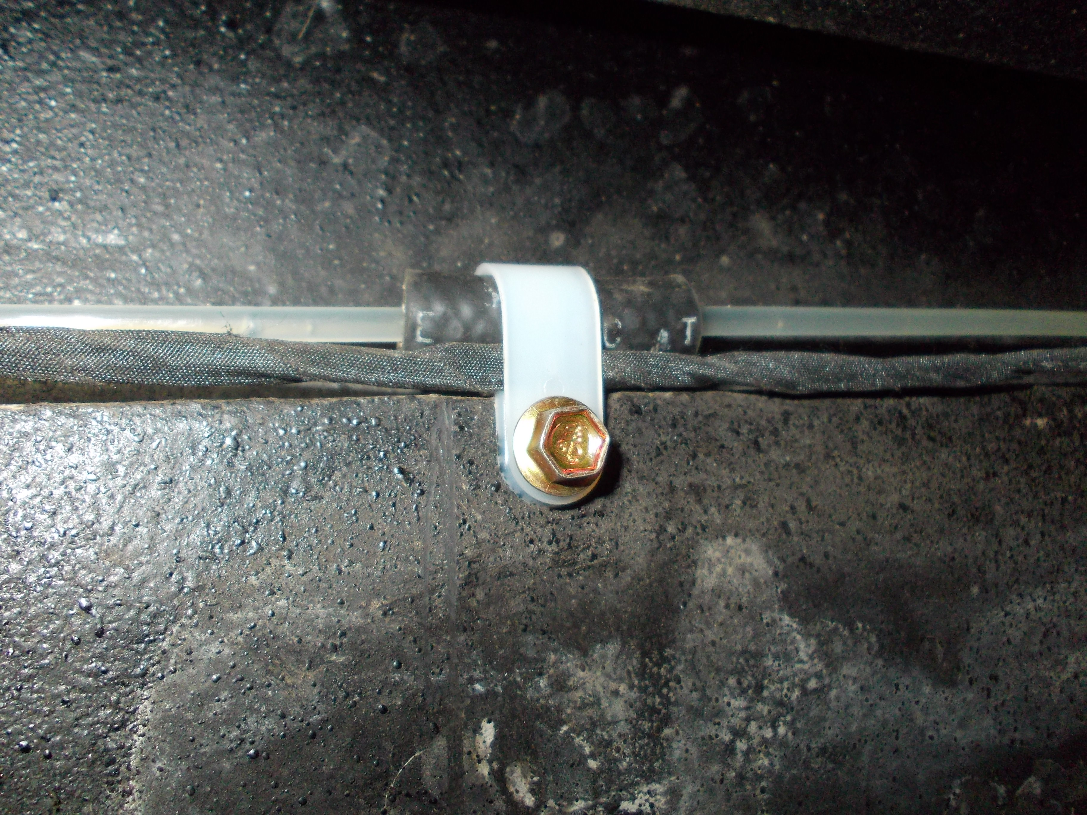

Cards on the table: really happy with the heater and the LED display I find very helpful. Coupling it into the original heating ducting was amazing, the difference is literally night and day. Down side: outside you can hear the exhaust, couldn't tell you how far away as the van is parked between two houses and now to the pump: as we turned the heating down the noise of the pump became more noticeable. At the temperature that we found most comfortable at you could definitely hear the sound of the pump, I can only describe it as the sound of a dripping tap......not loud and wouldn't affect conversation or listening to the television but it is there. I tried cutting three of the tie wraps off and though it made some difference the tapping was still there so I replaced one of the tie wraps and the pump is hanging at the right angle but a lot looser this time. I cannot see me eliminating this problem other than insulating the pump. If it was resonating through the body it would be more of a thump than a click but that can wait. My next job will be to tidy up the van and get it ready for when we can go away.

Sorry I was teasing about the cable ties. But seriously the fuel pipe can carry a lot of noise. I wonder if using longer lengths of soft rubber fuel pipe would help? The pump itself would be better held in something soft.
Did you try putting the fuel pump lines in and out with a 90 degree bend? That is meant to make a difference (I have done that from the start, but still hear it. maybe it would be louder on mine if I hadn't done that?)

I have already tried insulating the pipe where the P clips hold it to the body, perhaps I should have used more but the pipe between the two chassis rails is not touching the body.
Rae
