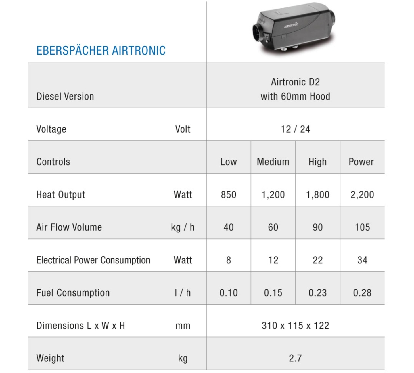

I ‘think’ that’s a fair bit worse than my DT4 Rae but mine runs off main diesel tank so not as easy for accuracy. I seem to think mine averages around 0.1ltr per hour but would have to search all my posts to see what it did last check. Not got to much use yet but may be able to see soon as back to Derbyshire to visit Charlie shortly, will be colder there lol
I don't normally run it through the night and there was no one in the van. I'm sure the heat of 2 people in the van would have made some difference to the amount of fuel that was used; I believe you can turn the pump down, which I have not done but will be looking into.
Between 0.10 and 0.23 litres per hour dependant on setting for Eberspacher D2....
I have to say in all the time I've been running one I've never noticed an increase over the base line consumption of 30 mpg drawing fuel from the main tank...
Even when we've been away in the depths, of winter with the heating on full chat 24/7...

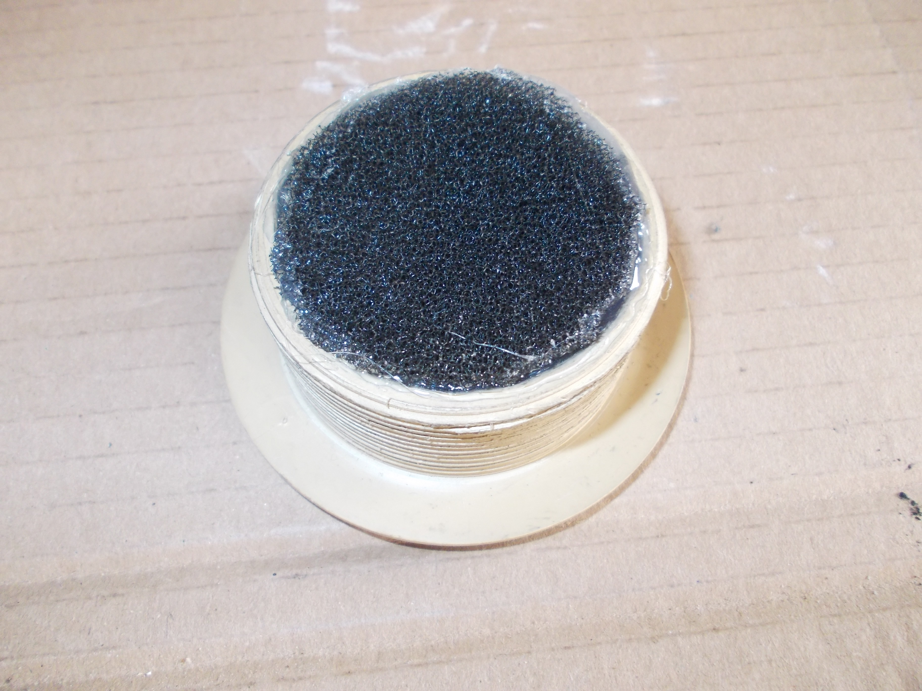

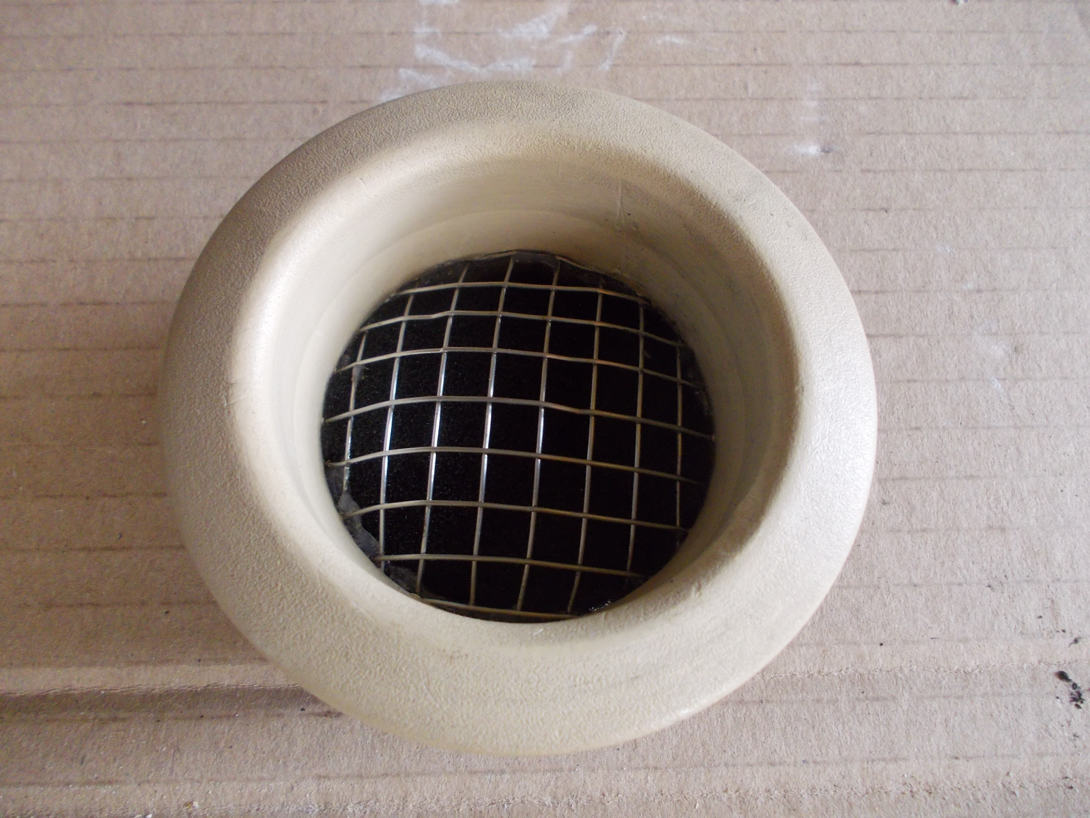

After easing the fan away from the main body I seem to have cured the squealing noise. So with that problem, hopefully, solved the last thing I wanted to make was some sort of induction filter; this was made from cutting up a surplus car air filter, the wire gauze that you see on the outside is normally on the inside with the foam wrapped around.
I tried it out first without the foam in place and then with the foam in place, there was no difference in how the heater ran, just a lot quieter from the intake.
Though it's a free flowing filter I made sure it was glued on the inside and around the outside. I used a hot glue gun and it seems to have done quite a nice job holding the foam to the plastic.
Last picture shows the finished article. Never to be seen as it's tucked behind the driver's chair nearest the wall. Hopefully, now no nasties will be sucked into the fan.
