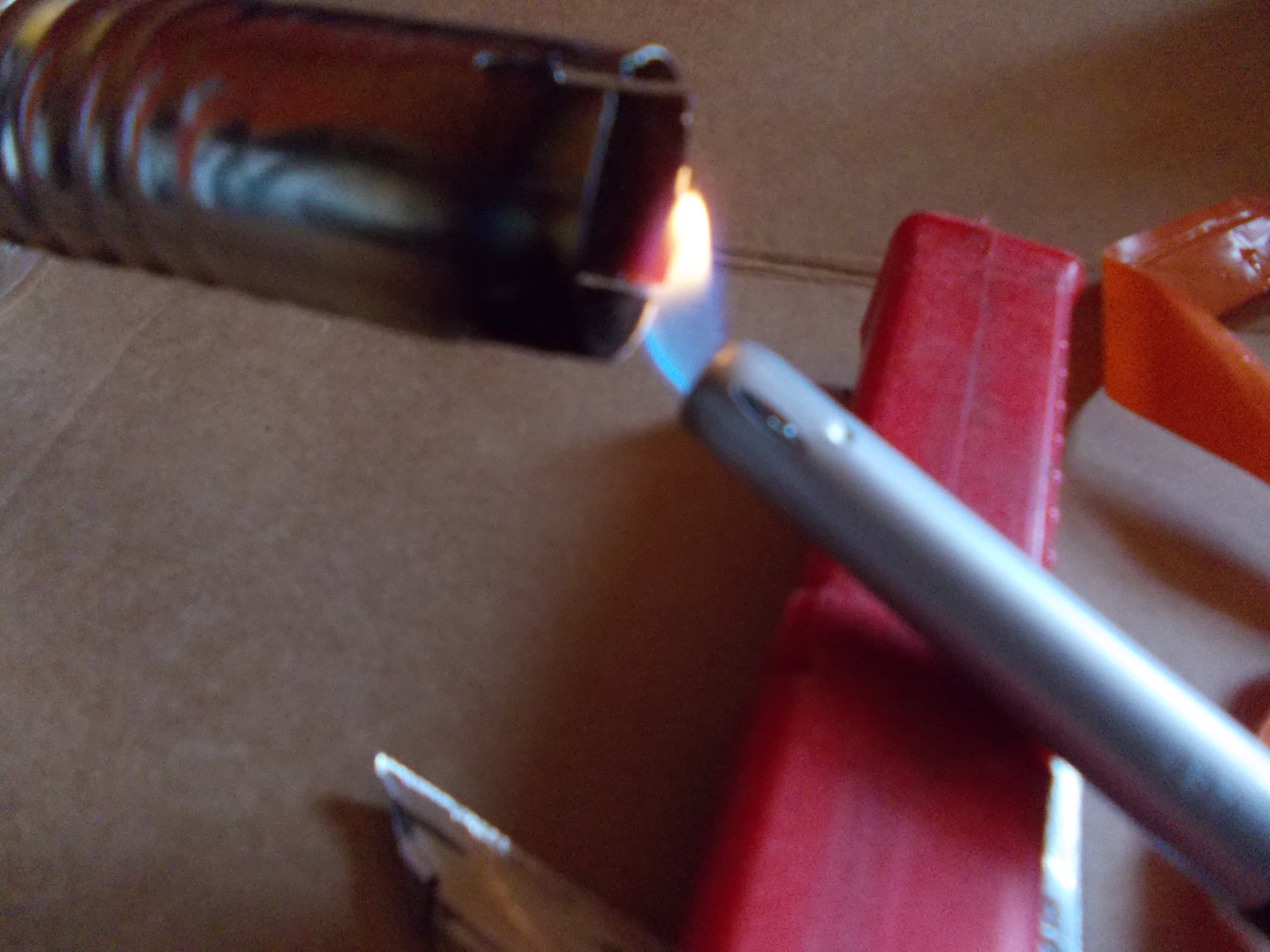

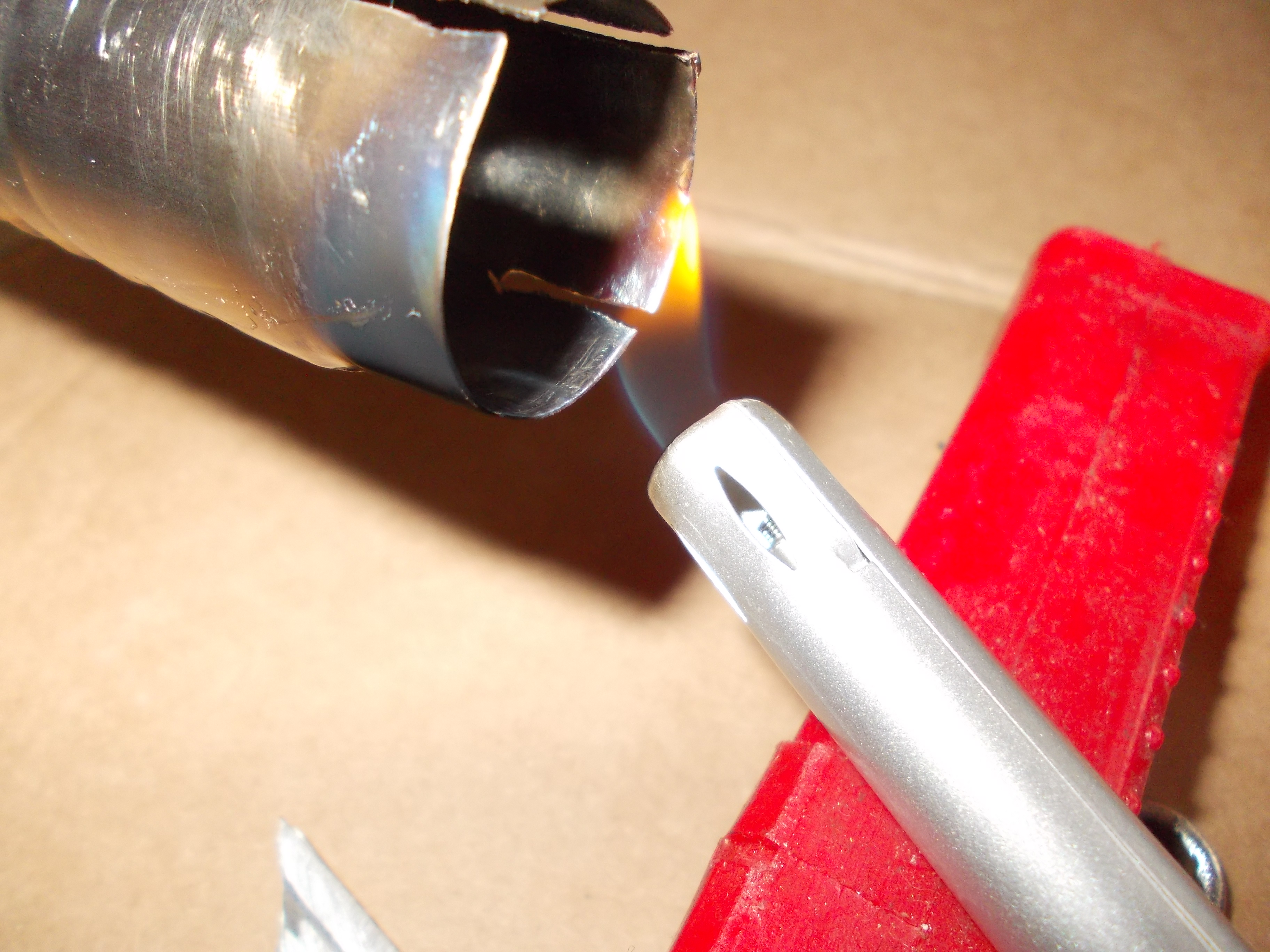

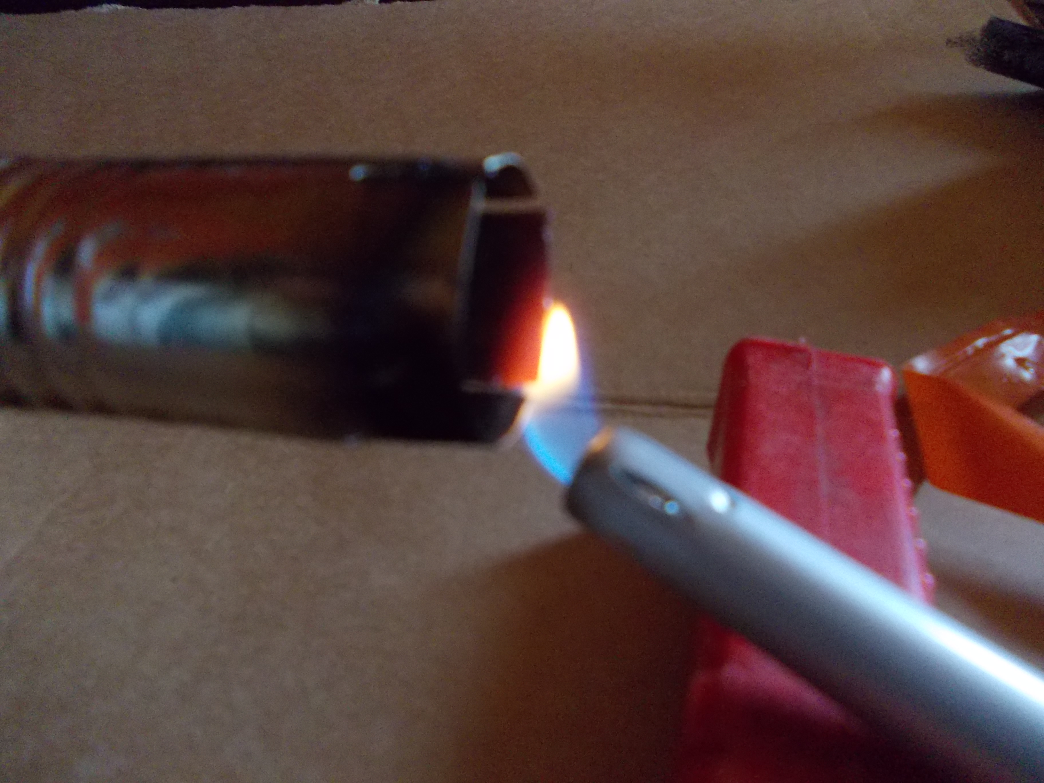

To give you some idea of how thin the exhaust is on a Chinese diesel heater, have a look at the three pictures below:
Start. As you can see a gas lighter for lighting a stove.
Warmed up quite quickly.
Didn't take long. I certainly wouldn't be happy using one of these as an exhaust pipe.
Rae
Be fine as long as it's fitted properly and not in contact with anything...
Or just buy some eberspacher exhaust... For peace of mind.

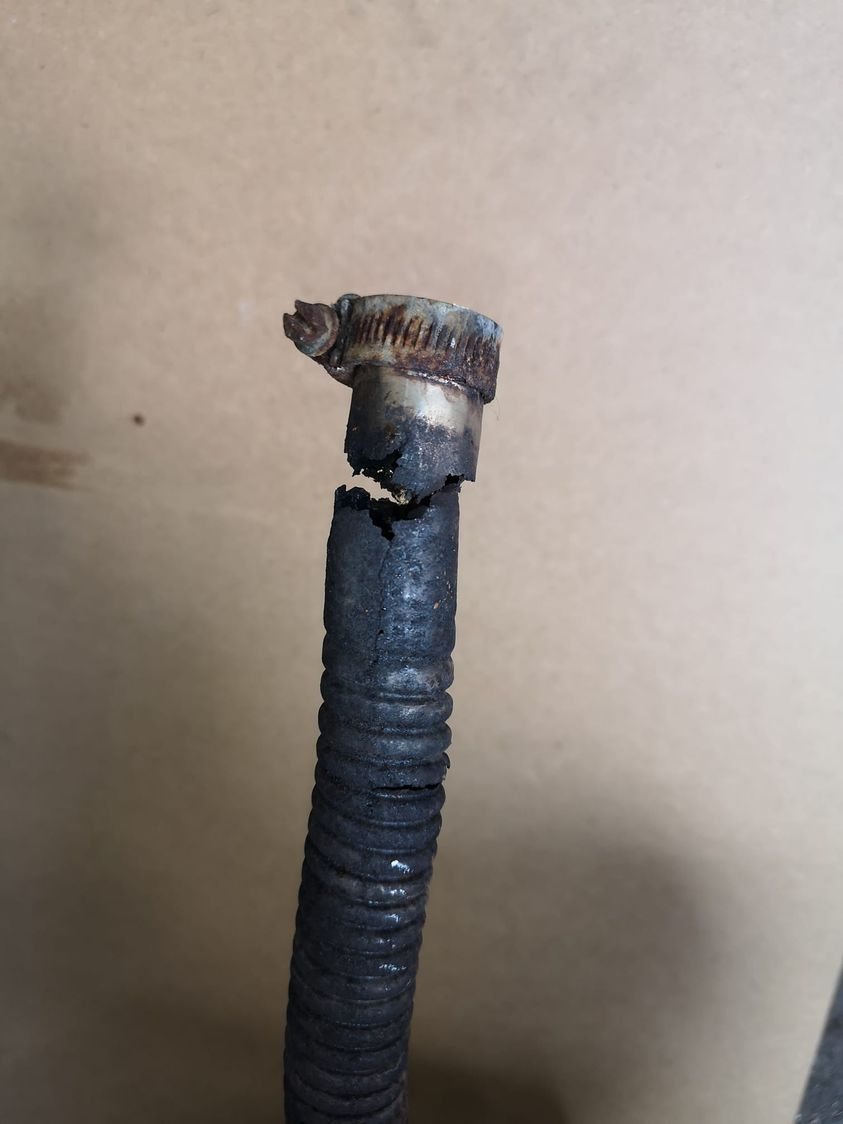

Another photograph I found........ Burned through in under 2 years. Occasional winter use only!
looking at this has made me glad I bought one of these

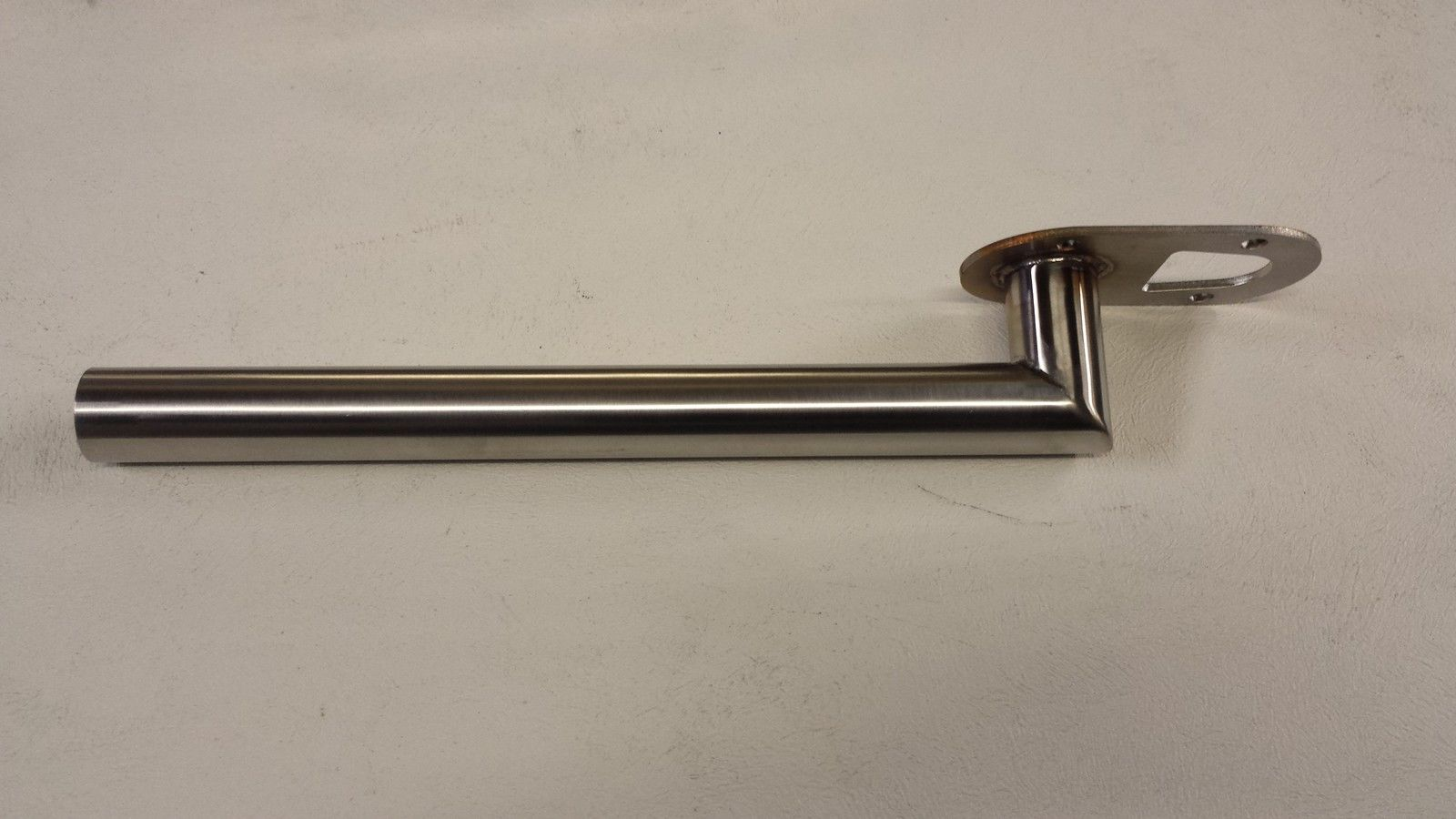

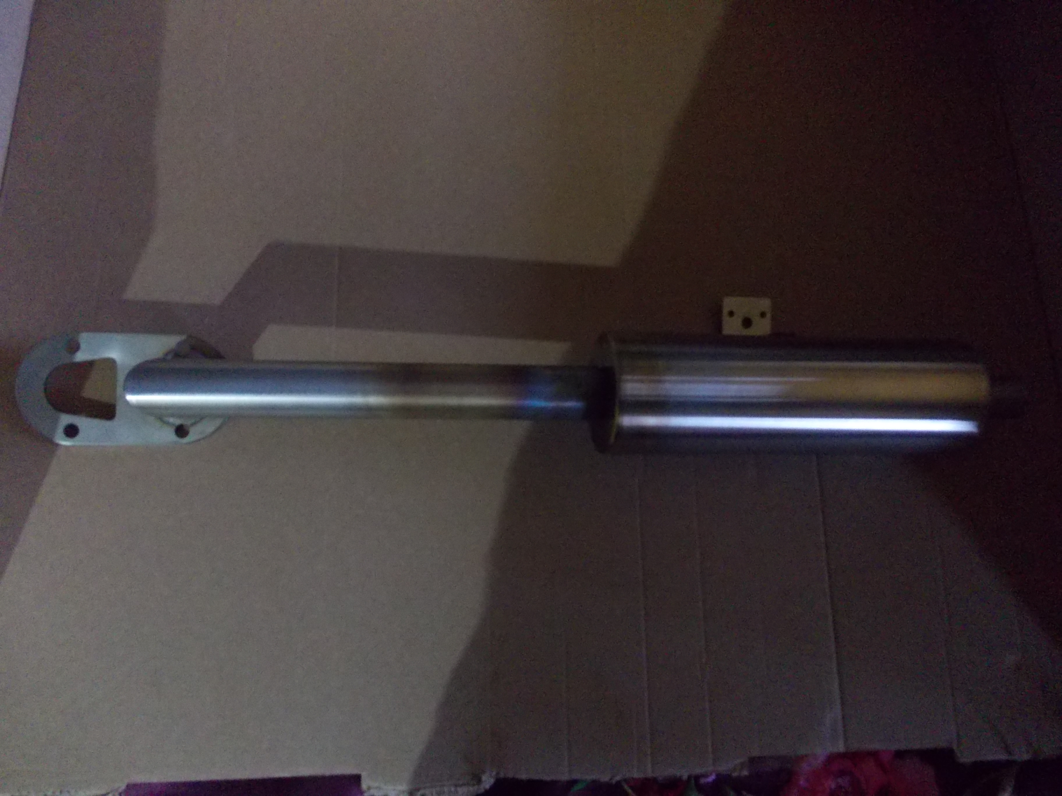

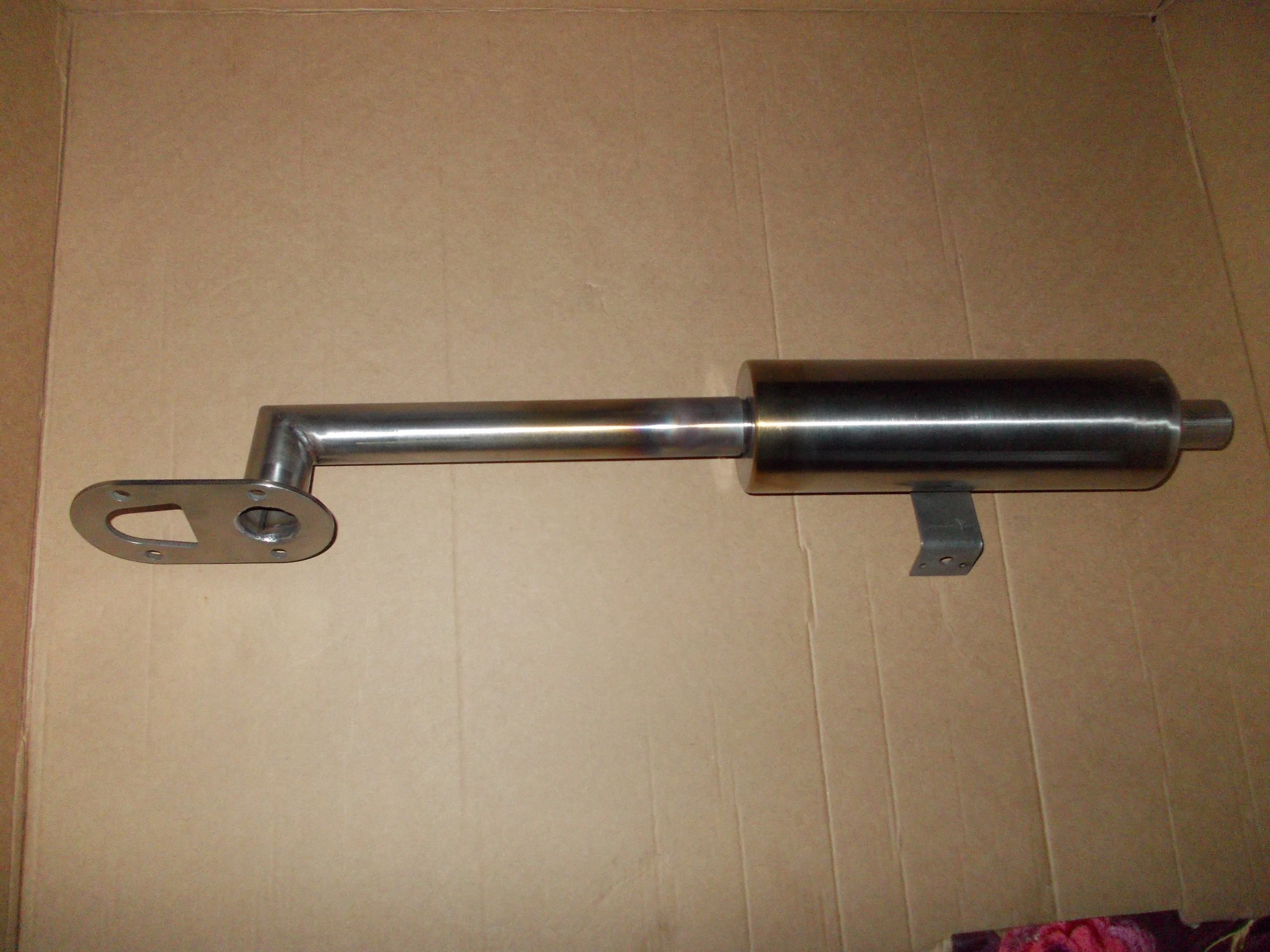

Downpipe arrived today, quite happy with the workmanship, had to warm the end up so it would fit over the end of the silencer.
Had to reheat it as I didn't have the bracket in the right place, warmed it up, one or two taps with a hammer, now it's just ready for fitting.
Still not got the van back. Hopefully we will be seeing the mechanic tomorrow and we'll book it in for an early MOT next week.
