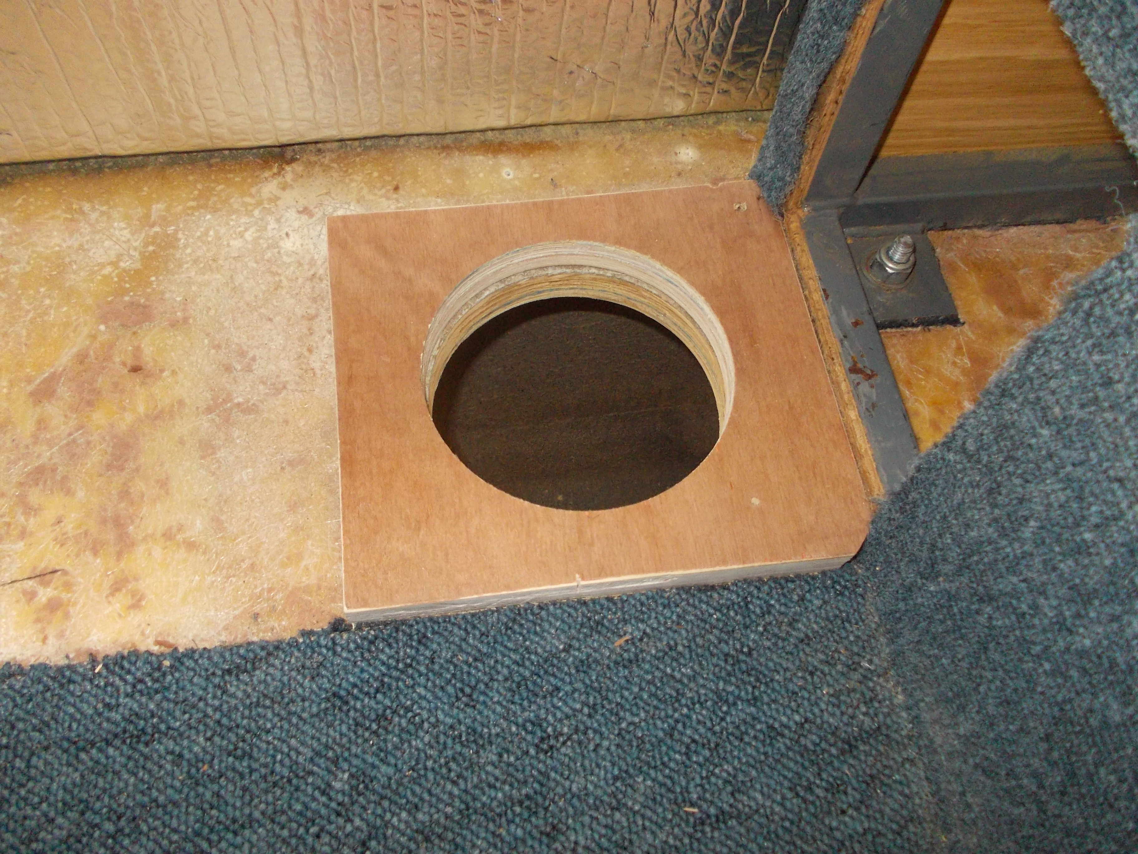

Drilled the hole this morning then I realised the metal seat frame was going to foul the seating of the heater.
Not a problem; out with my new hole cutter and my jig saw and the problem was sorted.

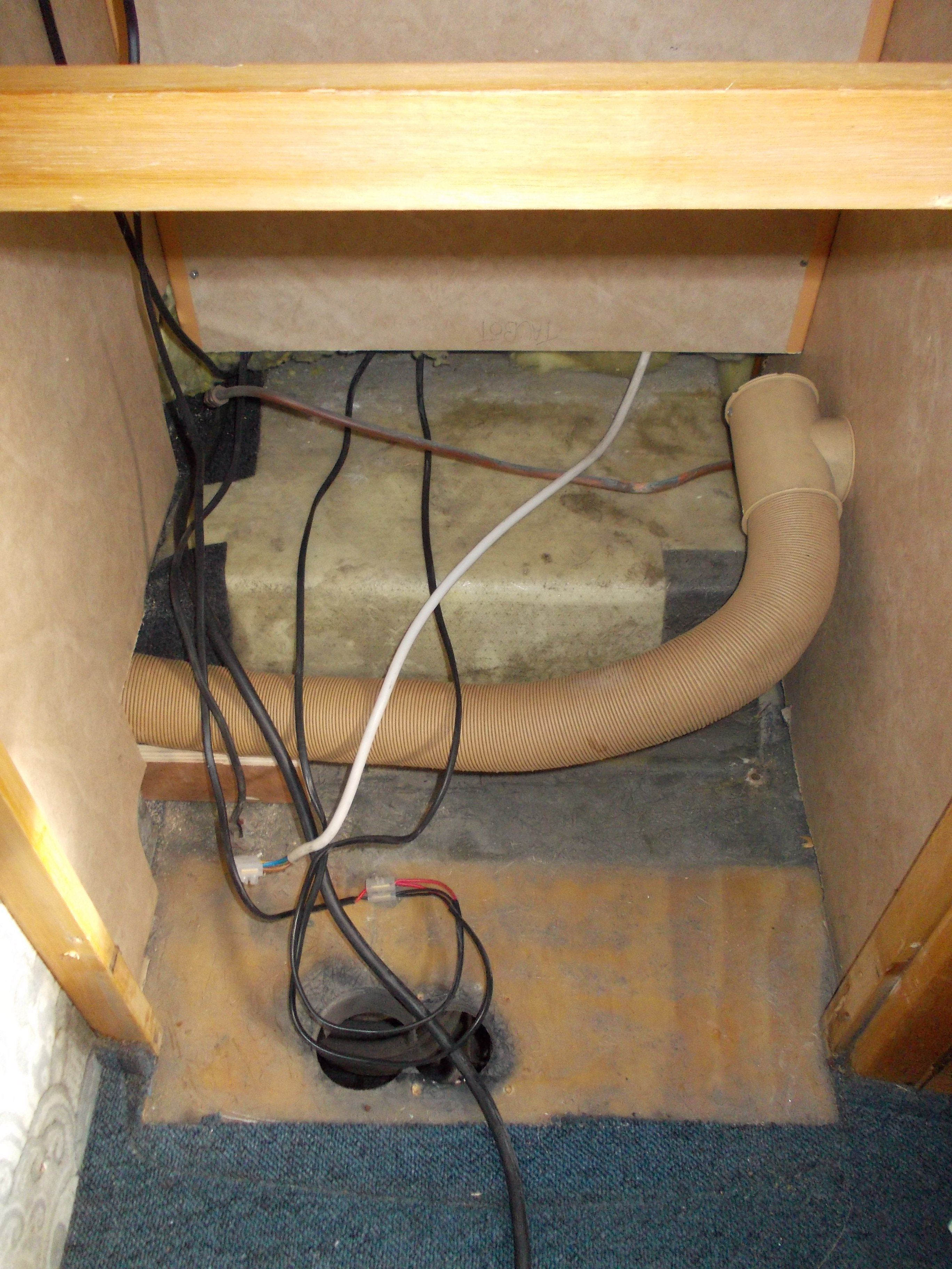

Here we have the heater in situ. I removed all the carpet around the heater as it will be a lot easier to keep clean and I didn't want the heater sitting on a carpet.

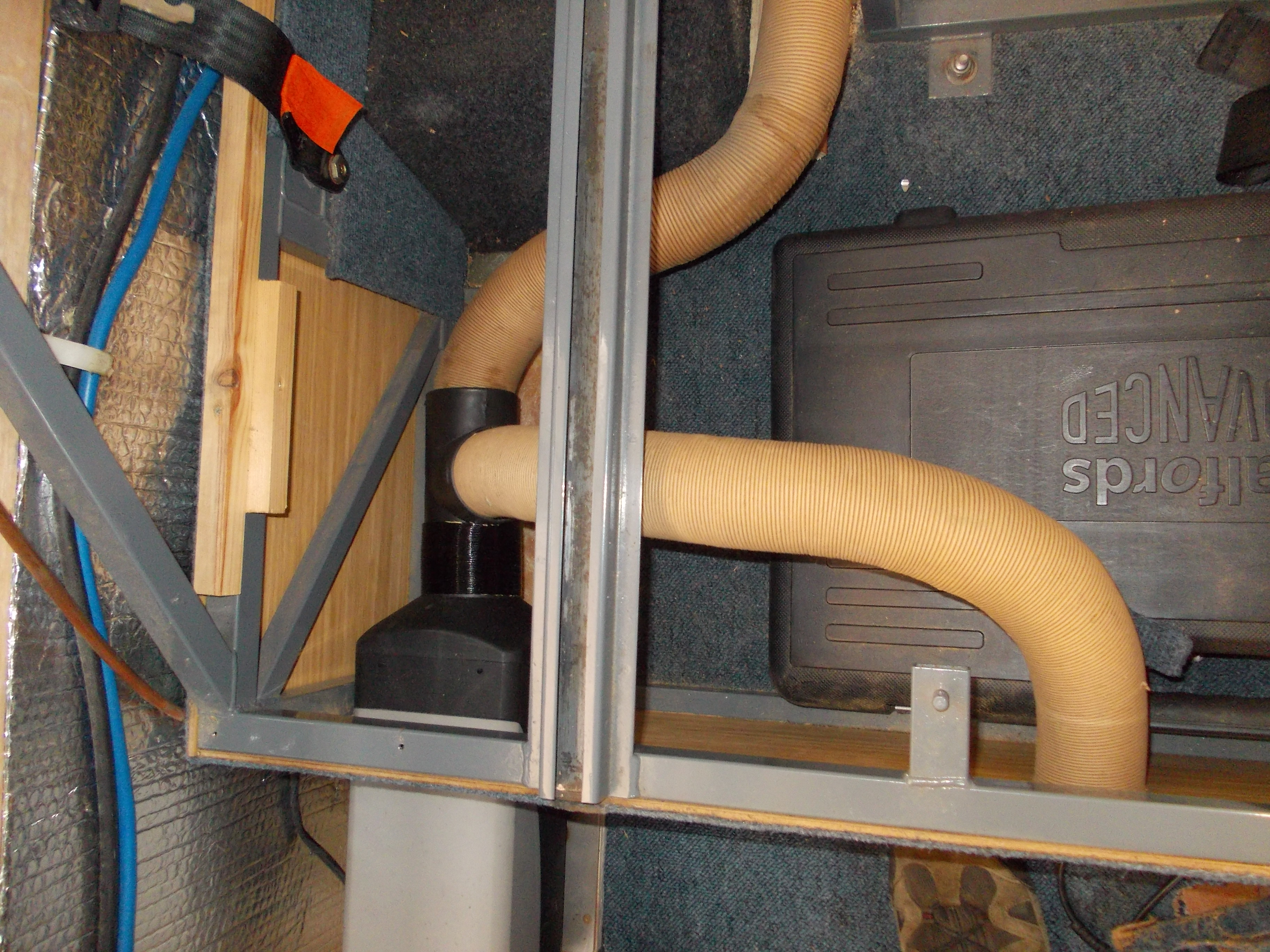

A dry run with the heat ducting. Have managed to use all the existing holes except for the one where the fire was, which I can do at a later date if needed just by putting a T junction in.

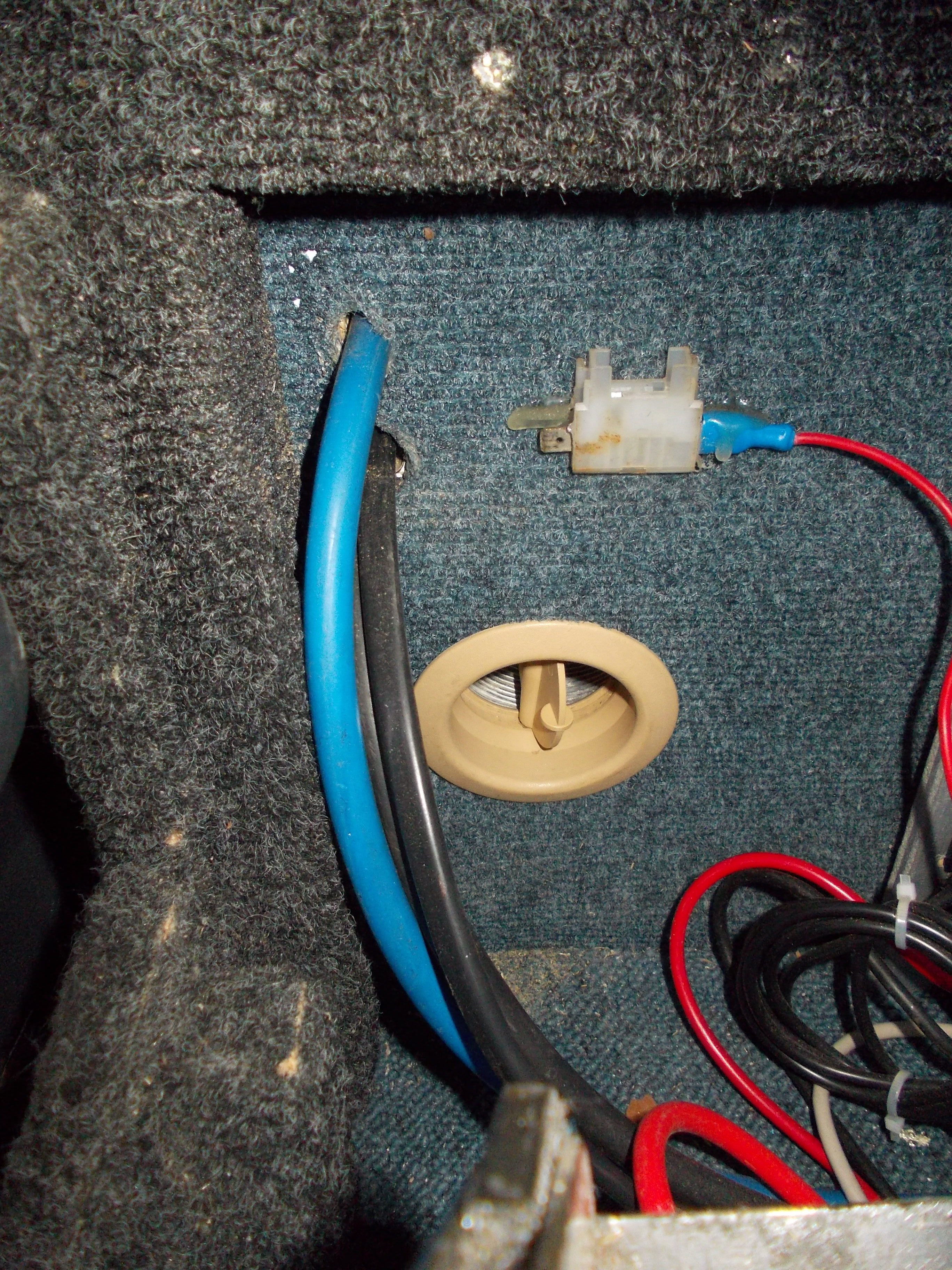

A shot in the cupboard showing how much room we have gained.

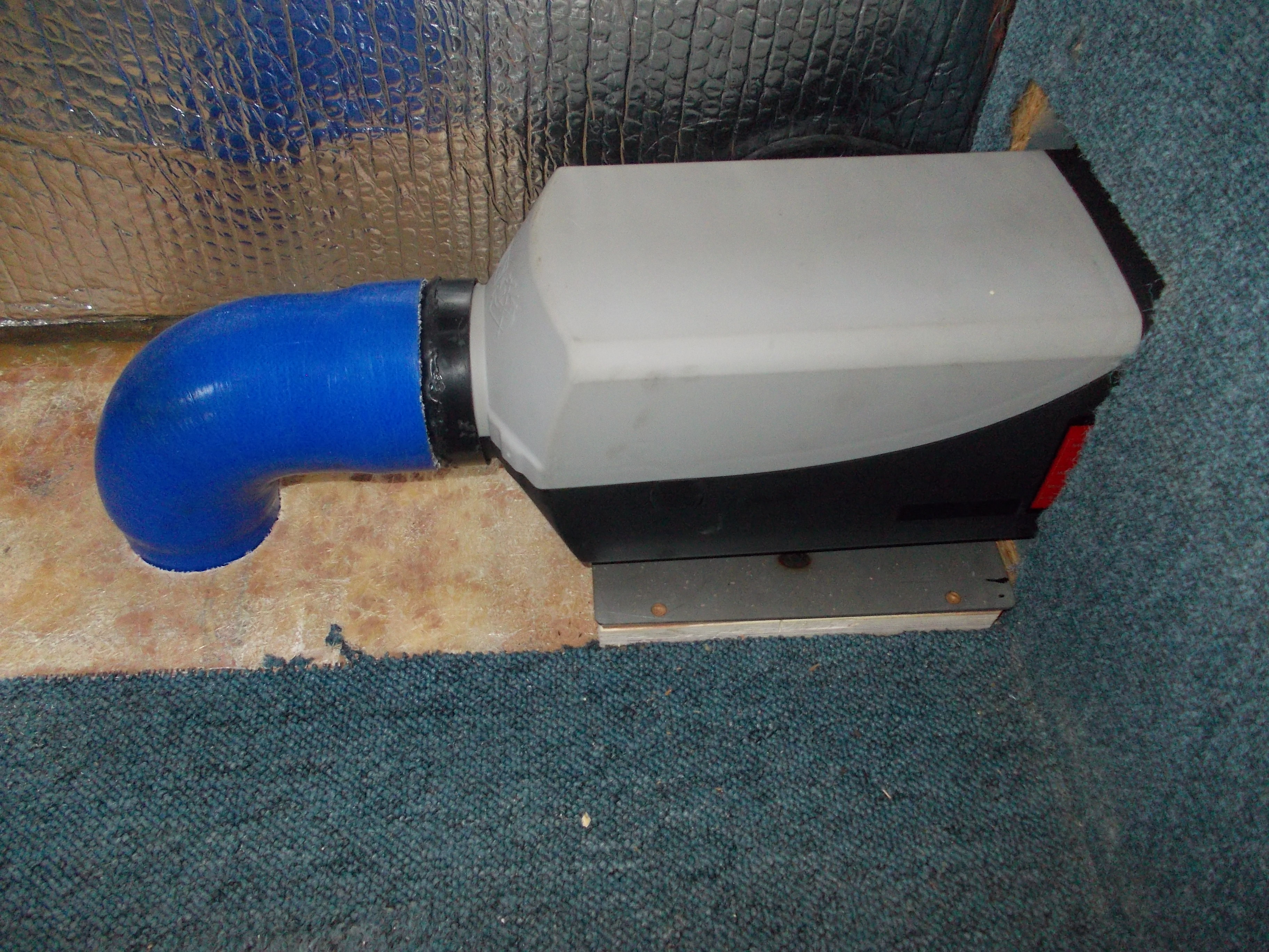

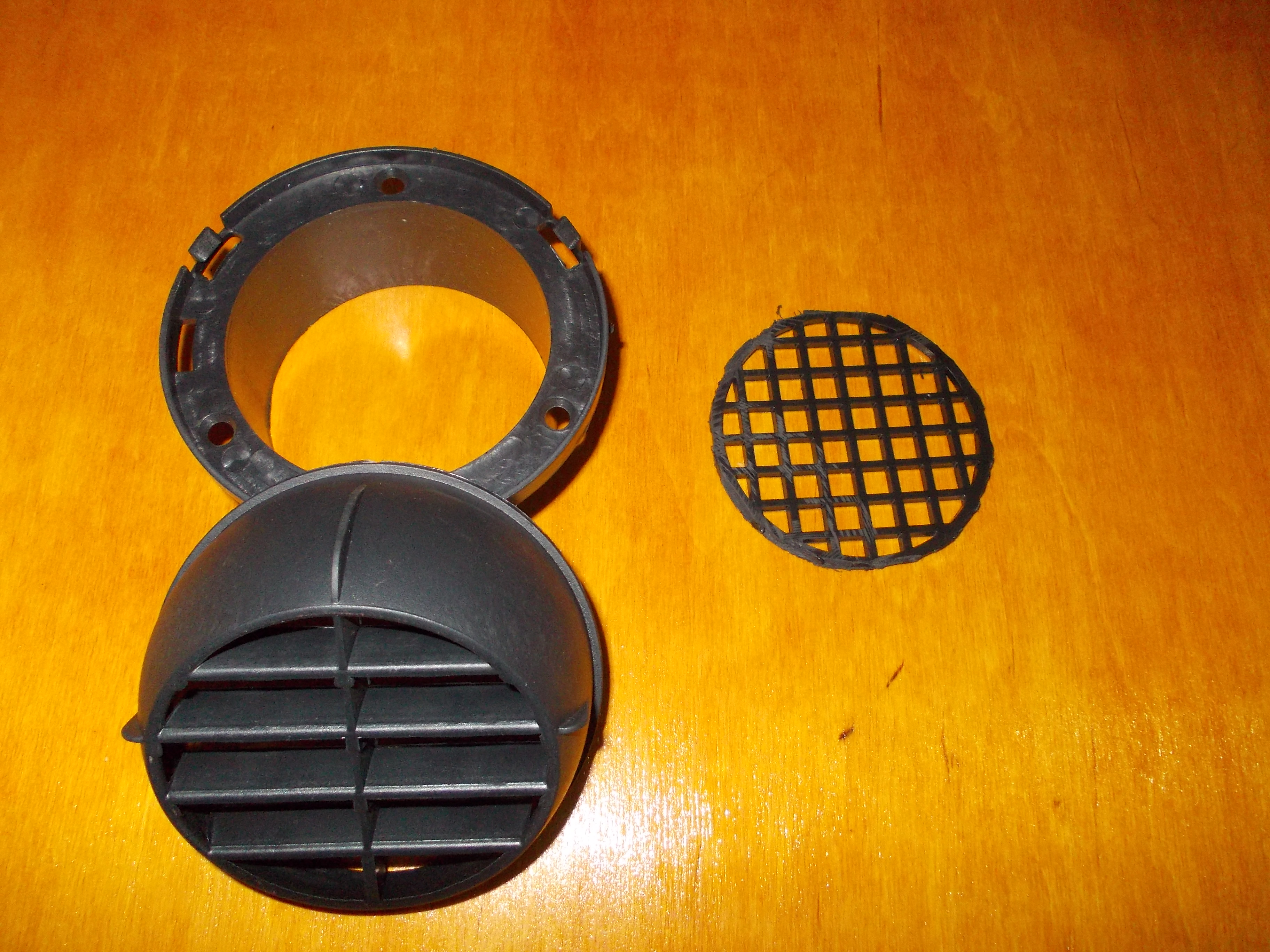

I needed some way to connect the inlet pipe to the diesel heater. I achieved this by cutting the grid off the intake coupling and cutting the ring off the air ducting cap, gluing the two together and then slipping an elbow over the top.
Here we have the finished job. Hole cut in the floor, pipe straight through; may stick a filter on the end of it or, at least, something to stop any large nasties entering.

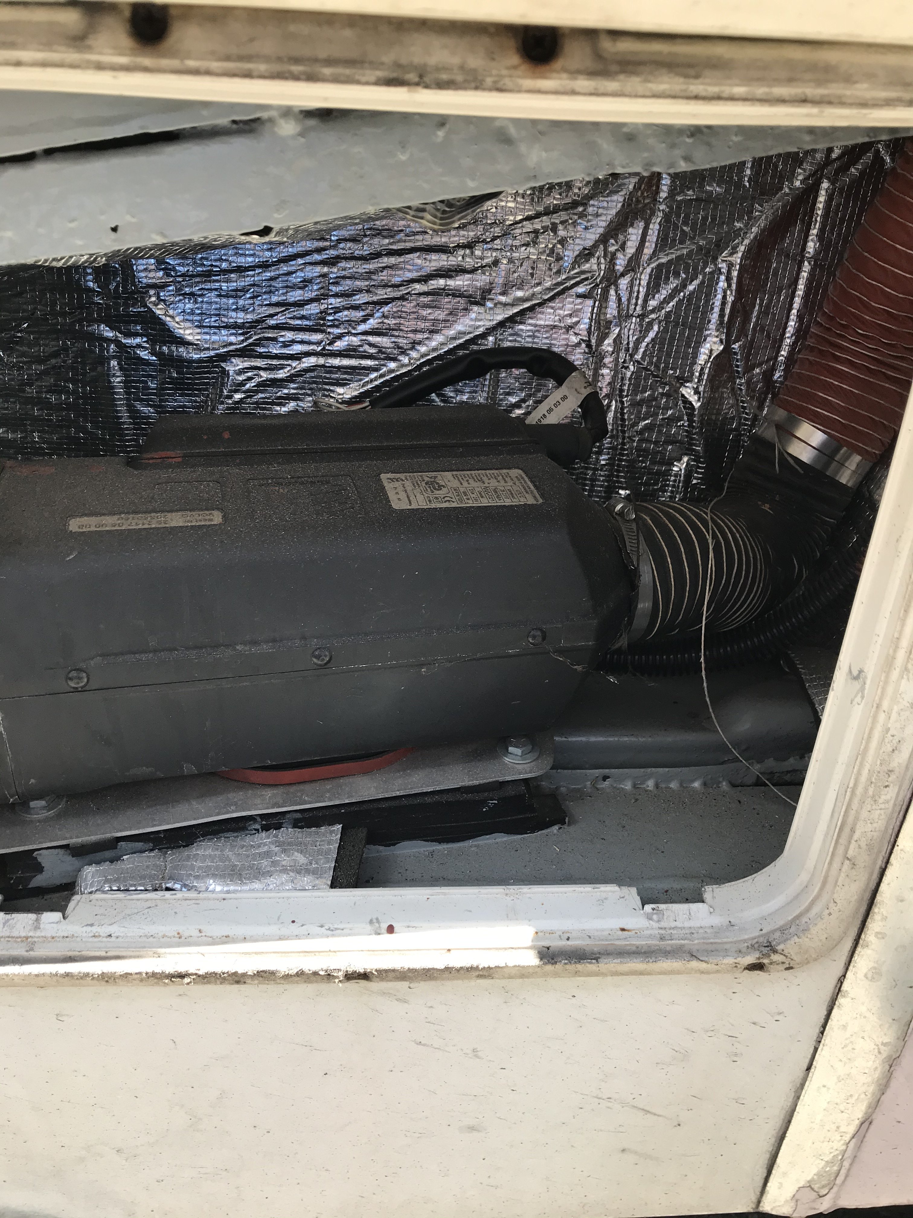

Murky draws it's air just in front of the drivers pedestal. Inside the original coach intake housing is a dry foam air filter. The heater is mounted in the redundant space by what would have been the driver step. It had air heating before I purchased it, but it had been removed. The air filter needs washing a couple of times a year. I'm shocked at how much dirt is in the air :( I wouldn't even have the heater in the living space with me.

That's only dirt that's in the, air already....
You want to see the aircon unit filters I have to deal with (they recirc air too)
Even external fed DX coils run filters to filter the external air.
To be honest on the transit (eber is under front passenger seat drawing air from cab)
I just blow the heater out with the airline once a year....
A filter you can clean is a fair idea (just to keep the internals fluff free)
BUT take care not to restrict the flow.

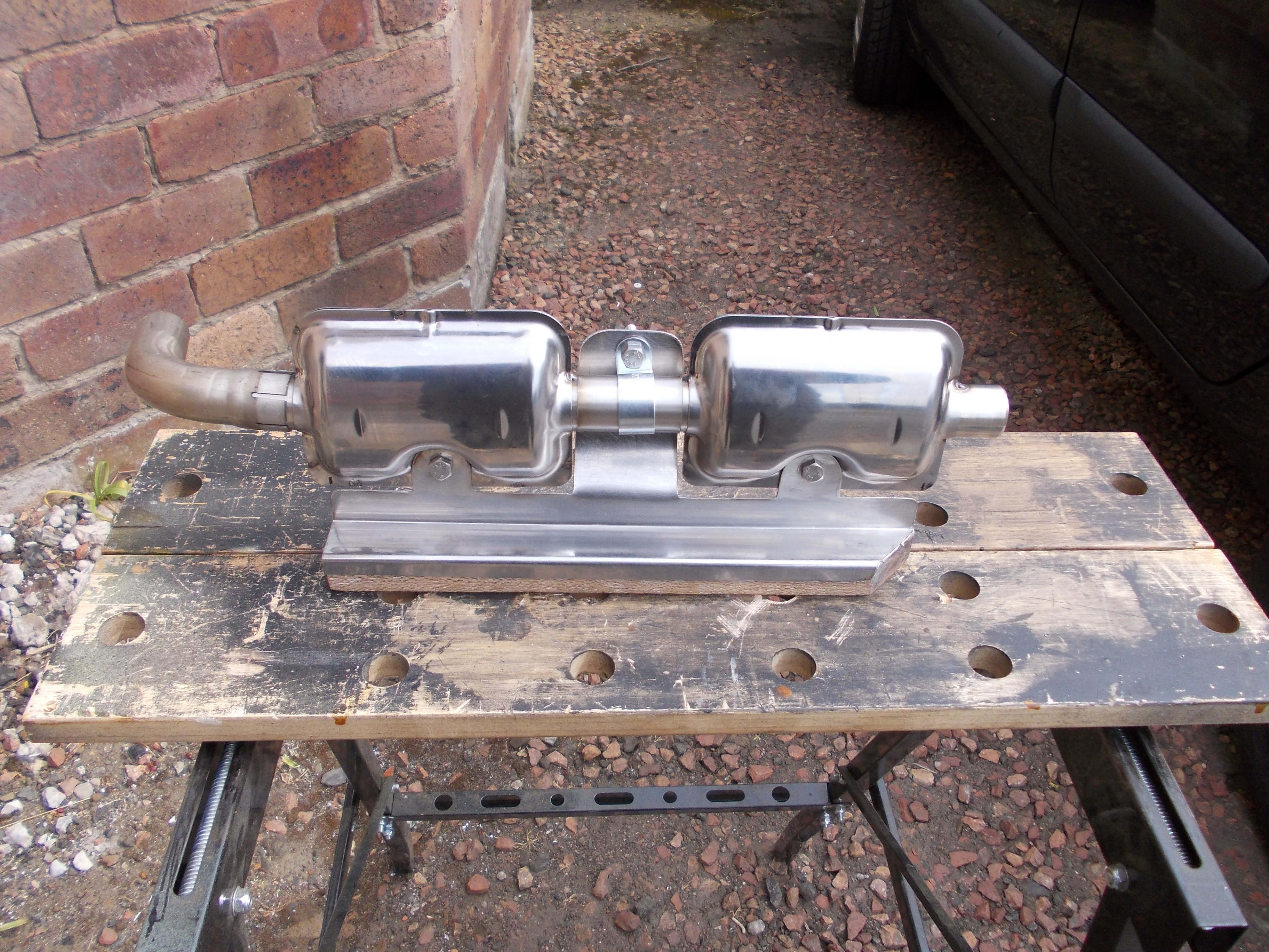

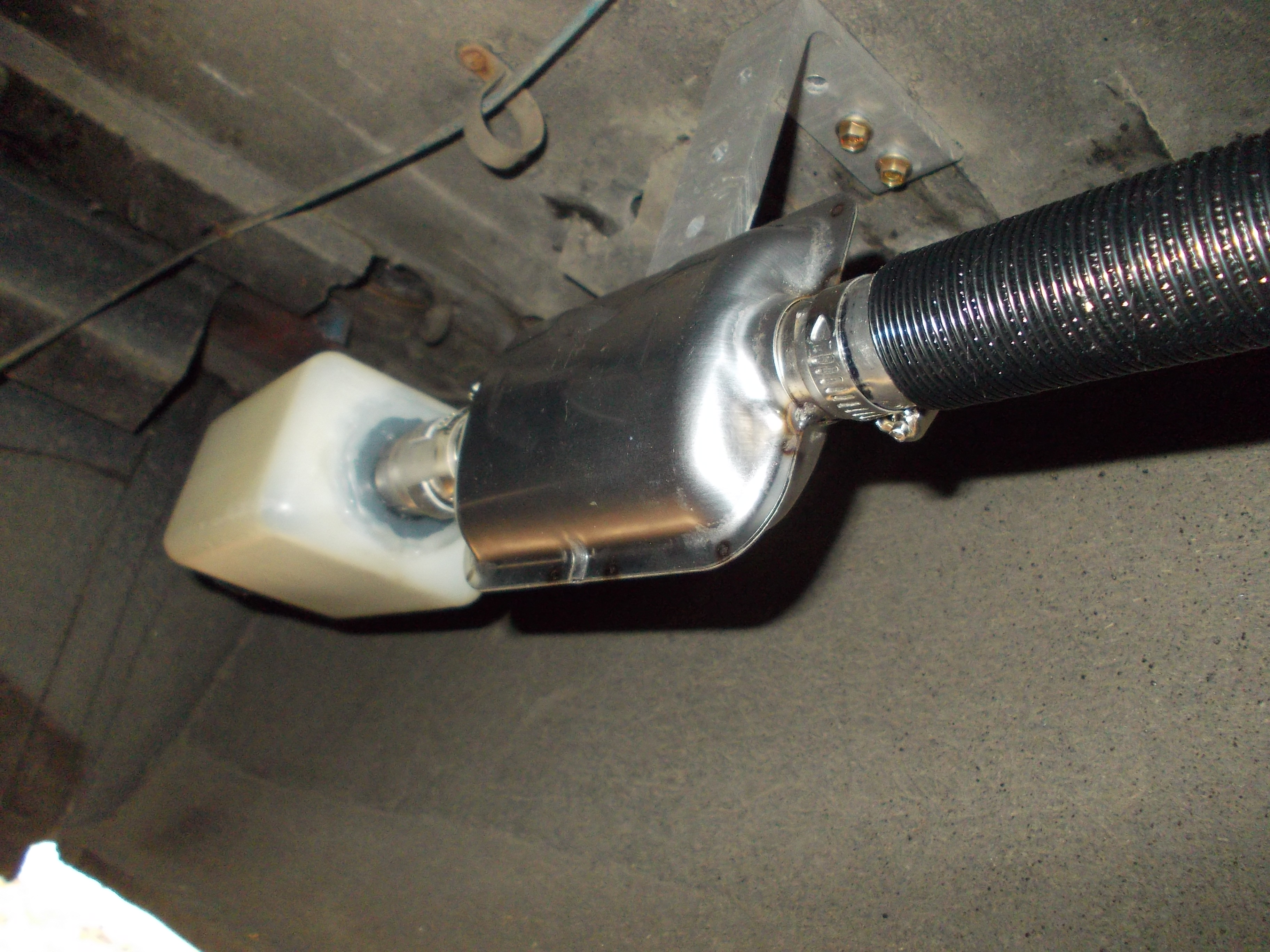

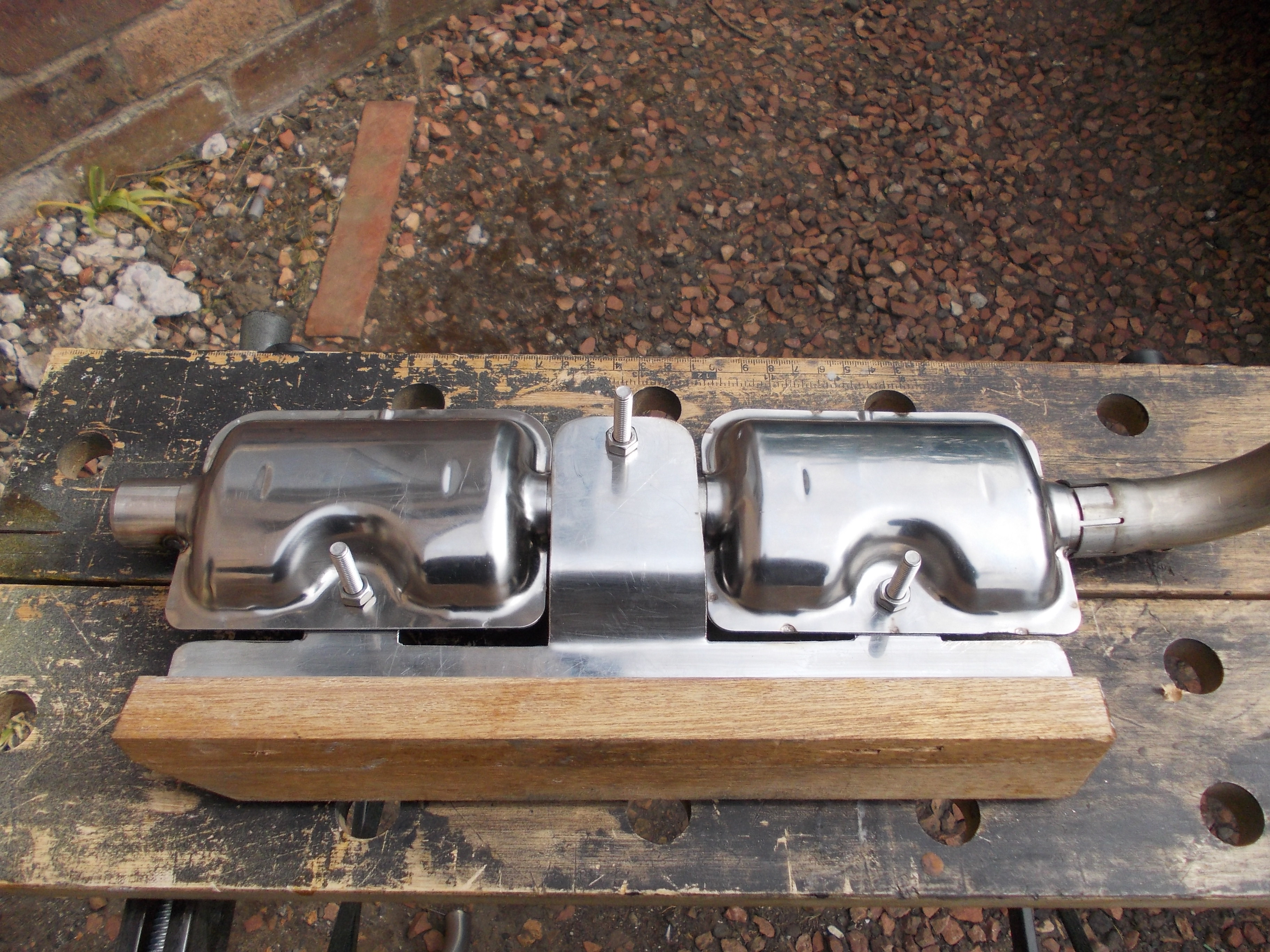

Still plodding on despite the odd setback, this afternoon was all about getting the intake on the exhaust; put together if only as a dry run. My first job, make up a decent bracket that would hold the two silencers.
I think that should do the job. All that's needed is bolts cut to the correct length, dab of Locktite then screwed to the floor and that should be that.
The inlet was a lot simpler; one substantial L shaped bracket screwed to the floor.
Once the mastic has dried on the exhaust bracket I shall then drill through it and screw it to the floor. The little extension pipe on the end comes out in the wheel arch.

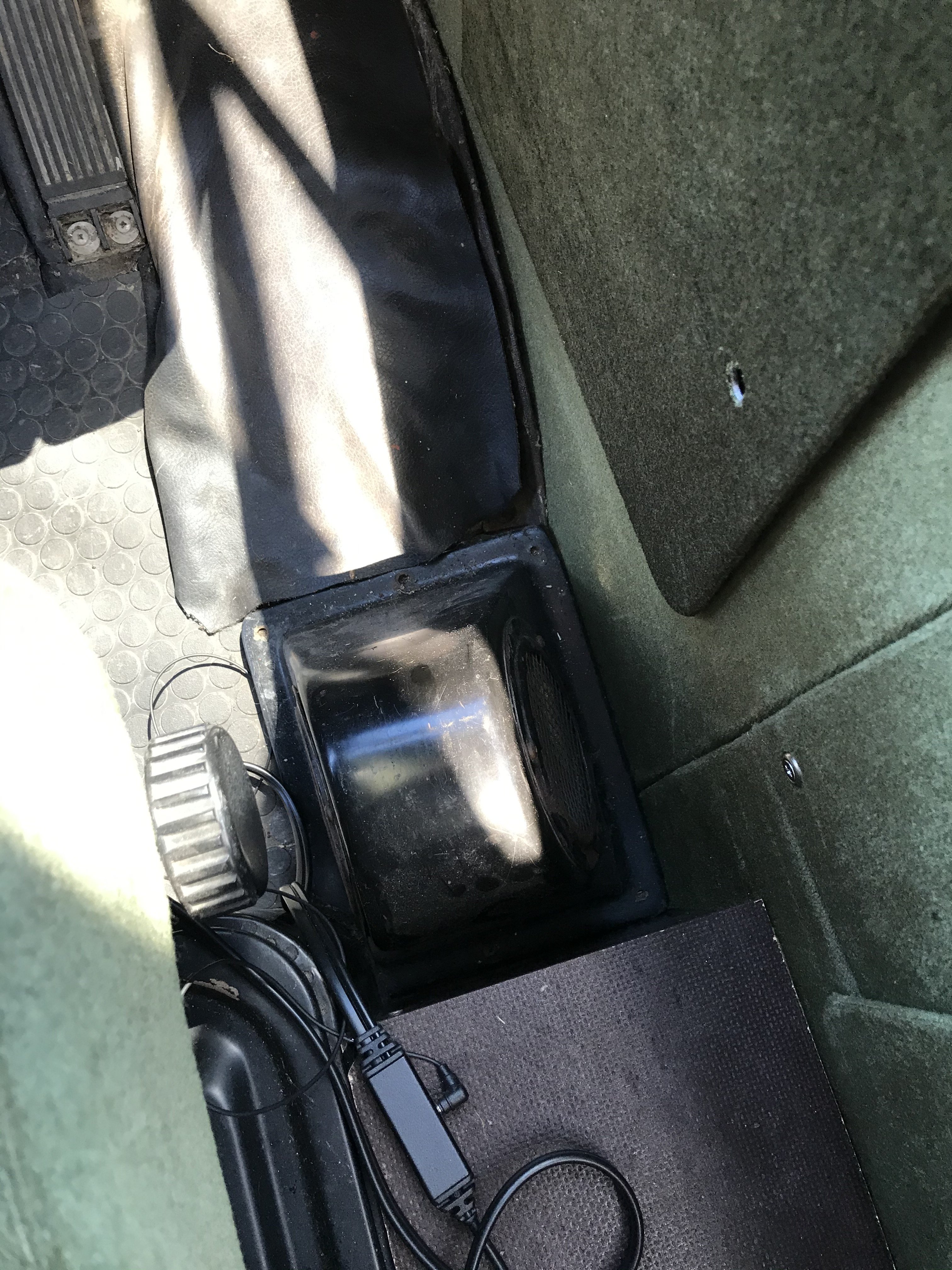

Decided it was time to reroute the air intake but where to put it? I decided it was best to clean up and see where was available. I have to confess I did like the door well but this would have meant removing my chassis number, or certainly a large part of it, so I've opted for the area behind the driver's seat in between the seat and the door frame. This will be the easiest and the least space used.
But before all that can start I have eight holes to fill in and only one was mine.

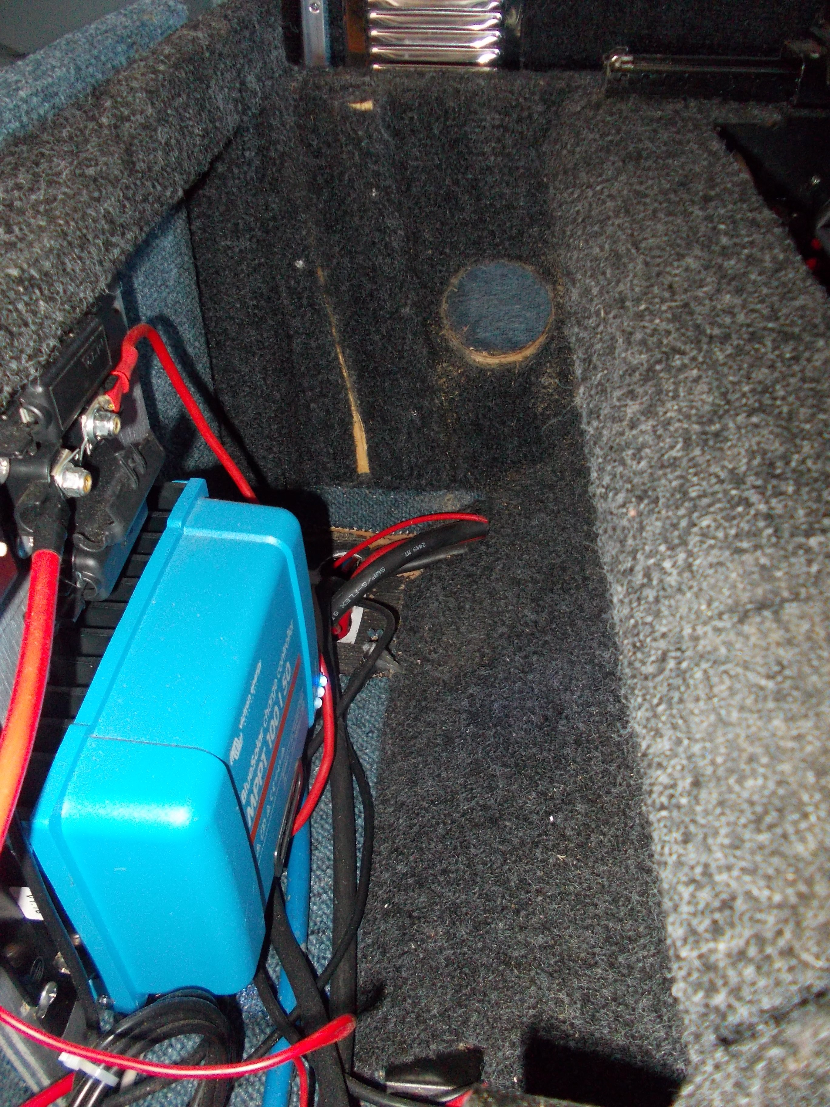

Remedial work started today. First job, make top hats for all the holes that are in the floor; including the one that I made myself. Two of the holes were where a water tank had been removed and the others were gas pipe and vents.
Re-routed the inlet pipe; now inside, tucked nicely away behind the front seat.
Decided to come inboard slightly so I could use the channel between the driver's seat and the living area to draw the air from the centre of the van between the seats.
Cut another hole on the other side of the driver's seat so the air could be pulled through. Hopefully, this should circulate the air.

I can’t swear to it but looking at the pics of Raes inlet and outlet silencers they are the same as I fitted. Think I paid just under a tenner For both with extra pipe and fittings.
The original ‘professionally’ fitted eberspacher had no silencers.
When I fitted the exhaust silencer it was as Dave says noticeably quiet but it needed the plastic inlet silencer to get rid of that turbine whine.
I thought the design of the Chinese silencer was quite good, maybe not up to Yamaha race design department but the expansion chamber and muffler material ticked the right boxes.
If I was going to try and change/improve the design I would fit a tube straight through with loads of holes drilled in it, blank off the end and have a second tube for exit. It would need to be able to come apart during design so you get the right amount of holes (what we used to call exhaust tuning ha ha).
