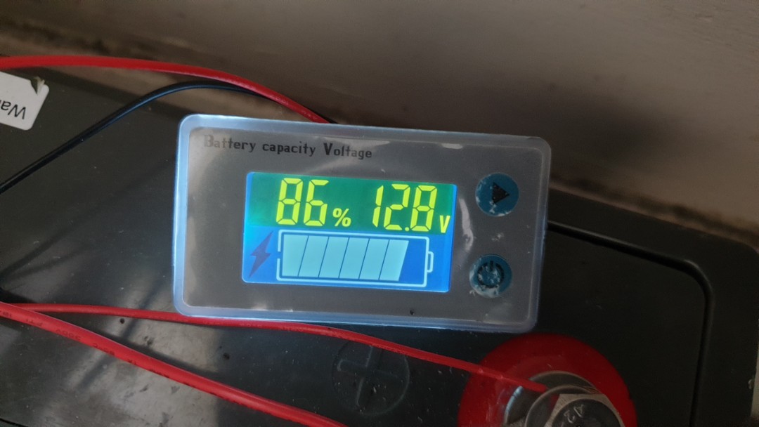

    Good Morning Clive :-) Hope you are well Robert here in what was Flooded again Hebden Bridge (maybe wetter than the IoM !!) I have created this post about a cheap battery monitor I purchased on BangGood, I wonder if you could test it at some point. Product details are in the post motorhomebuilder.com/threads/cheap-little-battery-monitor-but-how-good-is-it.66896 Many thanks Robert

    Hi Robert. I think I've got a similar device for solar power batteries. It uses a simple voltage range.

    Hi Clive, any previous YT video's of you disassembling it and tearing down. If you read the thread on Motorhome Builder that i started then you can see that it is a bit of a mystery as to how the device can determine 12V battery capacity especially when there are multiple capacities and types in the 12V arena. So it is it actually being clever and have some sort of intelligent circuitry in it or is it just a simple voltmeter as David (wildebus) states and you also said above, so really the capacity the device shows is inaccurate? David is an electrician and similar age to us I think. Hope all is well with you Robert

    I think the capacity thing is just giving an indication of the remaining charge capacity based on a simple voltage level indicating the percentage left. You'd have to gauge it based on the stated battery size and allow for loss of capacity with time.

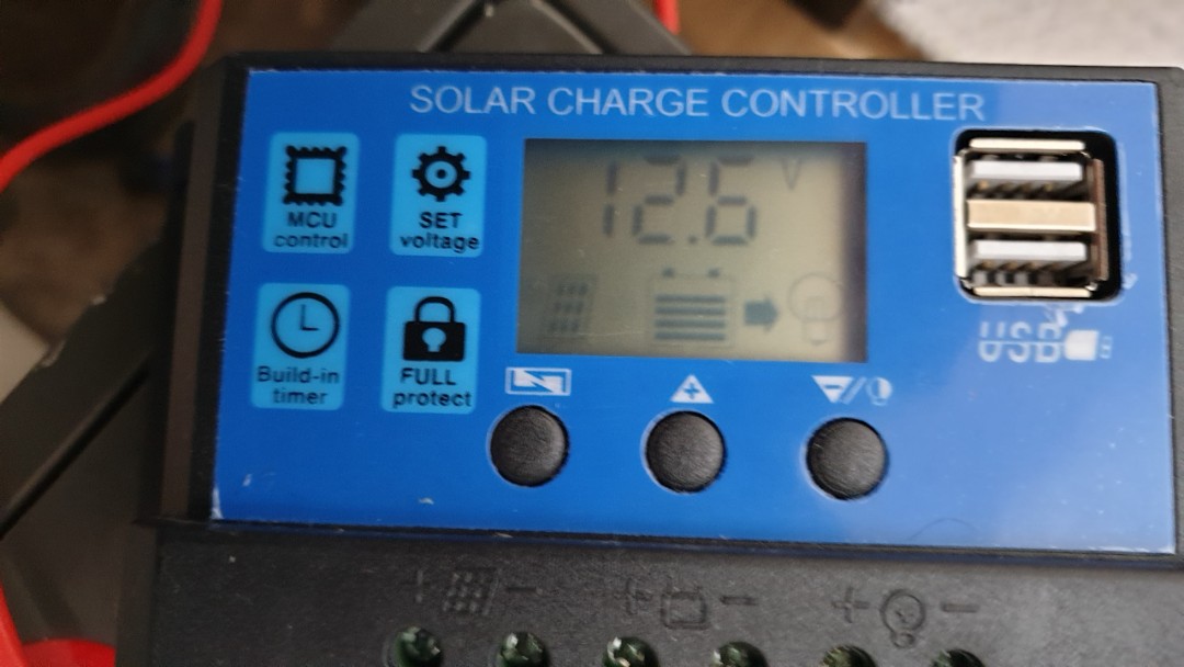

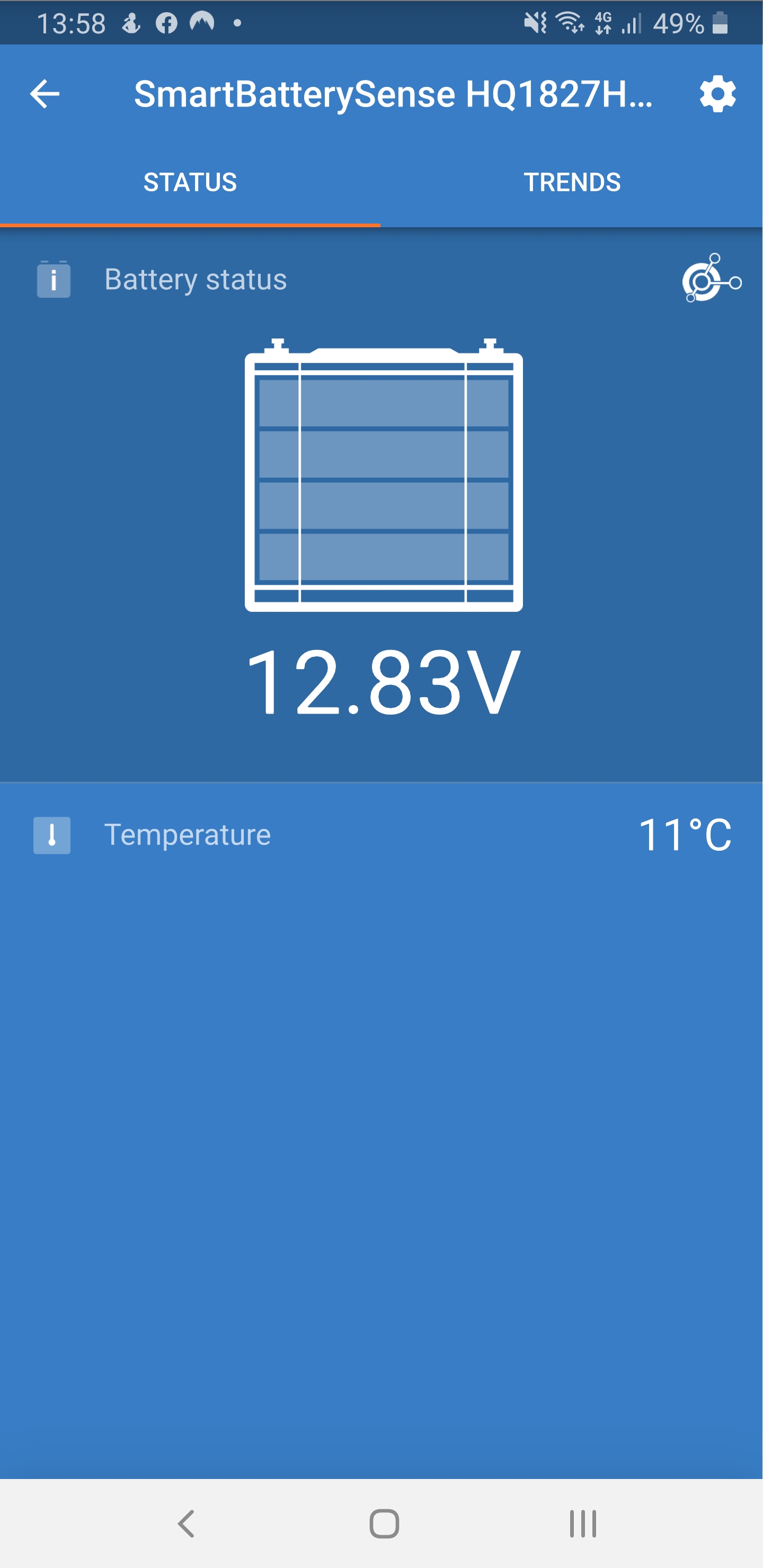

So back to this thread on the Battery Monitor, I have created this thread on a cheap 50W Semi Flexible Solar Panel I am testing
Whilst testing I looked at Voltage on three devices, the Victron Battery Monitor directly connected, the cheap Battery Monitor and the pretty awful PWM controller delivered with the panel, for more on PWM vs MPPT then look at @wildebus Post testing those devices here:
This is the result of looking at Voltage
As you can see both the Victron and the Cheap Battery monitor are seeing the battery as having 12.8Volt whereas the Cheap PWM that was delivered with the Solar panel is showing a 0.2V drop.
Pretty sure this Solar Controller is working but very poorly. Anyway it's no real bother as I consider it a throw in with the price I paid for the 50Watt Panel.

Voltmeters are a tricky thing. 0.2V reading difference at 12.8V is actually under a 2% variance which is very small in reality but with a 12V leisure system, we are only interested in such a small range of numbers, we need a quality calibrated device to give an accurate figure (so 2% variance needs to be more like 0.2%!)
