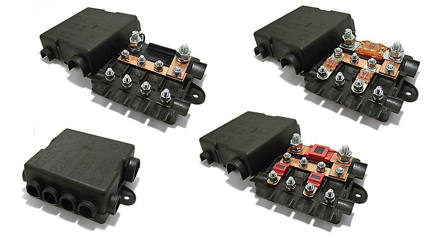

You have seen the Victron Lynx Distributor Boxes which are an excellent way to connect multiple batteries. However they are expensive there is no doubt, but they have high capacity busbars which is essential if using high current loads (for example, like the AC loads I have).
You have a different type of use and for YOUR setup I would use one of the fuseboxes that SquirrelCook posted a picture off (copying below)

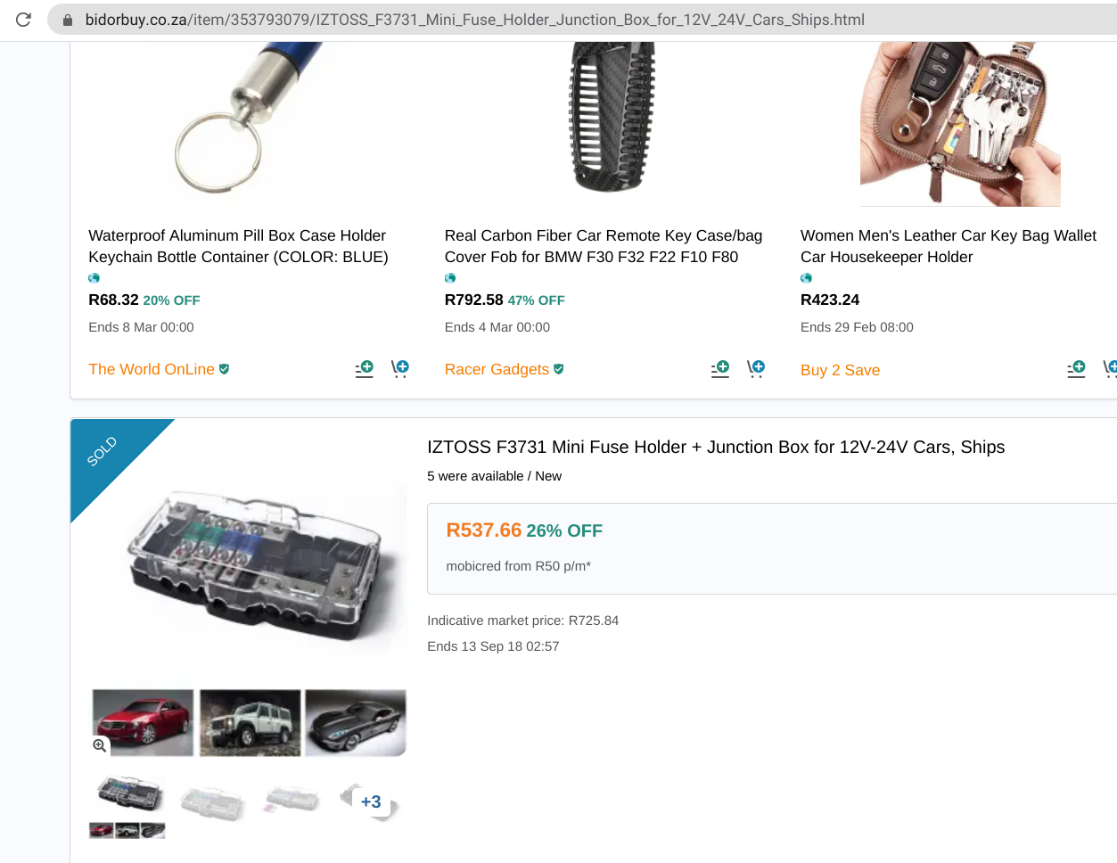

I did a reverse image search on the image above @wildebus and only found it after retrieving the name on Auction sites in South Africa.
The name I came up with was ITZFOSS F371
I can't find one so far on Banggood or EBay or Amazon, any ideas @SquirrellCook ??
On the Talbot I bought one of these which is not the same
That is listed on EBAY as www.ebay.co.uk/itm/112591659554

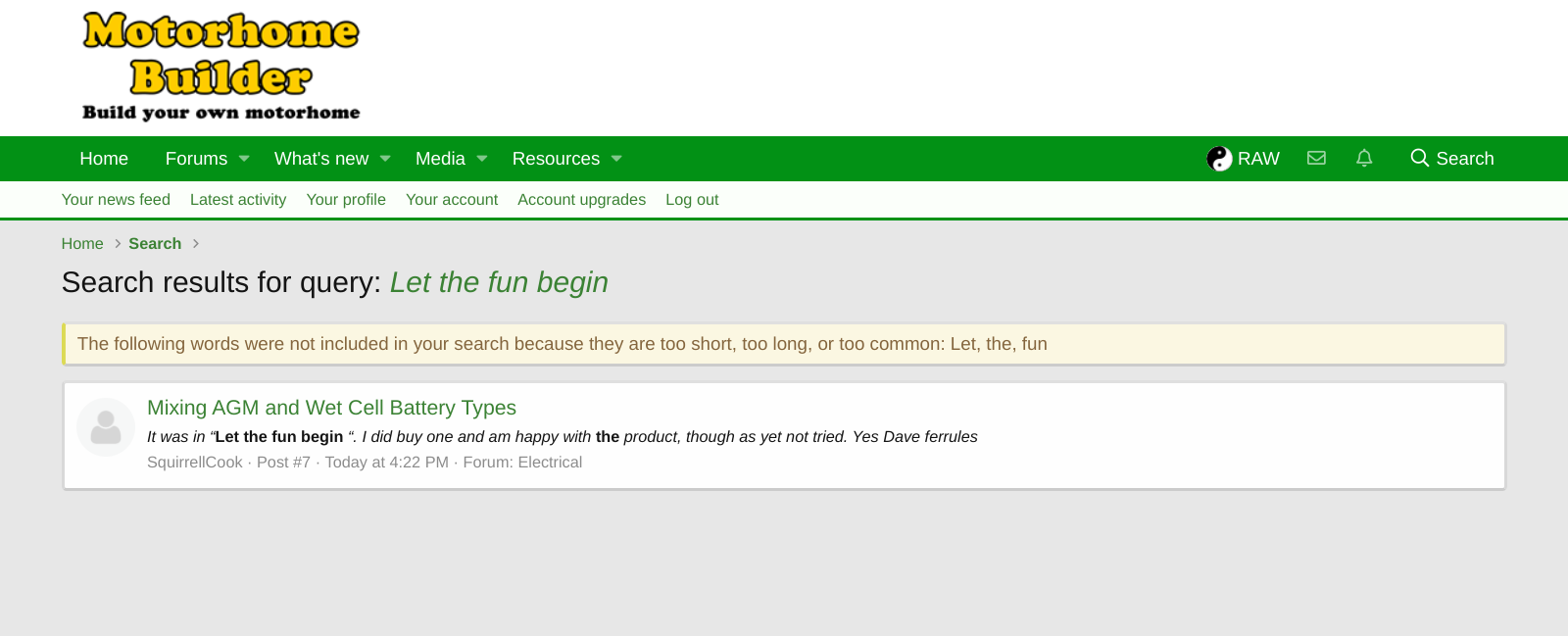

It was in “Let the fun begin “.
I did buy one and am happy with the product, though as yet not tried. Yes Dave ferrules

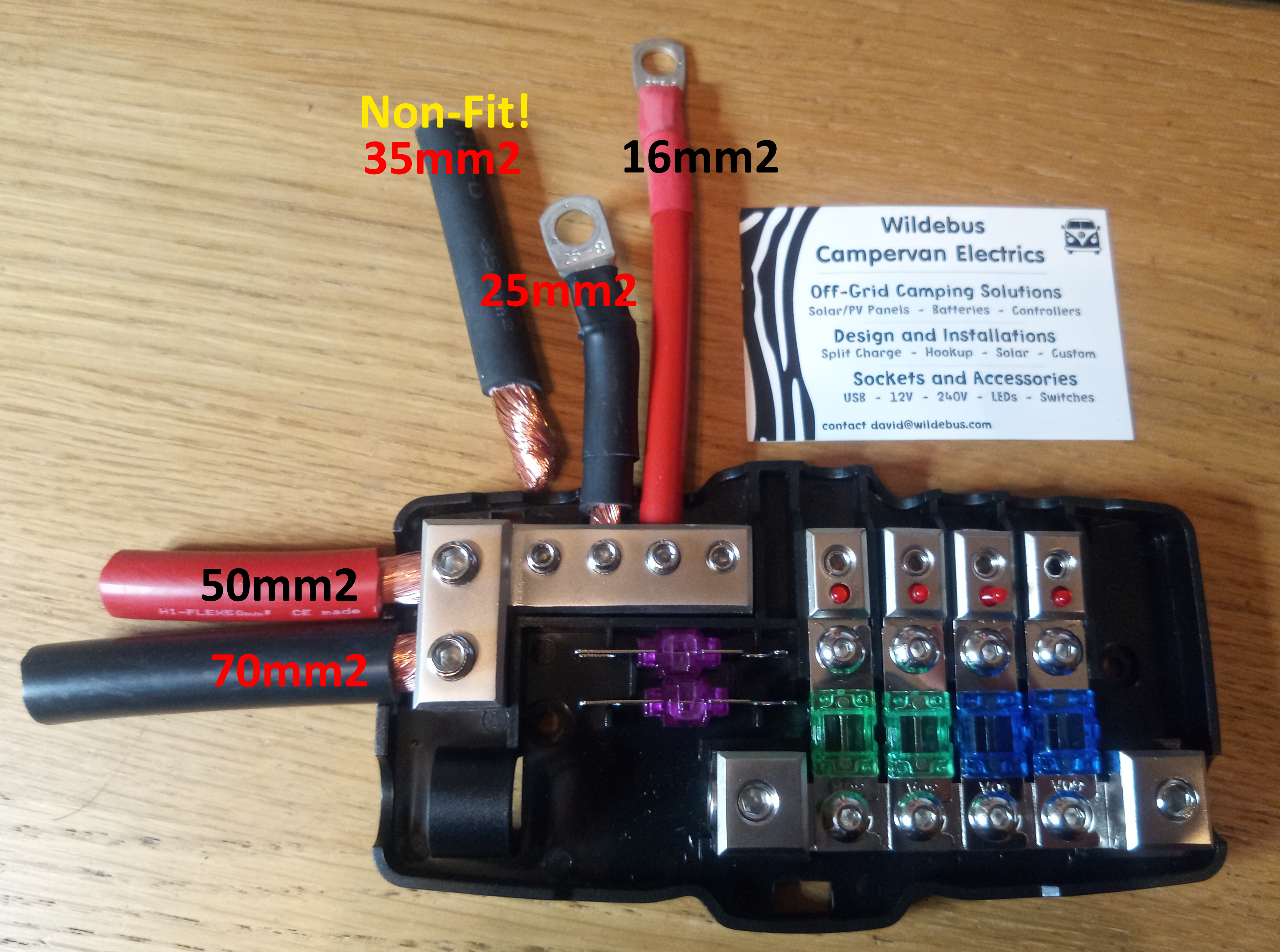

Going back to that fusebox, I just did some testing on what battery cables it will suppor on the main busbars in/out, and the individual fused circuits and it is a bit better than I expected and I think it WOULD suit your setup with a 1500W Inverter (not the 3000W one though).
Here is a photo of one of those Fuseboxes with a few cables test fitted ...
For the individual circuits (These are at the top and bottom), 16mm2 and 25mm2 cable work fine. 35mm2 cable is too large to reliably fit without 'birdcaging'.
For the main in/out connections (these are at the left and right), 50mm2 is a good fit. 70mm2 will fit but is tight.
For YOUR setup, I would ideally use 25mm2 cable for each battery but 16mm2 would really be ok but would get warm when the inverter is in use. the Cable in and out I would ideally use the 50mm2 cable, but 35mm2 would also do the job (but like the 16mm2, expect it to get warm when the inverter is at full chat).
