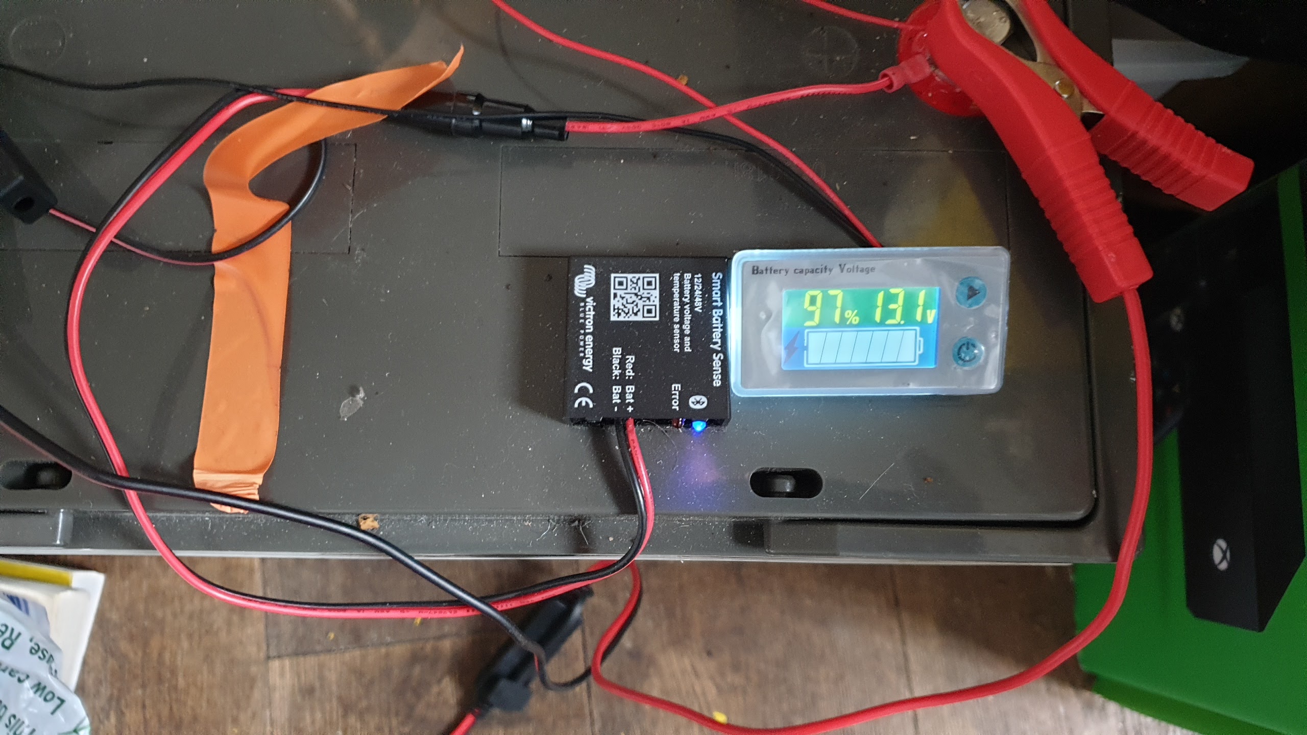

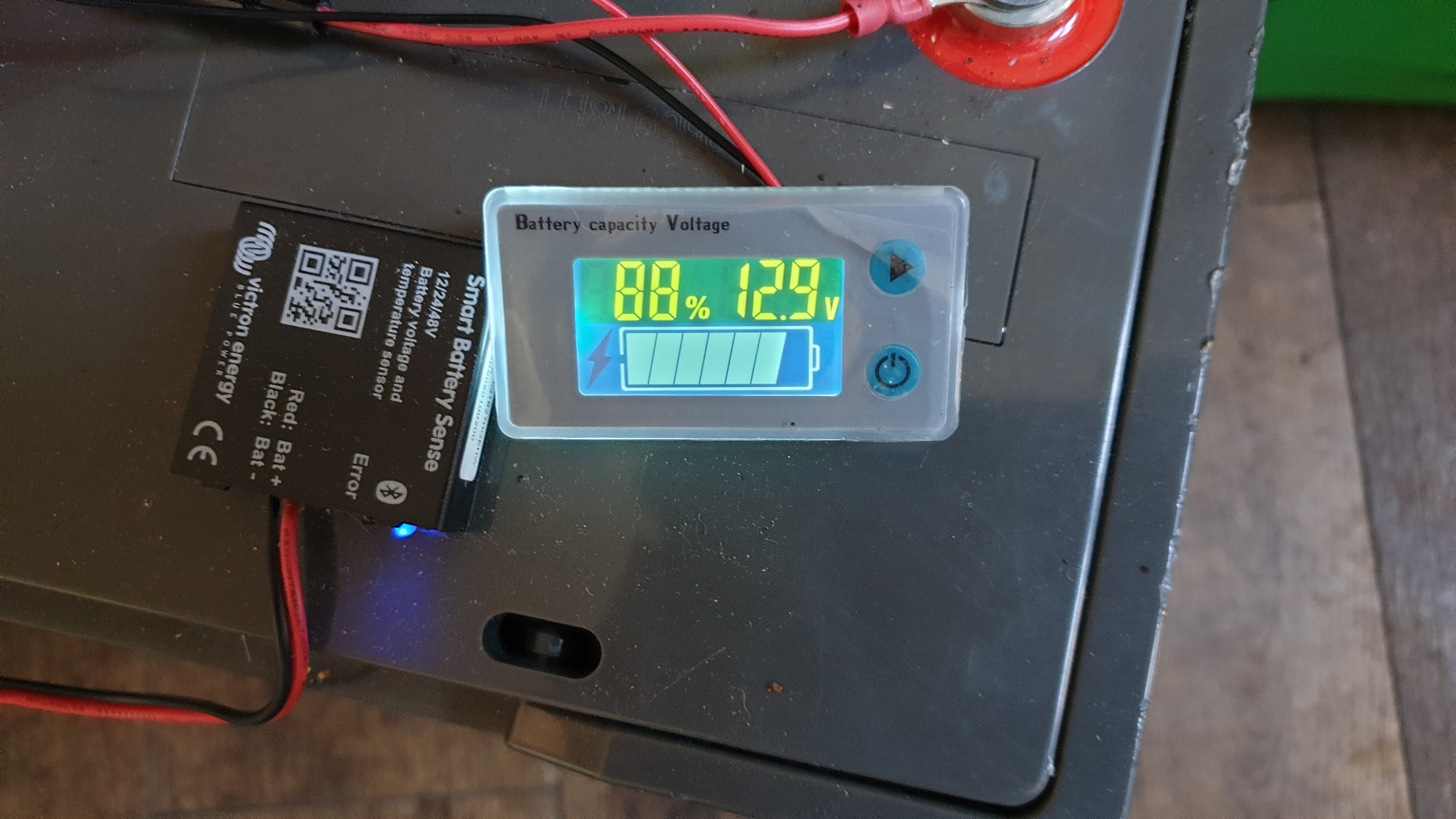

I bought this a while back on Banggood, as the Alpha AGM Battery is not in a Van at present I thought I would connect it up. I think it could be relatively accurate but to test fully I would have to charge the AGM to full then have a 1 amp draw or more to watch the battery capacity lessen over time.
Potentially though it could be an accurate device.

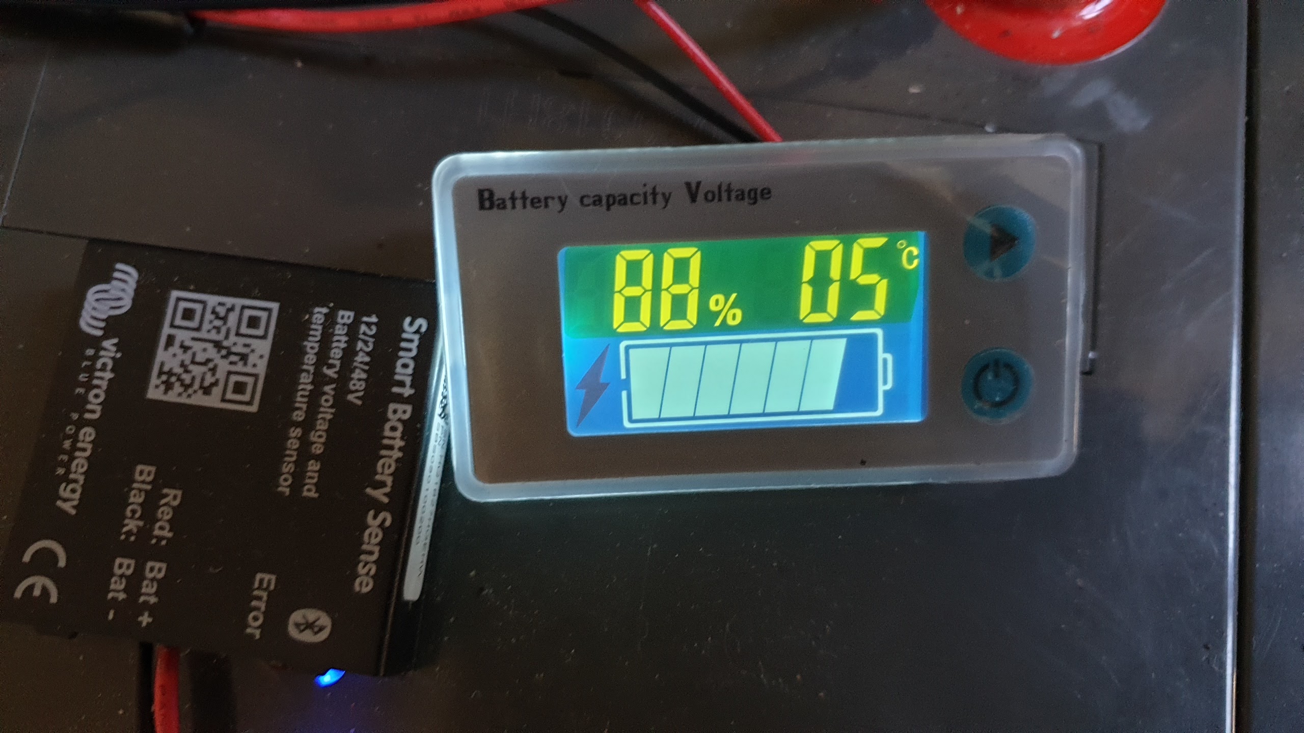

As far as the Temperature goes it is the ambient temperature of the device and not the battery temperature (could be a misnomer).
Still at a little over a fiver it is probably good value I think
www.banggood.com/JS-C33-10-100V-Universal-LCD-Car-Acid-Lead-Lithium-Battery-Capacity-Indicator-Digital-Voltmeter-Voltage-Tester-Monitor-Meter-p-1416277.html

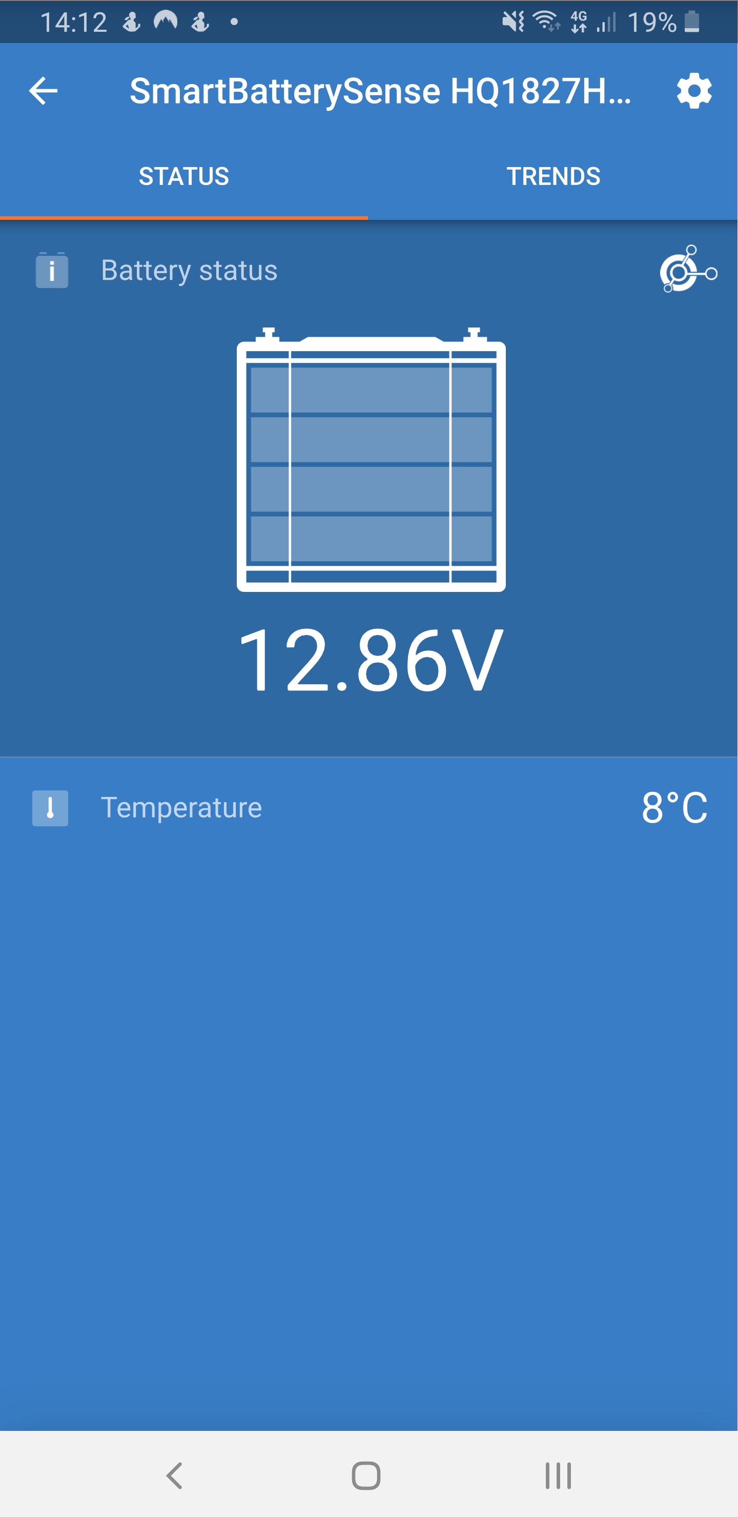

I have run it alongside a Victron Smart battery Sense for now
Thoughts ?

How does it know when the battery is 100% @RAW - Don't know, it says it can monitor 12/24/48 V systems so somewhere it must detect voltage and make a calculation ?
have to set parameters - NO, no way to set anything
Yes I think it is a good idea to connect to starter battery.

To answer the first question, it is simply a function of "SOC" vs Voltage in terms of what it displays. TBH, the battery meter display is pointless. If you wanted to check this, connect the battery to a charger and see the fuel guage instantly hit 100% and stick on a big load and see in instantly drop.
I guess that could be useful for someone who didn't want to pay for a proper monitor and didn't want to have to work out what a voltage figure likely meant.
Word of note: those pre-set voltage-battery level conversions don't apply to Lithium Batteries.

I plugged a Charger in and got this, took about 3 mins to get to 100% - in retrospect I should have simply disconnected the charger when the 100% mark was reached and seen then what the Monitor dropped back to
Anyway as the AGM battery needs a bit of charge I have left it charging. This is not a hugely inspiring video, just for reference really and the timeline was paused to shorten it
That’s how i thought it would be doing it David 👍
I don’t need anything really to monitor the starter battery (Bosch PowerFrame) it’s just I disconnected the horrid little digital clock in the dash as it annoyed me and I thought this may be similar size (isn’t now I have measured). I noticed you could turn the display off on these so wouldn’t annoy me :)

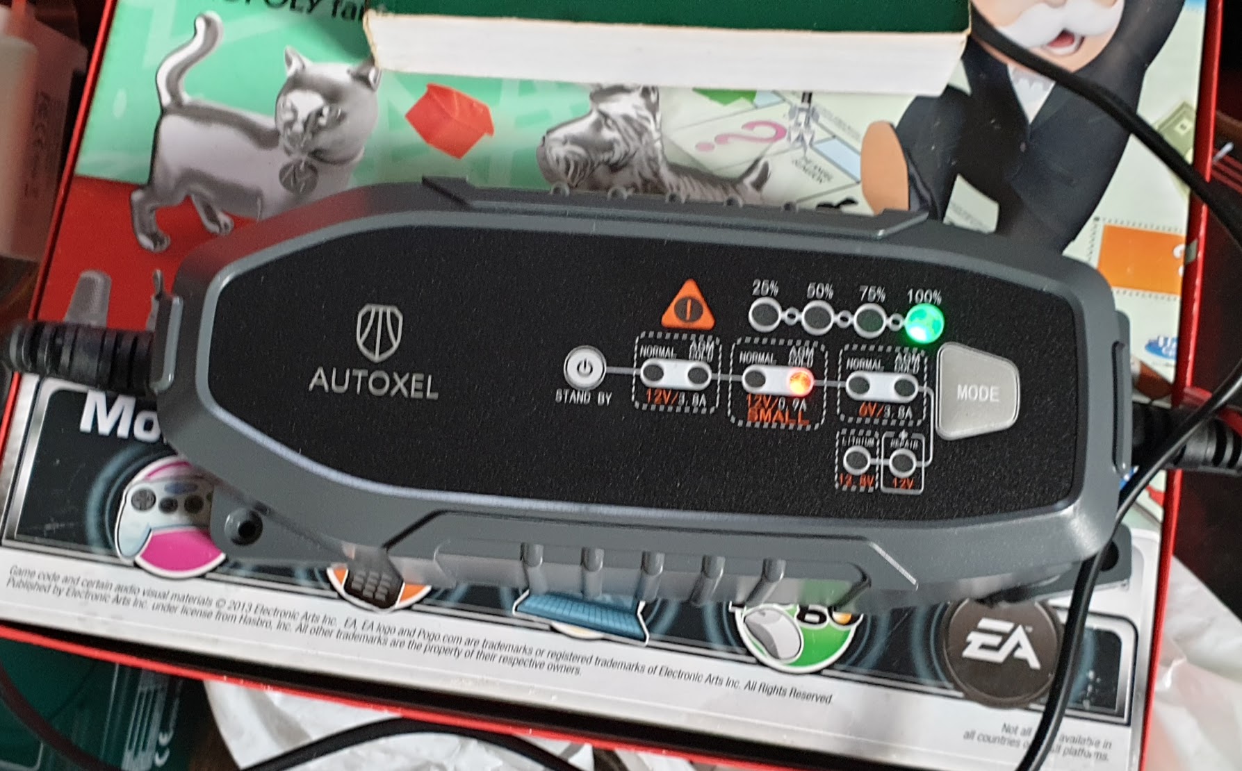

Now the Battery Should be fully charged according to the cheap and cheerful Battery Charger, left on overnight.
I turn on the cheap and cheerful battery monitor and see a reading of 97% and 13.1V, I am pretty sure the full charge capacity of the AGM is 13.4V in output voltage. 13.1 V is confirmed by the Victron Battery Monitor
NOW - Was going to ask what was going on and then re-read the Spec of the Charger and saw this:
Charging Current: 0.9A(Small),3.8A(Normal)
Battery Types: Wet, Gel, MF, CA, EFB, AGM & LIB
Battery Capacities: 2-120Ah (6V), 2-120Ah (12V), Maintains All Sizes of Batteries
So that would be why the charger won't fully charge the battery. However, this also indicates to me (correct me if I am wrong @wildebus) that the small battery monitor is quite accurate as the charge state now would be 97% or thereabouts I would think.

well, I am surprised it is not reading 100% with a battery voltage of >13V.
If it only has two connections - +ve & -ve - there is no way it can read the current so it must be basing the battery level on voltage alone, but not on 100% at >13V makes no sense.
It's magic, I tell thee!
