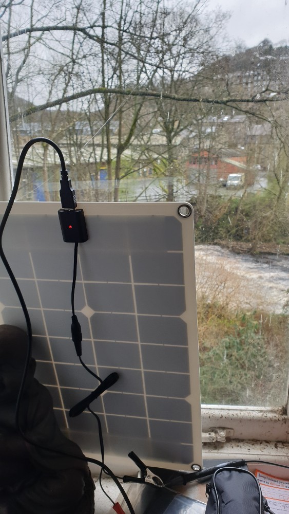

I got myself one of these from EBAY to have a play about with, I am thinking of putting on dash in the Van and perhaps getting more than one
I was pleasantly surprised by the output on a dull day behind a dirty Window
This was taken yesterday morning around 10:30 am
The Sky above

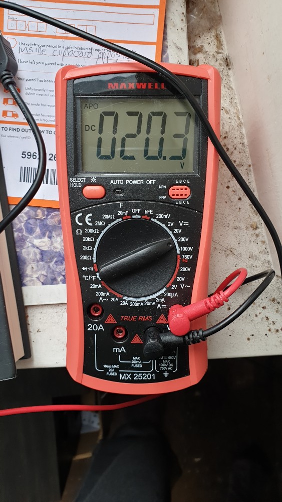

So on a cloudy day through a dirty window, there is an output of about 20V - I do not see why the Panel is sold the way it is sold though as plugging the cigar lighter into your vehicle socket would not be the best idea nor connecting the crocodile clips to the battery.

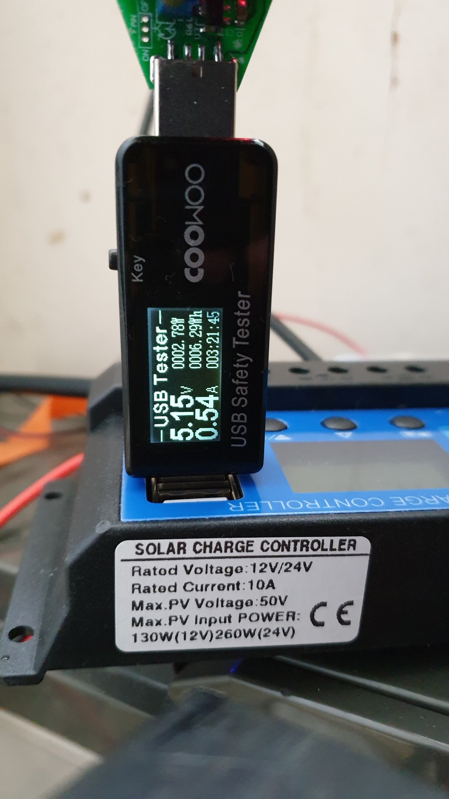

The Panel does output 5V from the USB port as well and the output from that seems pretty poor in terms of current.
The Controller also does not output much Current from the USB ports which suggests that it is really ineffective. As soon as a load over 0.54Amp is applied the voltage drops down to around 3.5V so the USB charge circuitry is naff

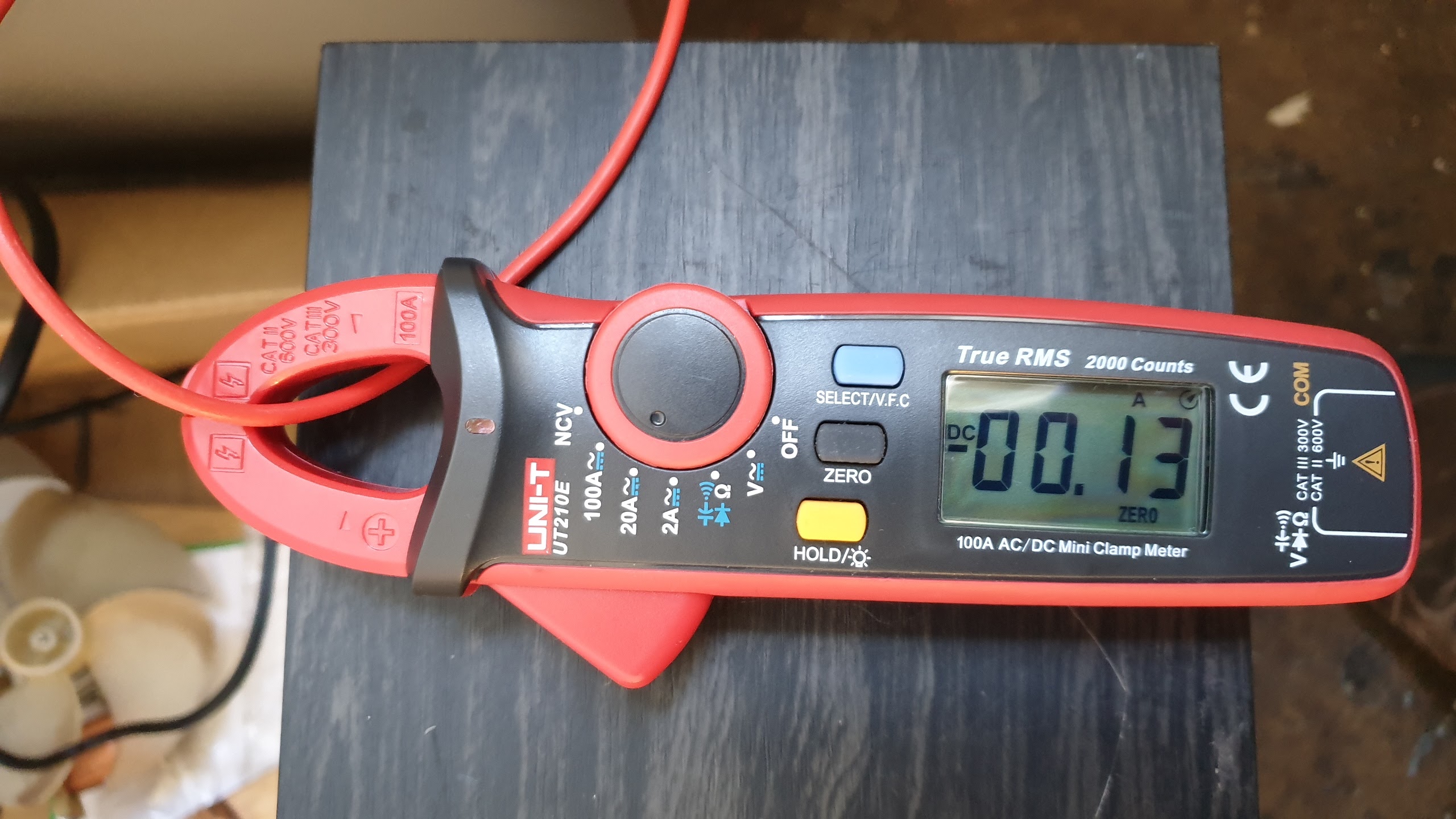

So today when I tested I noticed I was getting 0.13AMP of charge current from the 50 Watt Panel through the PWM Controller
Also I determined the PWM Load with a USB test device as below

not got my thinking head on at the moment but is that right, only 0.13 amps at 20v? My panels are 12v so I never see anything like 20V but I thought it should equate to over 2 amps? Like I say not got my thinking head on at the moment though
  • Like
Reactions: RAW
P=IV
In my case
P = 0.13A x 20V = 2.6W
However Solar levels are low with much cloud cover and panel facing North
In bright sunshine I think i would expect
50W = 2.5A x 20V
So in bright sun would get maybe a 2.5 Amp flow from Panel and Charge Controller with NO LOSS , however that particular Charge Controller is NAFF so I don't think I would be likely to get anything like that from it, would be lucky if I got 2 AMP to charge the battery bank with that Charge Controller.
Neil, your "12V" panels WILL hit 18V-22V (depending on the panels) when working. My 4 x 12V Panels (so nominally 48V) run at around 88V (so 22V per panel).
That 50W panel will have a peak output to the battery of around 4A if running at full harvesting. This time of year, maybe half that at high noon?
EDIT: those numbers assume a good MPPT controller. With a PWM unit, take off 30% so maybe expect around 1.3A tops at noon?

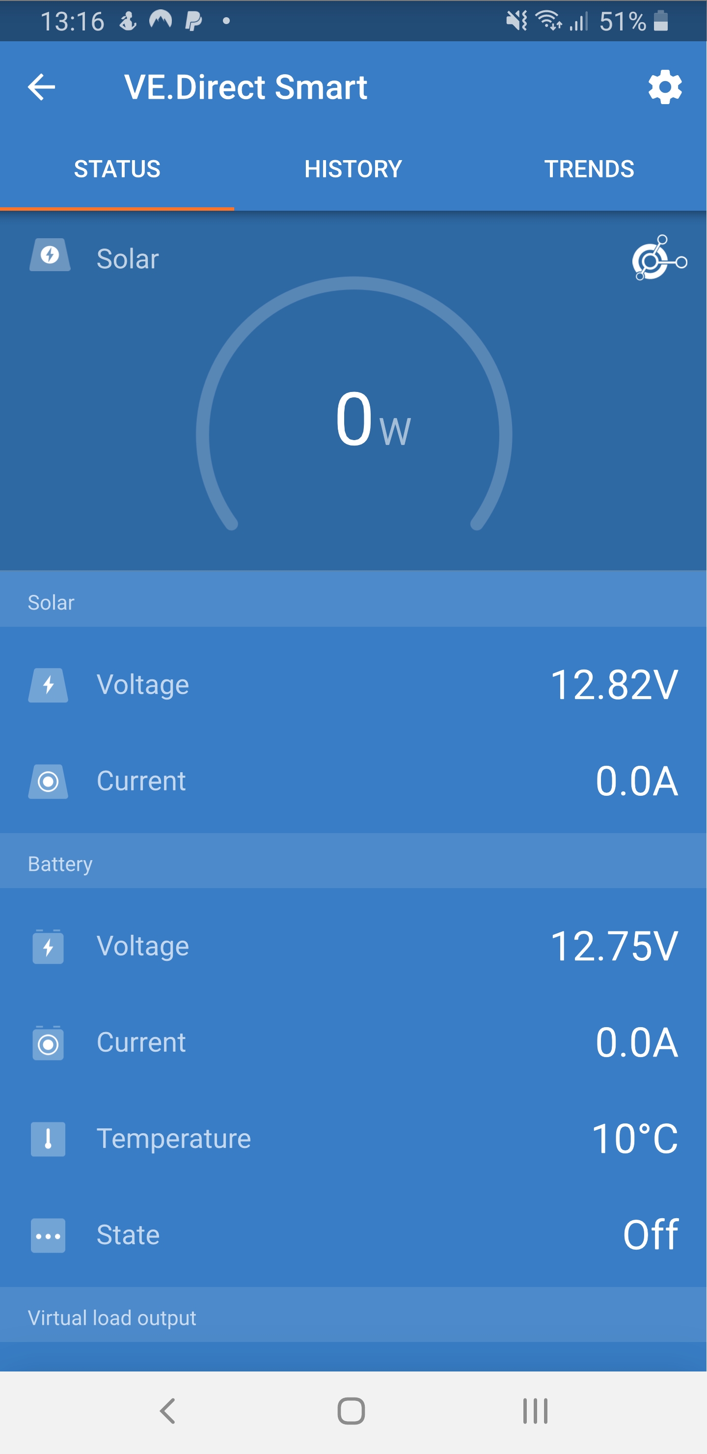

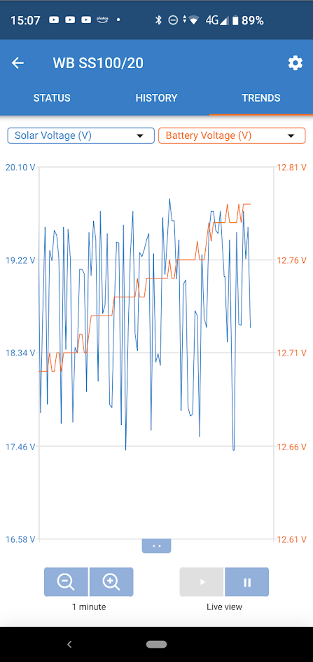

Further to this - I have now connected the Victron MPPT 100/30 to get some better data out of the 50W flexible Panel
I am having some issues though getting the charger to turn on, unless it is just not possible in the way I am trying to achieve it ?? @wildebus ???
For More read https://community.victronenergy.com/questions/45115/charge-state-is-off-turn-on-remotely.html
Are you trying to change the setting by the Remote Console? That is not possible.
For VE.Direct devices, just about everything (maybe EVERYTHING?) shown in the Remote Console is informational only and not changable in that tool. You need to use Victron Connect or controls on the devices themselves to change settings.
If you are seeing the State as "Off" there are two possibilities:
1) The controller has not detected a input voltage >5V higher than the battery and so woken up
2) The charger is turned off in the settings ("Charger Enabled" is not enabled) - This is the situation you have I think.
I don't know if there is any way to re-enable the charger via a jumper or switch on the controller or if you have to plug in the BT Dongle and have to go via Victron Connect, but I know you cannot (at present) use the Remote Console.
*The only device I know of that you CAN fully control the state of via Remote Console is the Multiplus/Quattro Charger/Inverters - but that was only a recent thing that required an update to the Venus OS and firmware upgrades to the Device as well and is connected via VE.Bus rather than VE.Direct.
YES
I turned charger to OFF when I was removing it and disconnecting battery in Sylvia, OFF for maintenance. So as you have clearly pointed out, as has a member of the Victron Community, I cannot alter the settings without connecting to the MPPT 100/30 with either my phone over the BT dongle or another device, maybe the Venus GX but don't have one.
THANKS for you help @wildebus
YES

So it seems now with the 100/30 plugged in that the Solar Panel is making so little power as to even record anything (sad face) so this 50 Watt Panel may just provide the smallest trickle charge to a battery but would be better to use a less Powerful Solar Controller perhaps

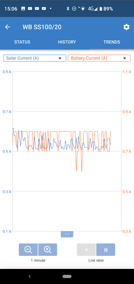

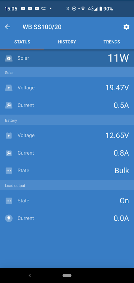

Got the setup done but my battery was too charged up so ran a tyre pump for a while to use some power :)
My panels are in fact just 30W ones (I must have got 30W and 40W, not 40W and 50W), so have one connected now. facing the sun, but there is a tree in-between so the branches are diluting the effect somewhat.
They are Rigid Glass panels from Victron rather then flexible ones.
some quick screenshots ....
Point in time first
And a little bit of trending
So working pretty well as I would expect given time of day/year and tree shading effect.
