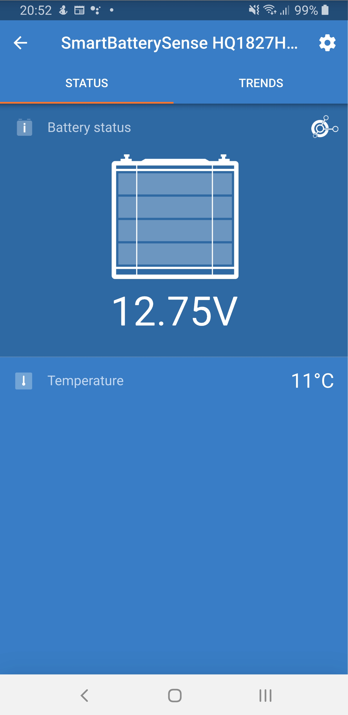

Carrying on From this testing and as it has been a sunny couple of days there follows some more insights I have drawn.

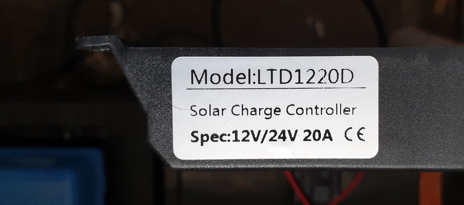

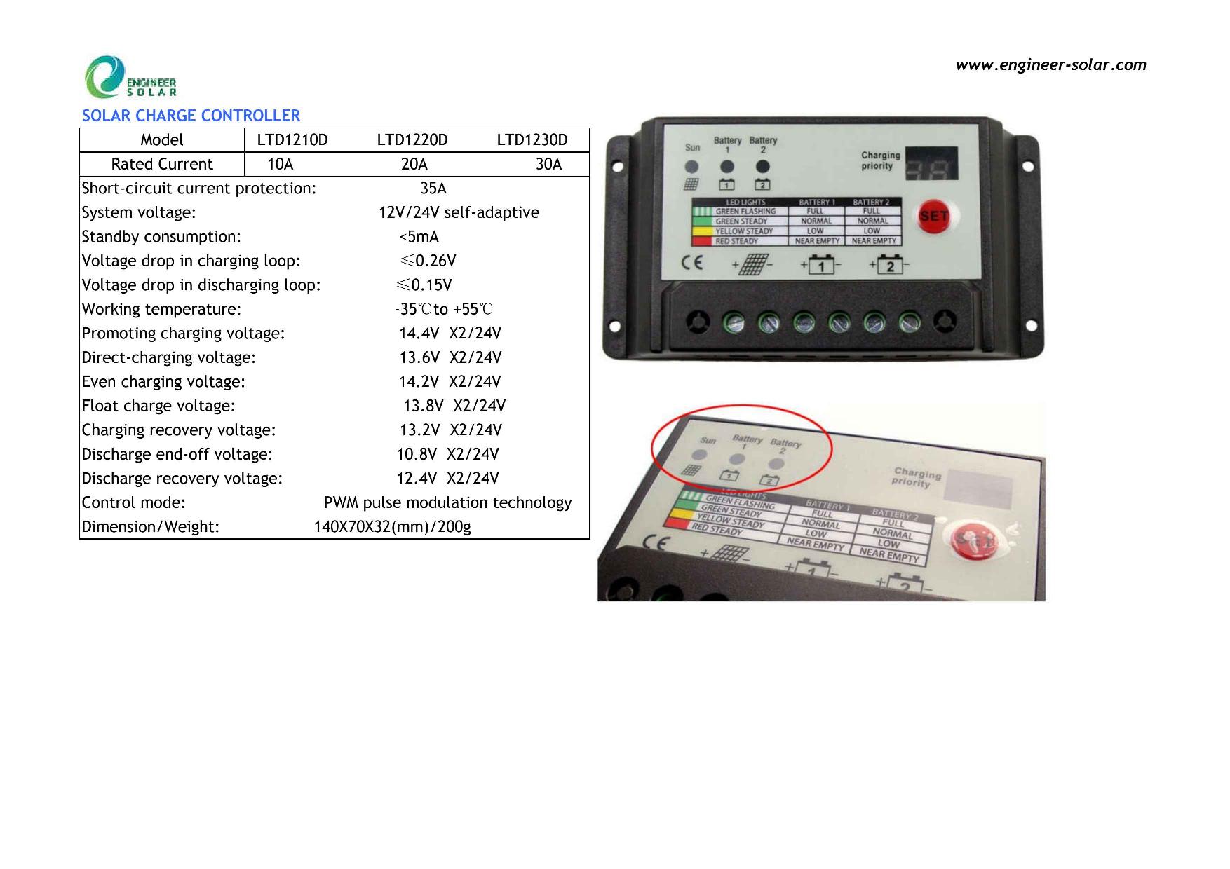

I obtained on Facebook Marketplace one of these quite cheaply- £9:
So it is PWM and like this
It seems to be pretty good.

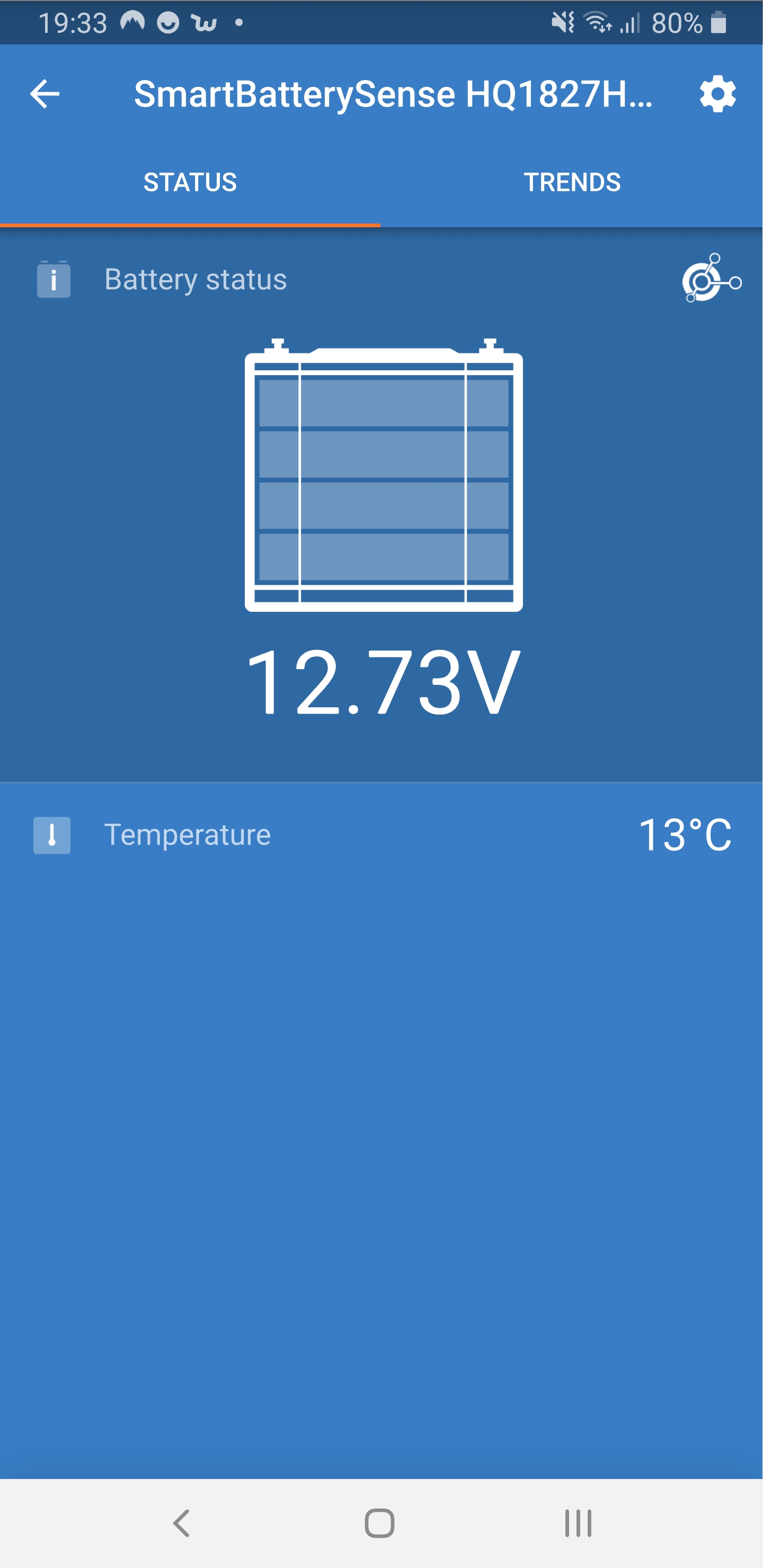

When I was running the Victron with the 50W panel the battery was not charging or at least the voltage was not increasing, I suspect that this was because the power generated by the solar panel where it is was only sufficient to power the MPPT controller and not sufficient to charge the battery.
Now with this PWM controller it seems to be that the battery voltage is increasing, therefore the battery is getting some charge now
On Wednesday the Voltage was 12.73V
Thursday increase to 12.75
Friday maintains at 12.75
As I will be using the Solar Panel on the Dash in the Van to keep the engine battery topped up because there is a drain from something and I am struggling to find it I think using this controller will probably do the Job

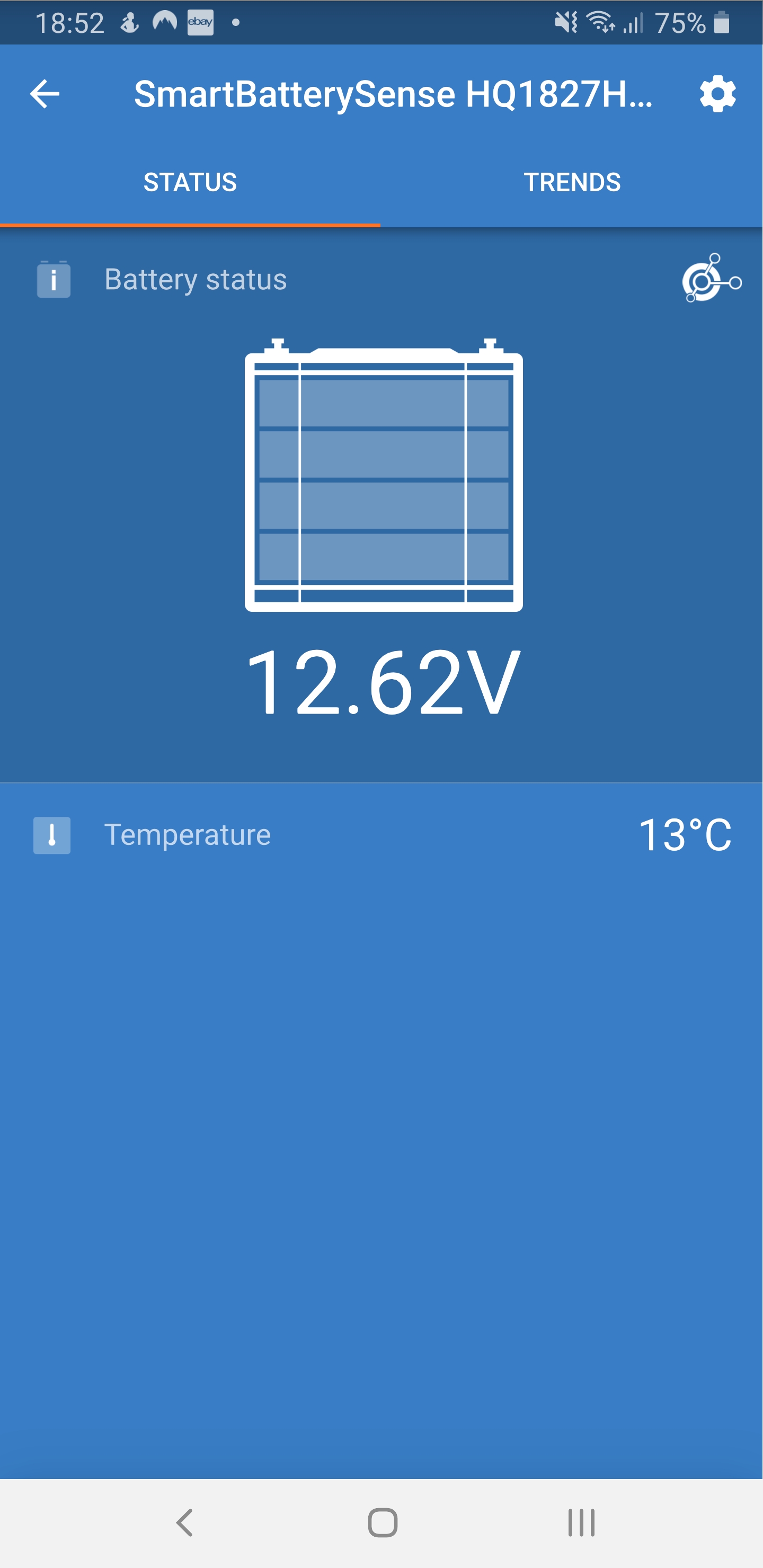

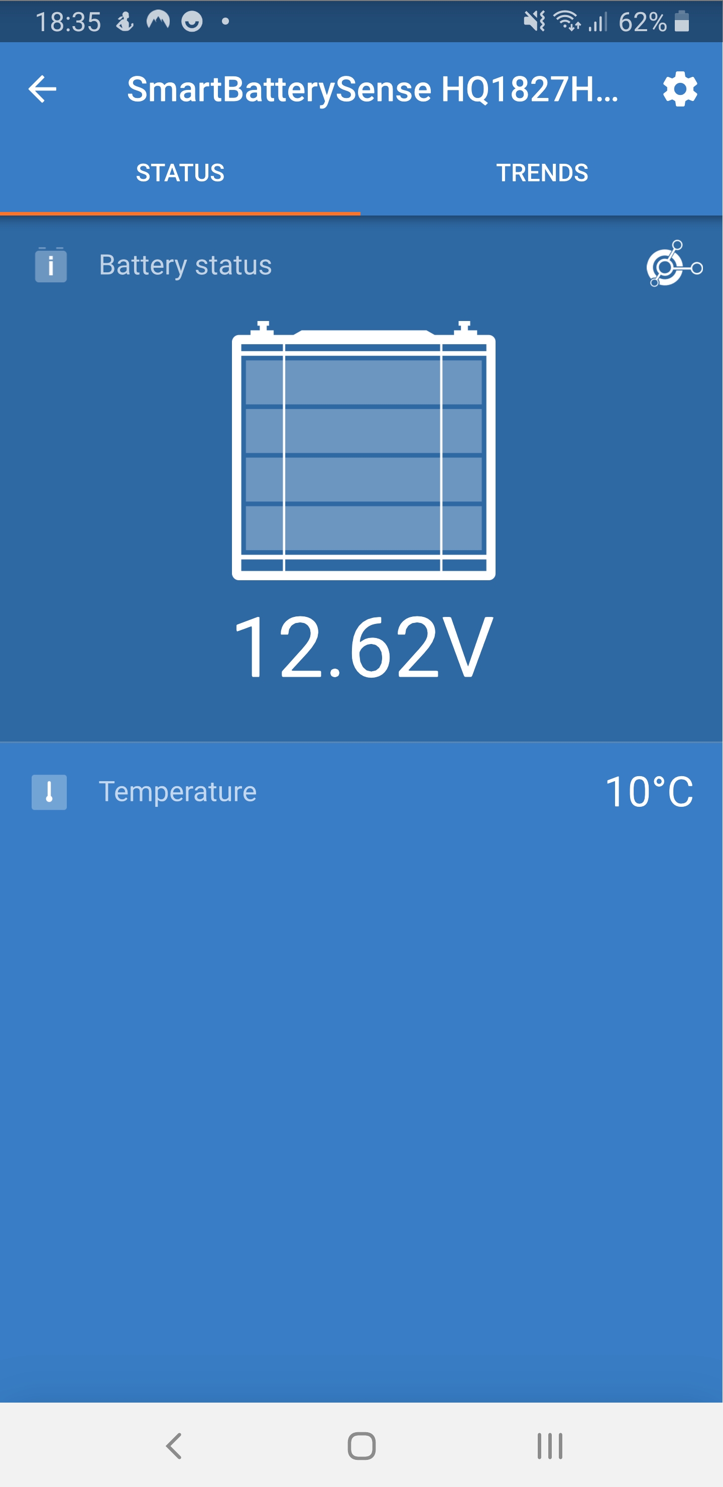

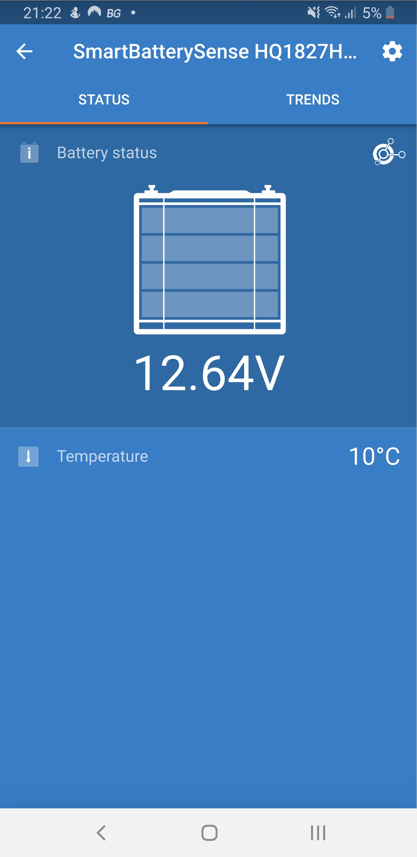

More testing down the timeline
There is more light now as we move closer to the Equinox
The LTD1220D PWM has been attached for some time now and these are the readings from the Battery Monitor, although some voltage was lost whilst I was testing the cheap USB 4 Port Supply that I have posted about here motorhomebuilder.com/threads/nice-little-4-port-usb-buck-boost.66920
I still have the 4 Port USB connected up so that's drawing some Power as is the small Victron Battery Monitor, but here are the evenings stats after the Sun goes down or Solar Panel no longer producing energy.
29th March30th March31st March
This would suggest to me that there is not much more than the draw from the devices being produced by the Solar Panel which would be
Small Battery Monitor as described here draws : 0.005A when off
The Solar Charger When getting no Solar draws : 0.05A
The Victron battery Monitor draws : 0.016A
The 4 Port USB described here : 0.265A
A bit of Math
0.265+0.016+0.05+0.005 = 0.336 A
P = IV 0.336 x 12.6 = 4.236 W
Just a trickle really though as stated the panel is behind a window that's not very clean and also North Facing with trees in front and recently it has been predominantly cloudy.
