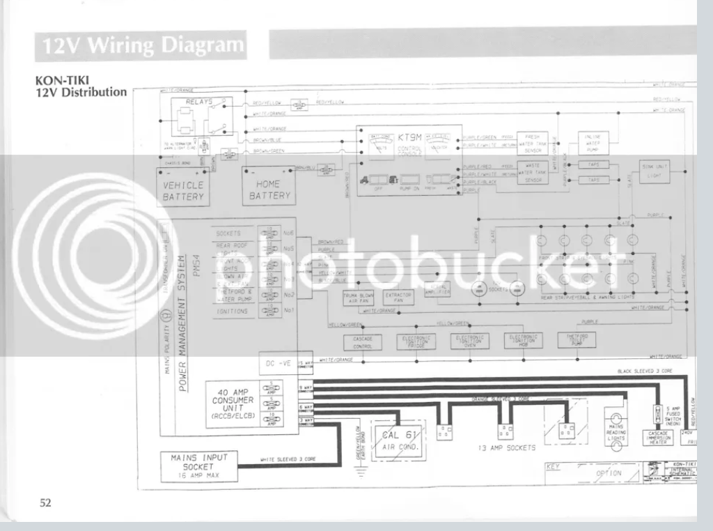

Cant find any details on that PMS4 unit unfortunately, they seem like gold dust. So don't know if both the cab and the hab batteries are taken back to that unit or if there is a split charge relay somewhere, possibly under the bonnet where again, both battery connections are available.
Looking at the first photo of th control box, the switch bottom right selects between using the Vehicle and Leisure battery, or turning the system off.
Assuming this is connected (not all features may be connected in some installations, but on a factory motorhome let's assume they are), then THAT is 99% sure the ideal place to make a connedtion for a battery maintainer.
You bring out a connection from inside the box for both +ves of the batteries, which must be in the box (just need to follow the switch wires) to the maintainer; find an earth inside that unit (there WILL be one) and those 3 wires go to the maintainer and that is the job done.
Now THIS is an important point .... The above is only true IMO if you are going to use a proper battery maintainer such as the Battery Master or preferable the Ablemail AMT12-2. I would not do it this way if just using a switch connection or physical joining of the cable (the "clive Mott" type setup). The Wires you are using mayb be small and could not withstand the potential loading if you leave then connected when starting the vehicle. The Battery Maintainere by design are current limited and their draw will be within the design limits of the cables in the box.
That reminds me .... On that age of British Motorhome, there is typically a pair of relays under the bonnet - one for split charge, one for fridge - with a D+ control signal. You could connect a maintainer there, spurring off either side of the relay. That would be literally a 10 minute job.

Bad pic of PMS4

Getting slightly off topic, but some photos which could possibly help get a feeling of what to expect when working on this PMS unit (TBH, I think if someone is wary, these photos will reinforce that, but don't be frightened!)
This is a PMS3H at the top of the photo (the H stands for Horizonal. There is a PMS3V as well (you can guess what the 'V' stands for ;) )
1 - 1) Location for BMV by David, on Flickr
This is the rear of the PMS3H
PMS3H Rear by David, on Flickr
Now the point of showing this photo is that you can see that it is basically just a box and you have wires coming in and connected to a block.
That is where you get your feeds from. I can't tell you off-hand which connector is which as 1) this is a PMS3 not a PMS4, and 2) this was taken nearly 4 years ago when I was doing an upgrade on a VW Conversion.
I can't imagine a PMS4 will be that different to a PMS3 in the way wires are brought in.
Anyone who would come and look at the setup with a view to fitting a battery maintainer would be able to see very quickly which wires are which and certainly would not need access to a PDF in order to do so.
