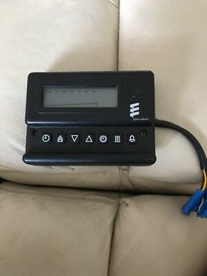

Unable to read fault codes, I have this controller. As for the fan, it does not rotate at all when switching on.

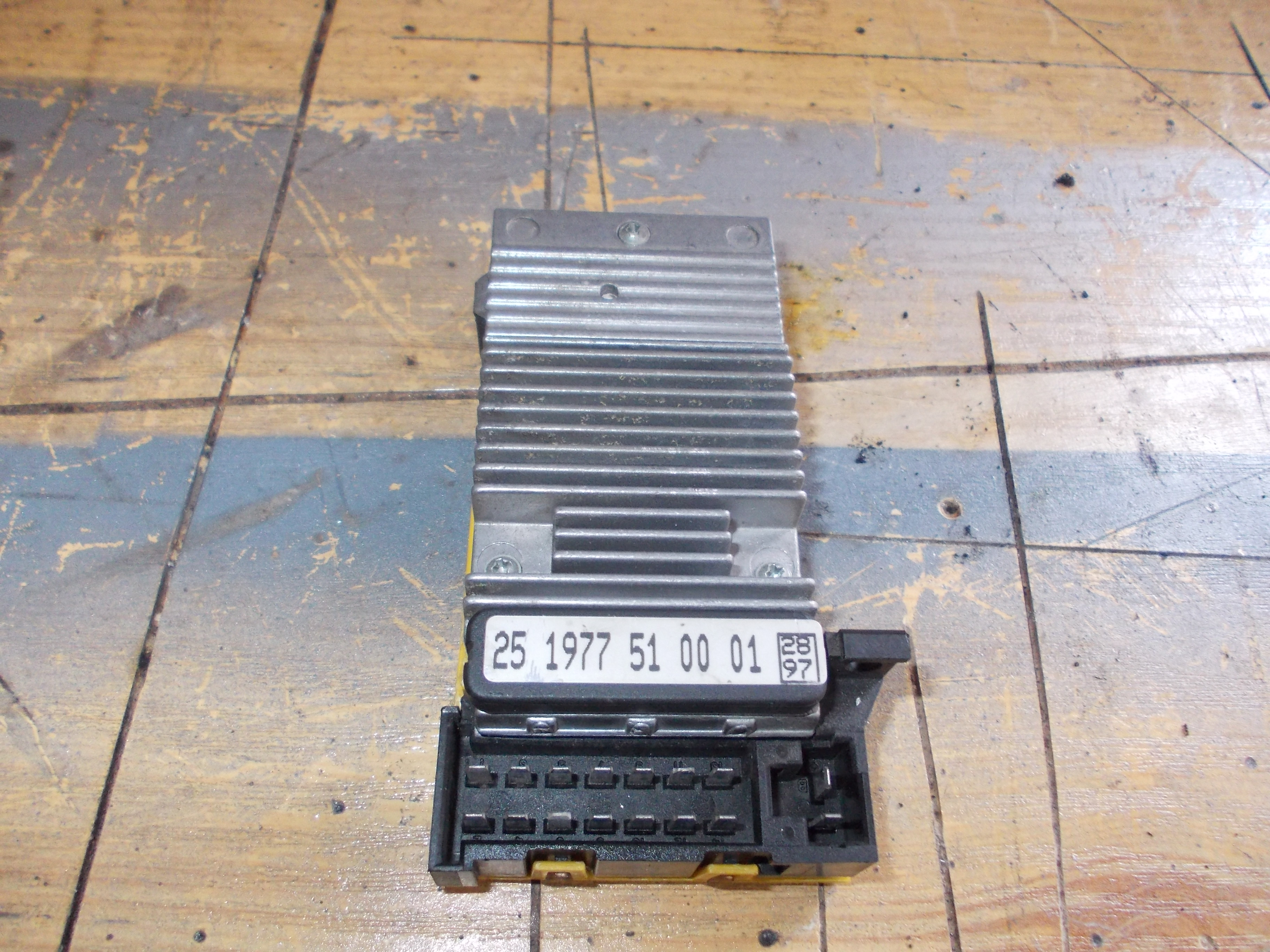

Had the ECU and the controller apart looking for burnt bits but none could be found but while I was inside there were stickers with 24v on them.
There will be a part number on the ECU, this will denote what application it was intended for. For example I have an ebespacher from a DAF truck. It's controlled by the trucks climate control system and will not work from a eberspacher controller.
Looked last night and it seems to be the right controller.......... 25 1977 51 00 01

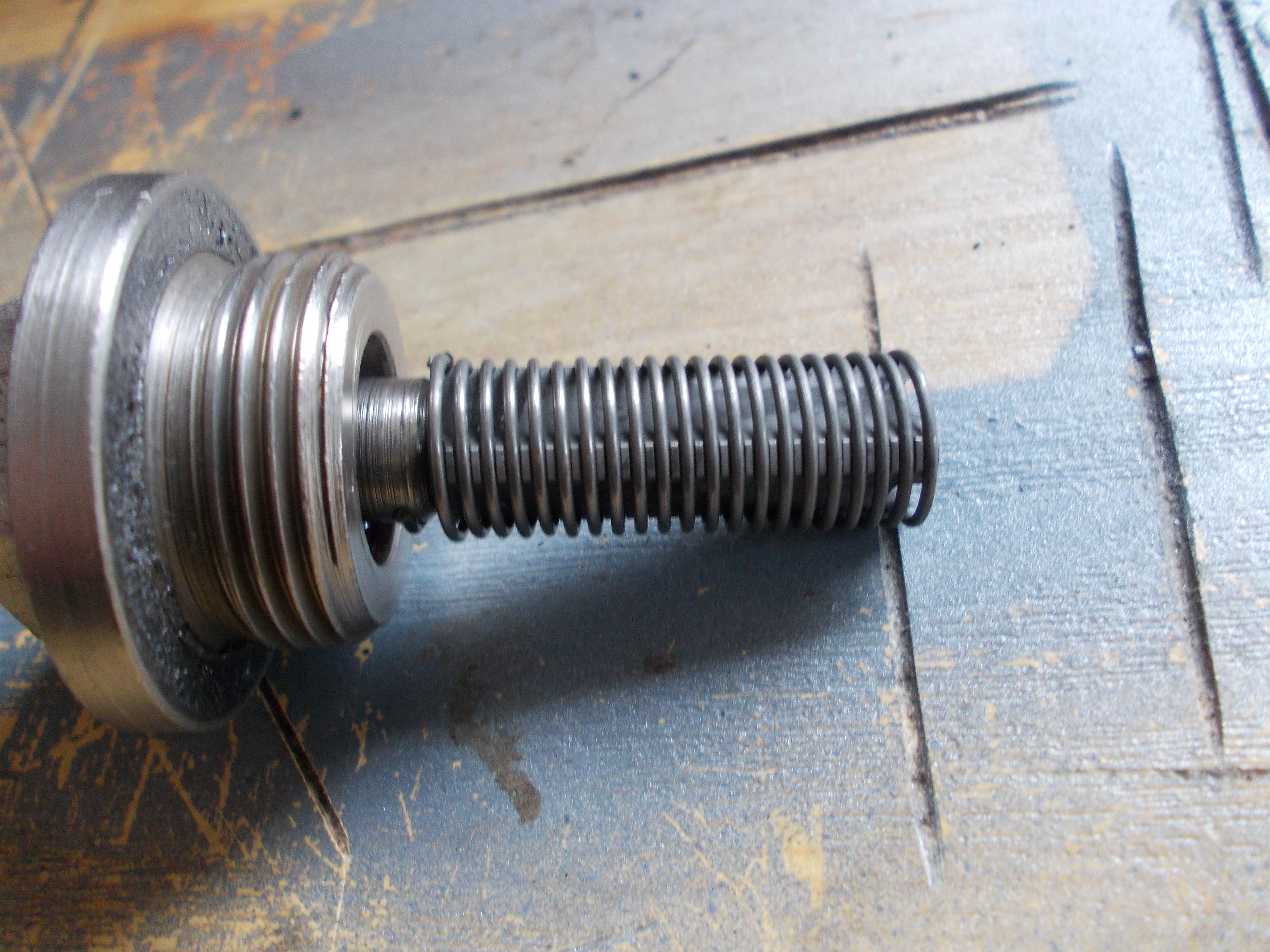

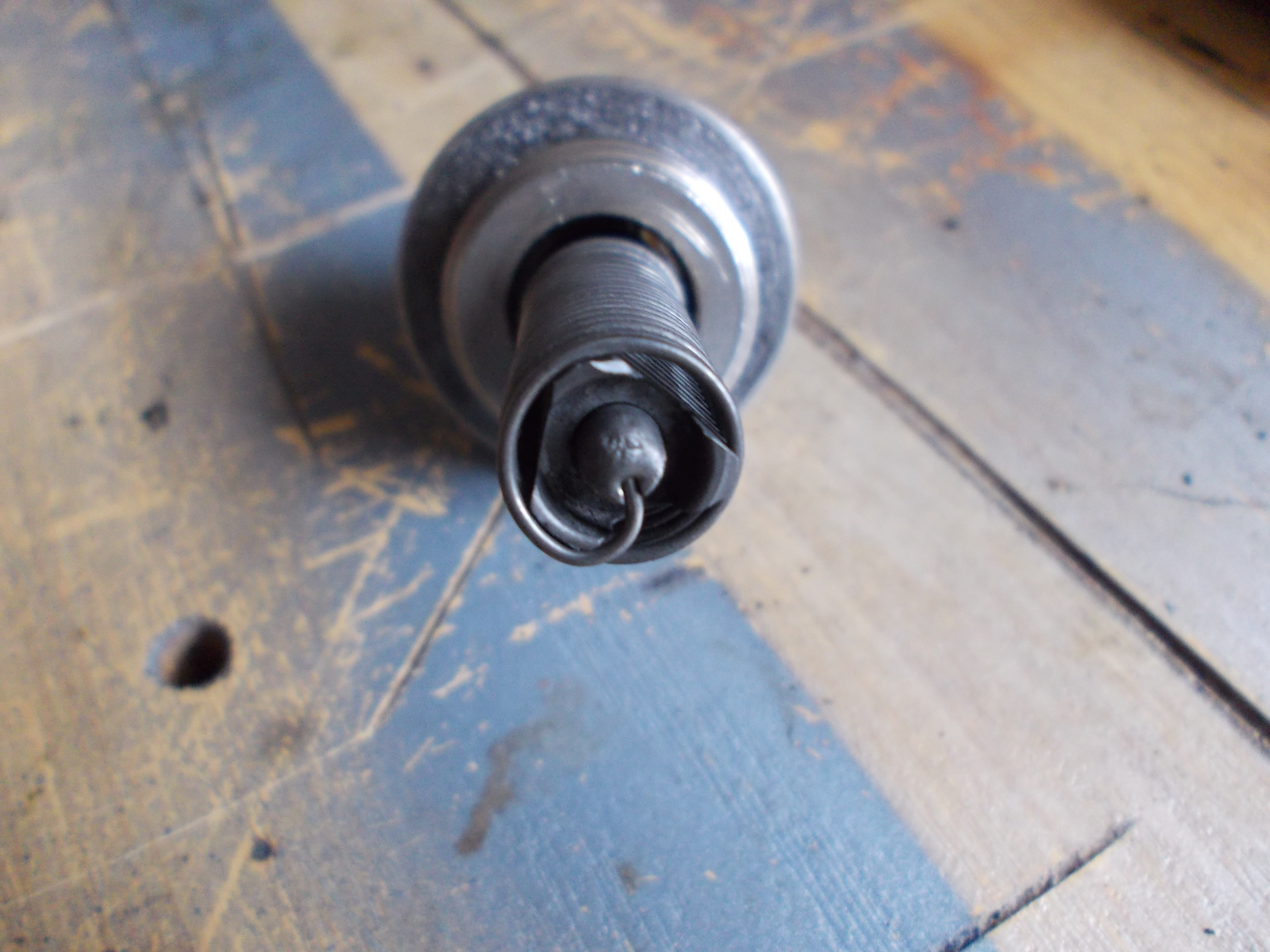

Whipped the glow plug out and, as you can see, I think it could do with a service.
Definitely looks like the glow plug could do with a clean.

Yes your ECU number seems ok.

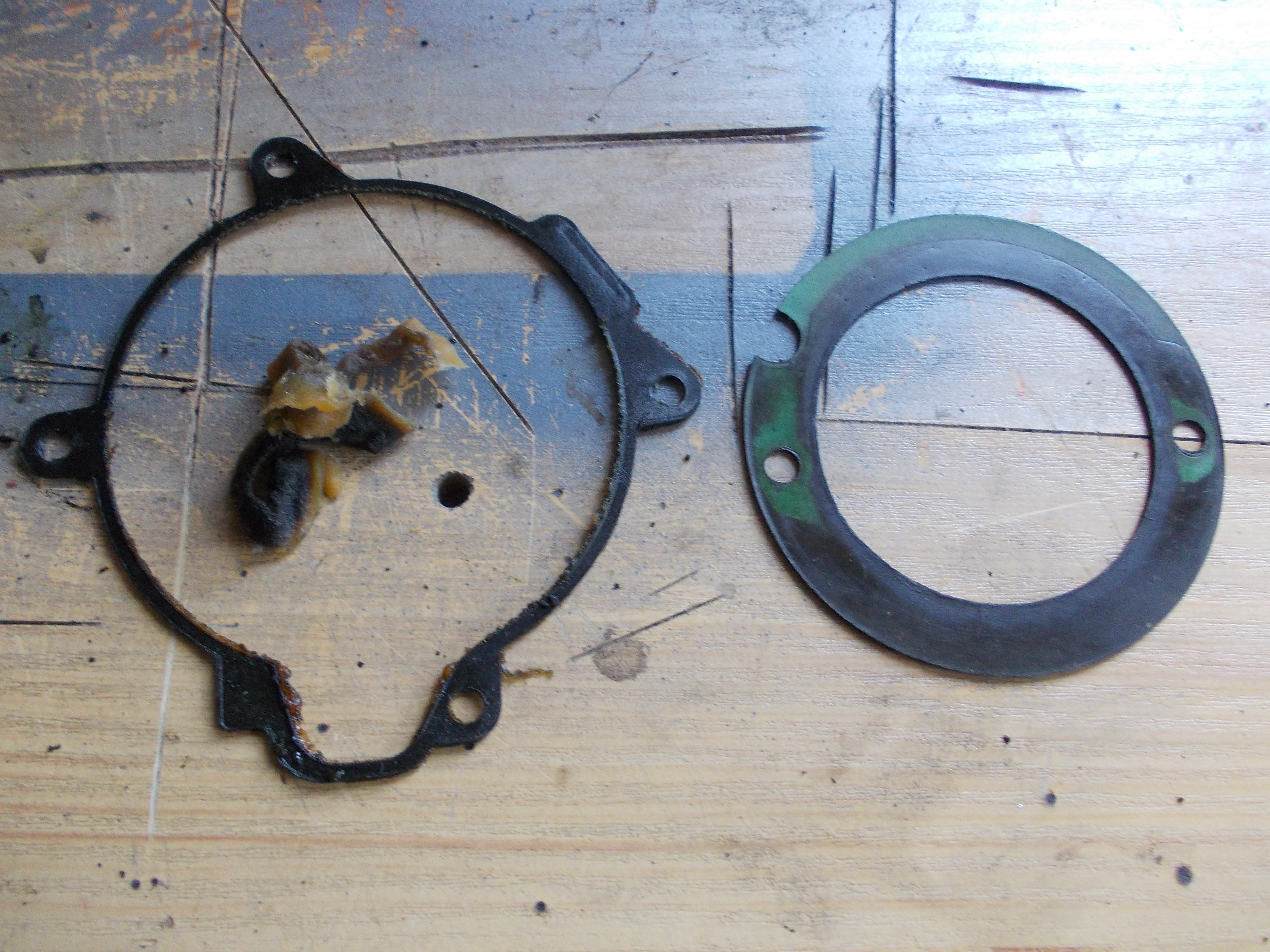

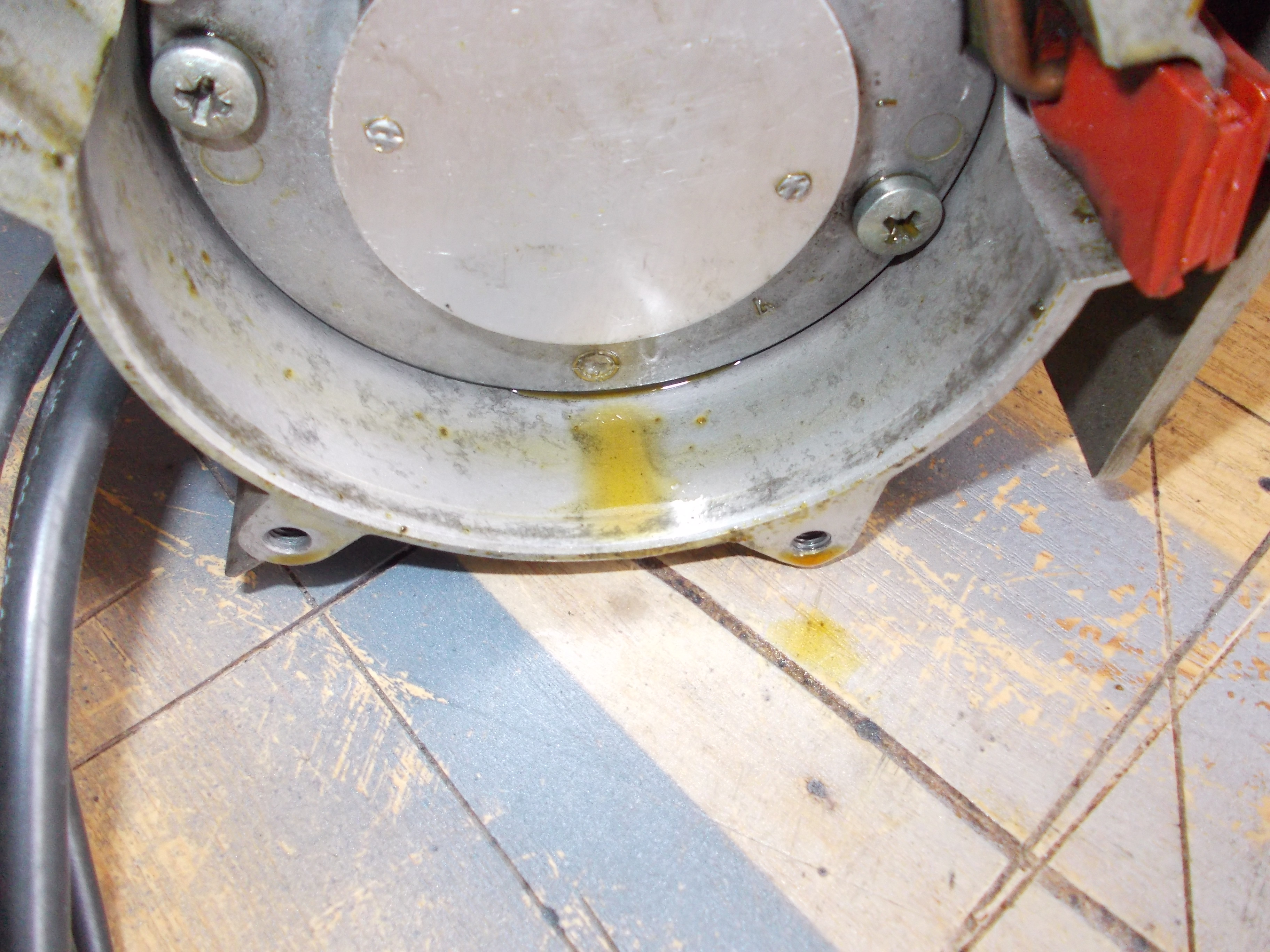

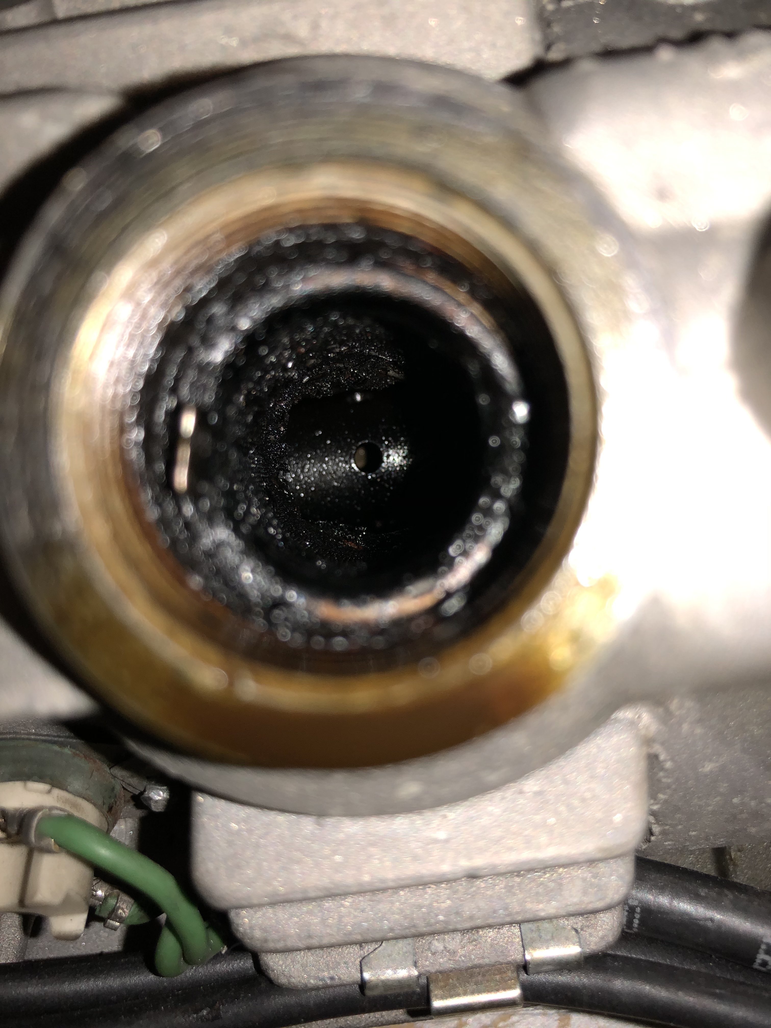

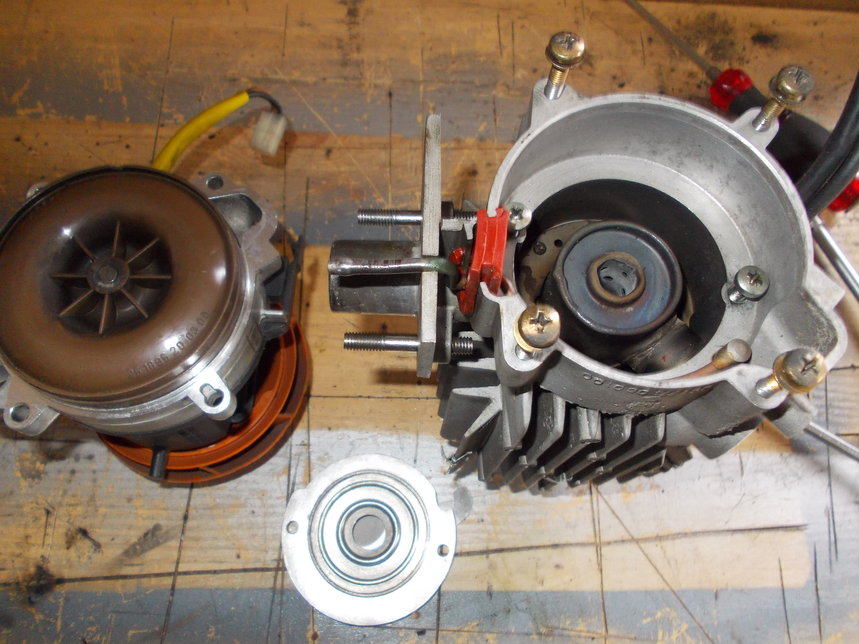

Set about stripping it down; fairly straight forward as all the screws are still in good condition. First thing I noticed, how easy it came apart: the gaskets seemed not to have stuck very well. The second thing I noticed, after I had removed the fan, was a nice leak coming from the bottom on the inside; which made me think perhaps the gasket wasn't making a good seal.

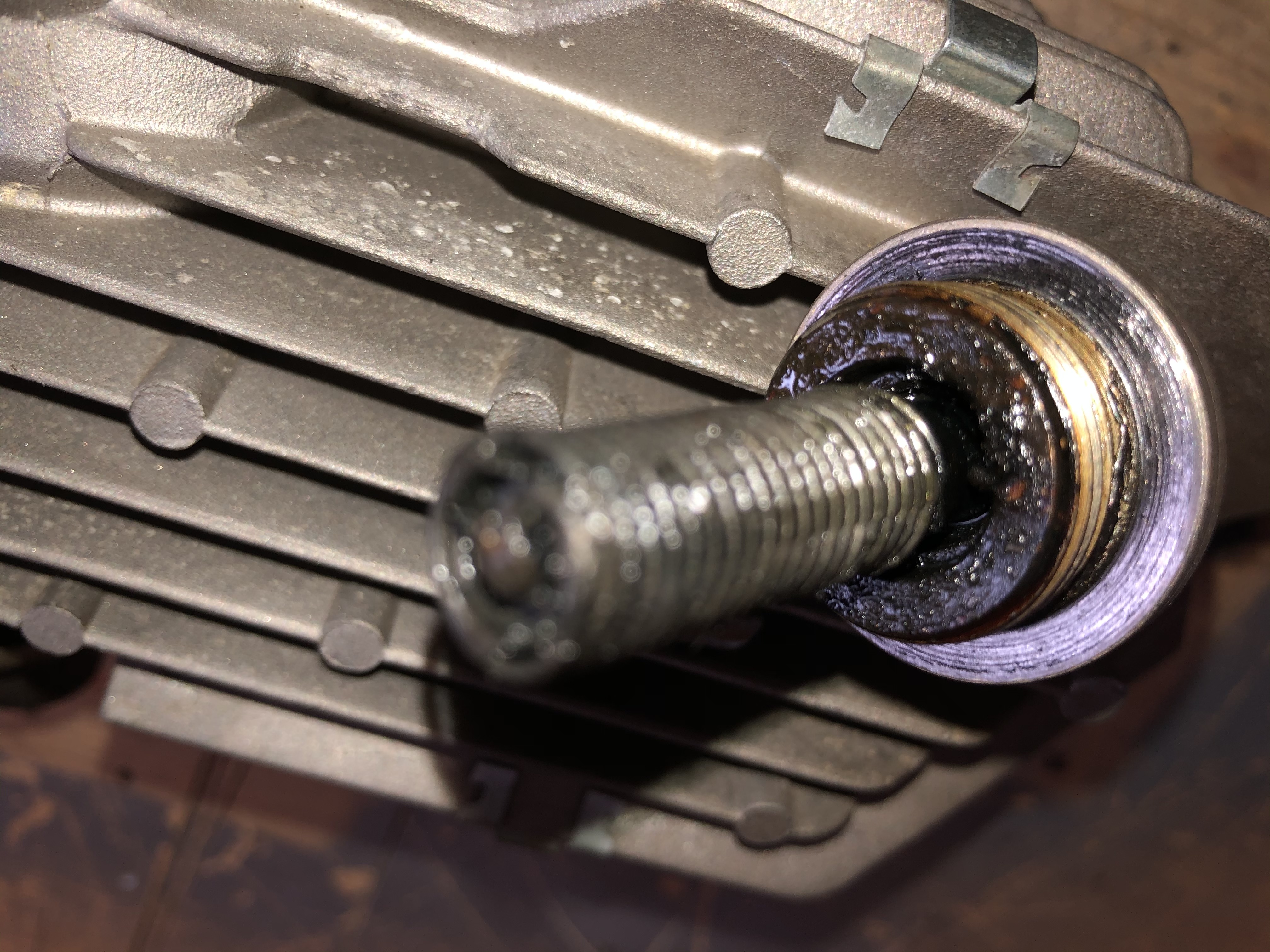

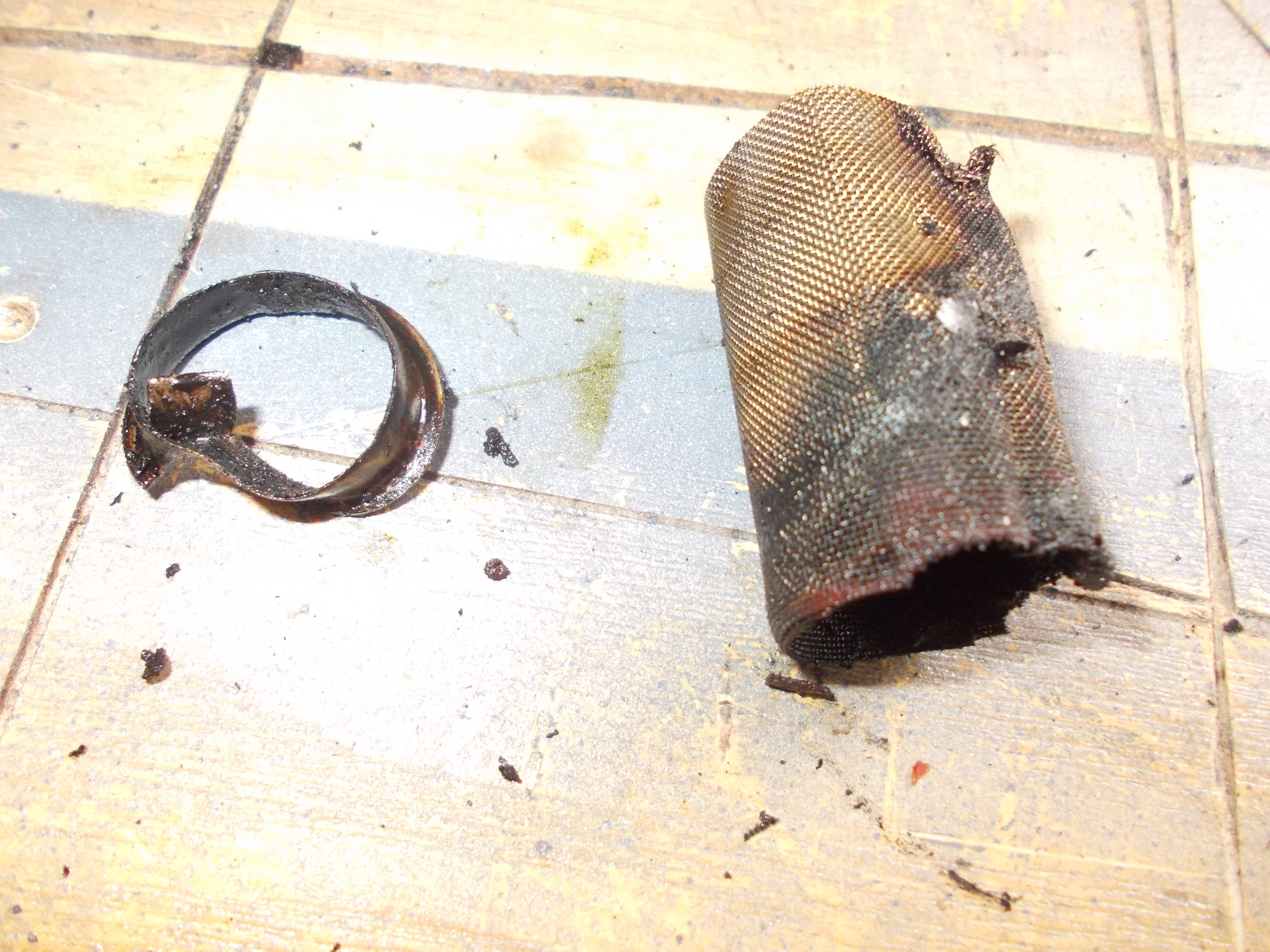

Get the glow plug wire gauze out. To achieve this I found the easy way was to collapse one side and remove with a pair of long nose pliers. As you can see from the picture, it's in a bit of a sorry state.

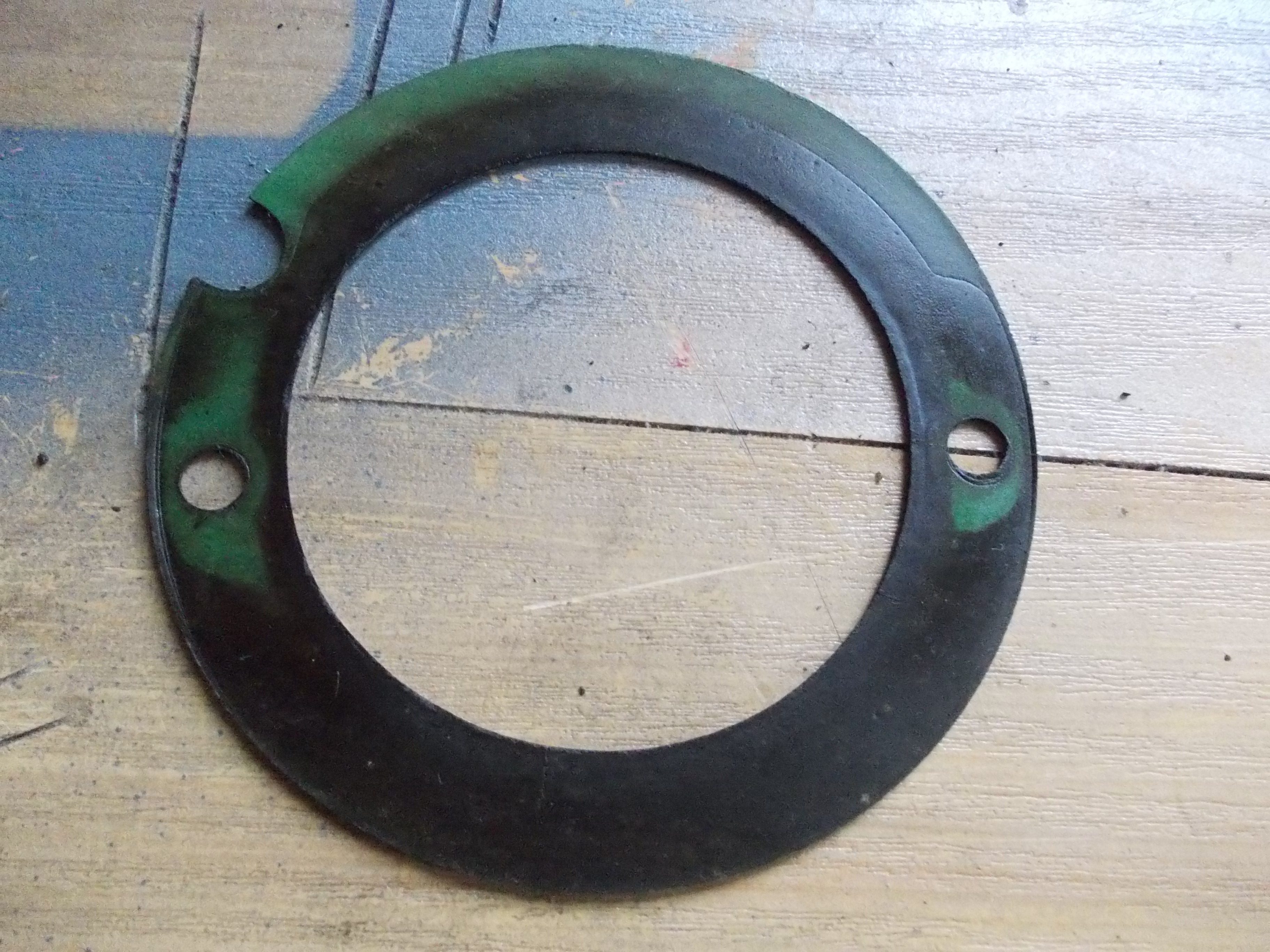

Here are the gaskets. The one on the left still had traces of grease round the edges, the felt O-ring was absolutely soaking in diesel and the burner gasket just fell out.
By the looks of it, it wasn't doing a very good job as a seal: you can see where the gases had bypassed.
All cleaned up and ready for the gaskets. Could not believe the price of a service kit but as the rest of the heater is in good condition I see it more as an investment than something I have to pay for.
Glow plug cleaned up nicely although I don't know if I will be using it as I am getting a new one in the service kit.

Someone has been there before you, I wonder why?
Is your felt seal missing on the front of the burner?
