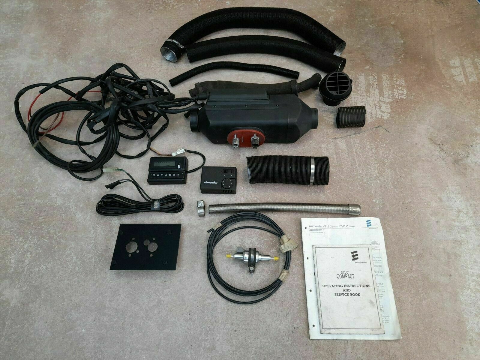

I have decided to go down the Eberspacher route but with a twist. I am going to use a 24 volt Eberspacher heater with a 12V to 24V 20A DC-DC Step-Up Voltage Supply Module. The heater has cost me £103 + £10 P&P, the 12v to 24 v cost £27.33, total £140.33: there was nothing at this price in 12 volt so I have gone for it

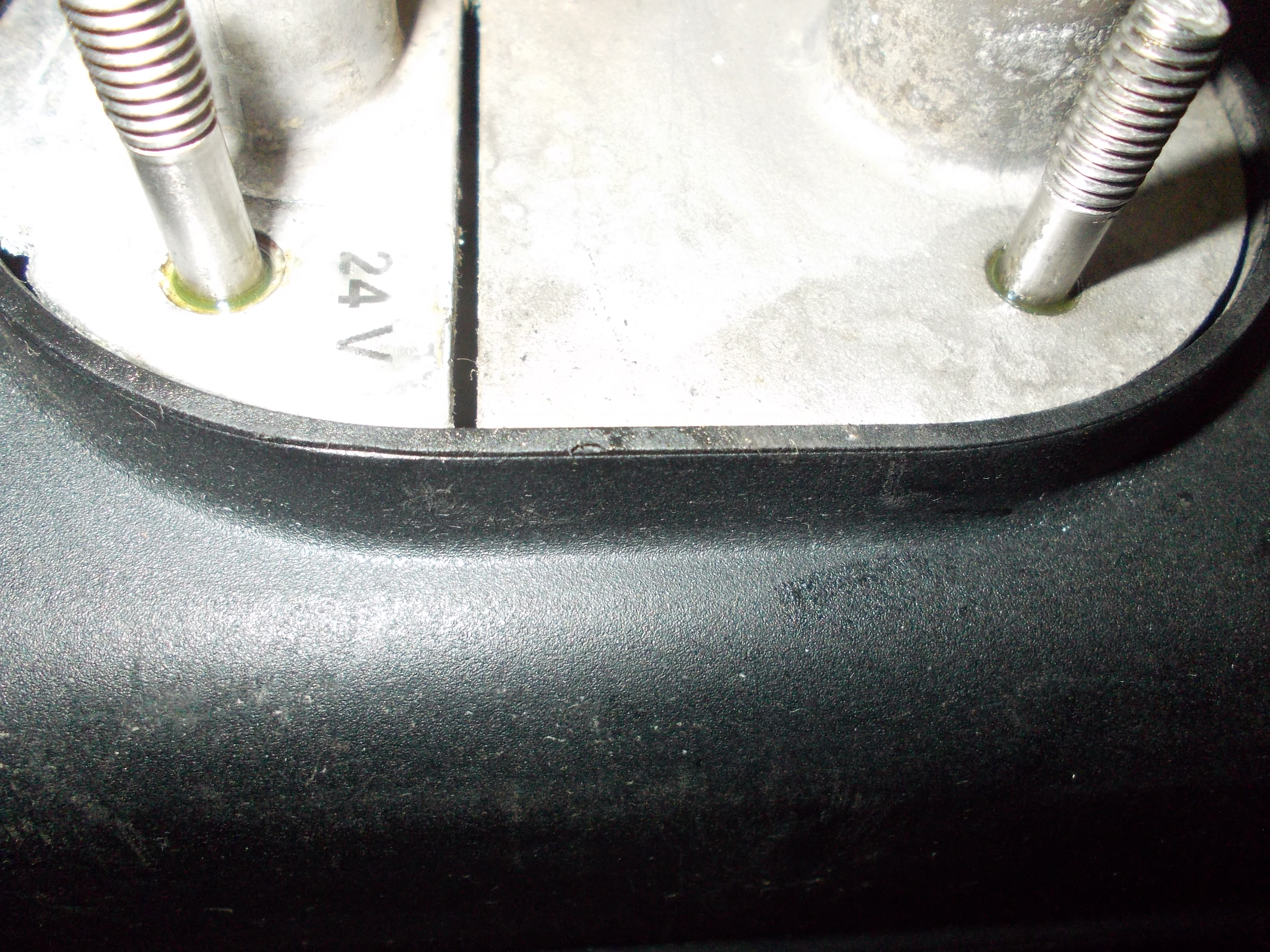

Diesel heater arrived this afternoon. After unwrapping it and checking that all the relevant parts were present I noticed there was some paperwork. Opening up one of the catalogues I found this receipt. As this system clearly has a brand new pump, I presume that it had never been fitted after it had been tested; although that was quite a few years ago.

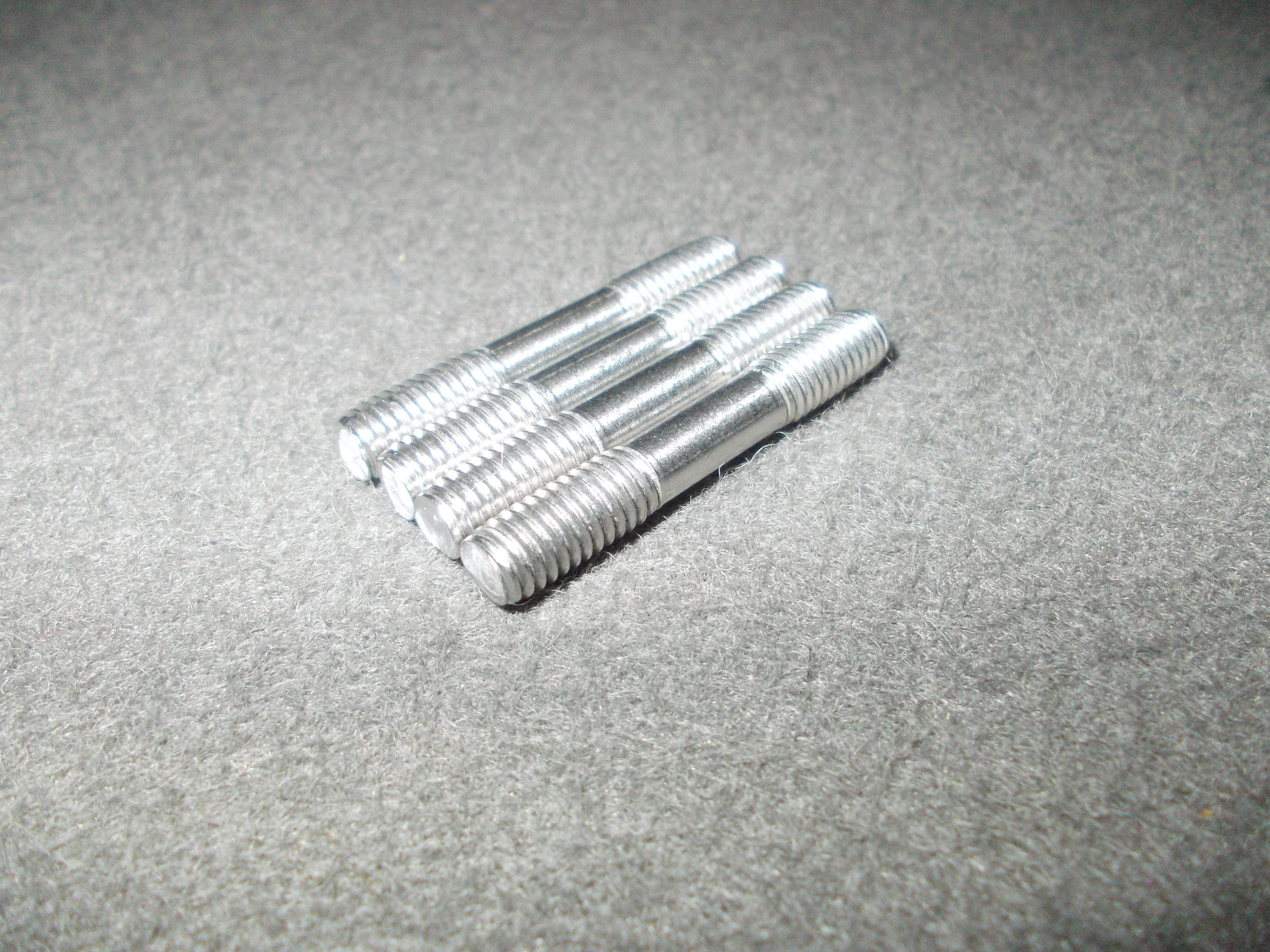

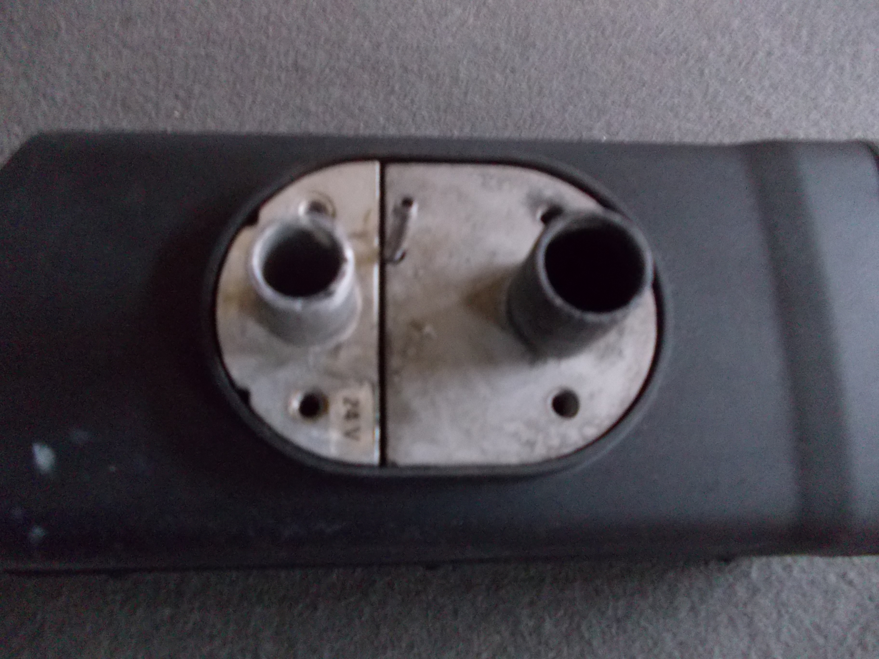

After the initial clean-up, I decided my first job should be removing the four base studs.
And replacing them with four new stainless steel studs.
A dab of Locktite and the job's a good 'un. Hopefully, I should not have any problem now removing the heater at a later date.
Rae

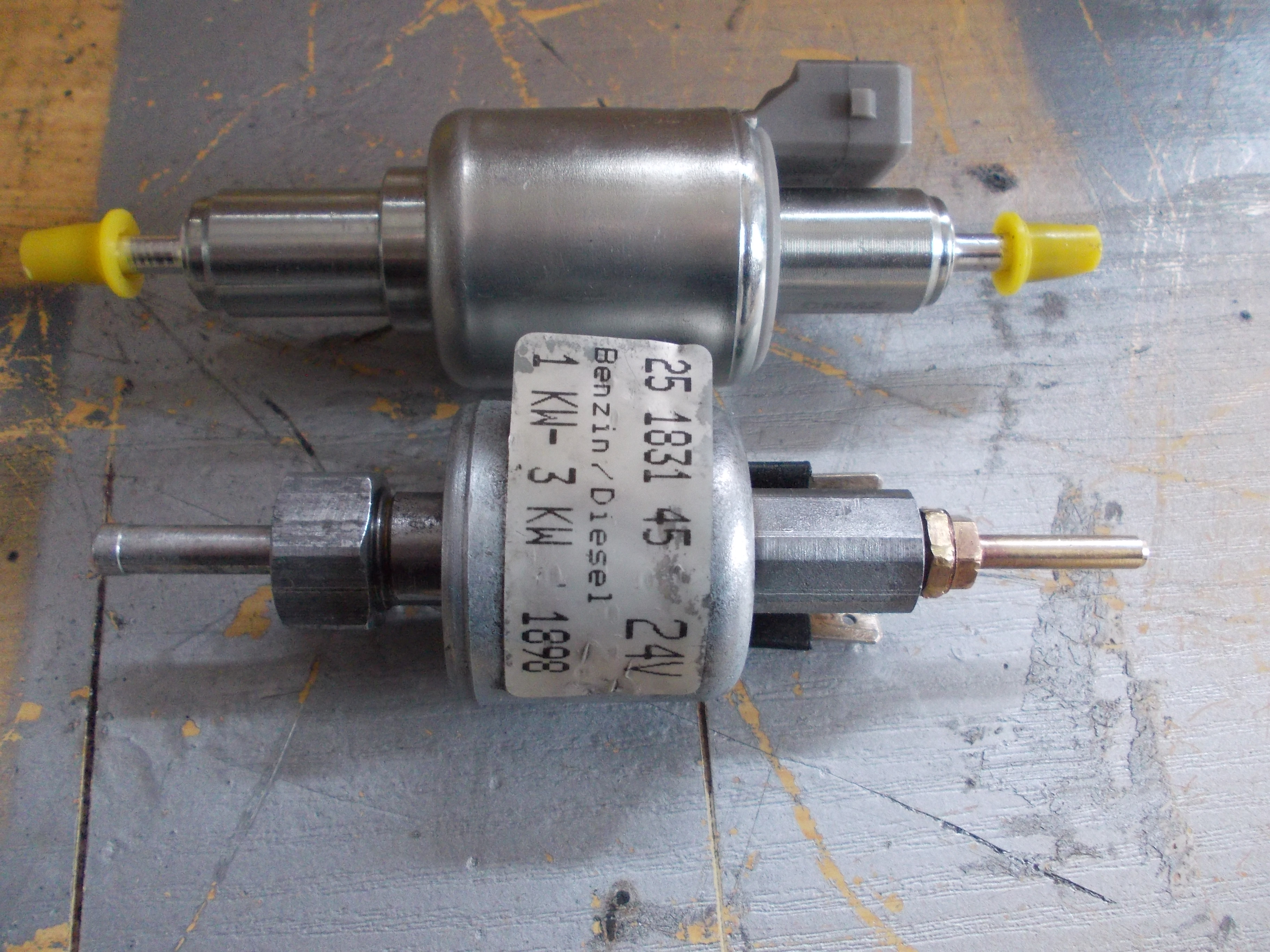

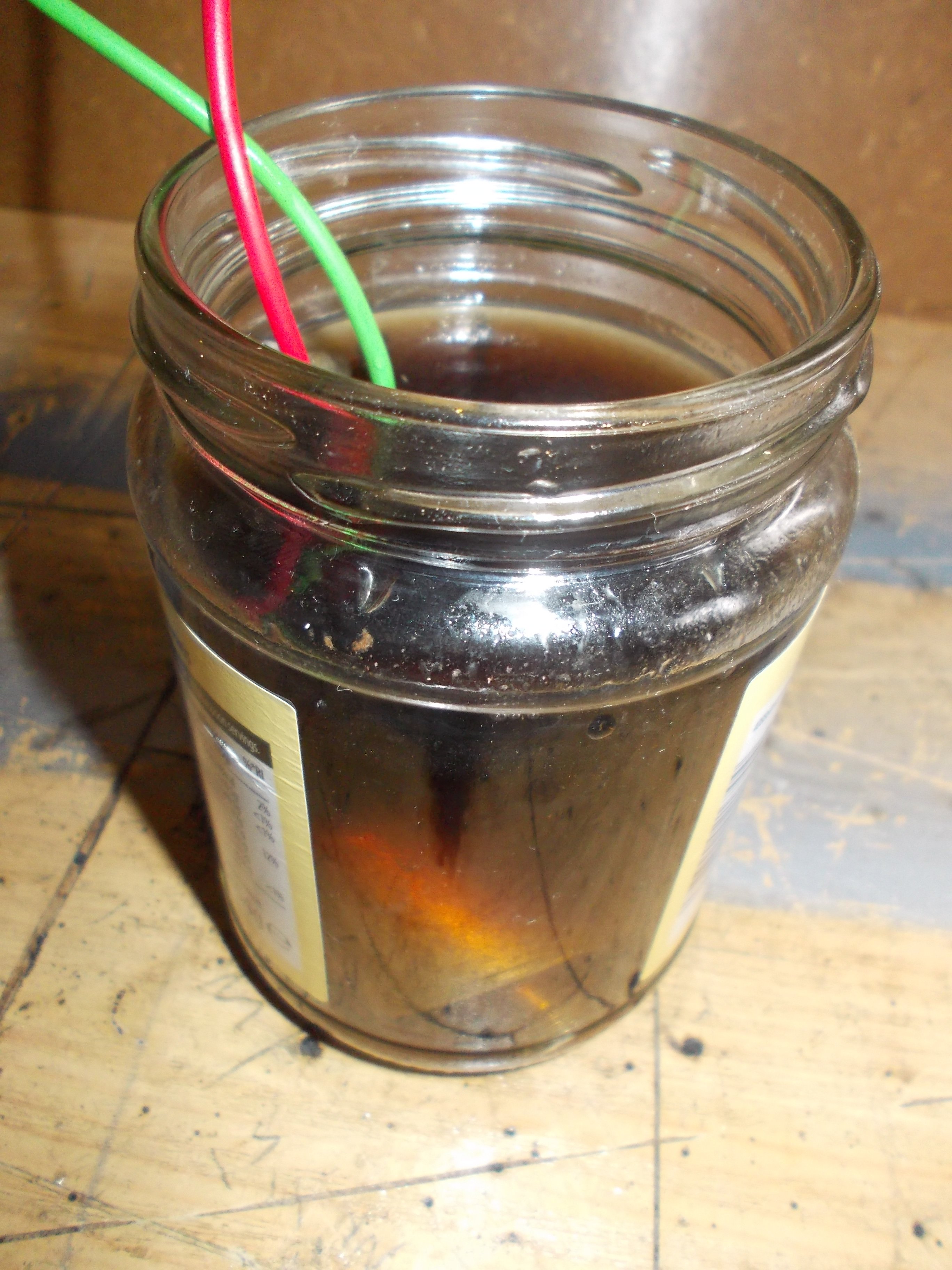

Sorting through all the parts last night I came across, what I would presume to be, the original pump. So without any further ado I linked up two 12 volt batteries and thought I would give it a try; as I suspected, ceased solid. So what I thought I would do, take the both ends off it and leave it in a jar of vinegar. The reason I choose vinegar is it removes rust and is very cheap.

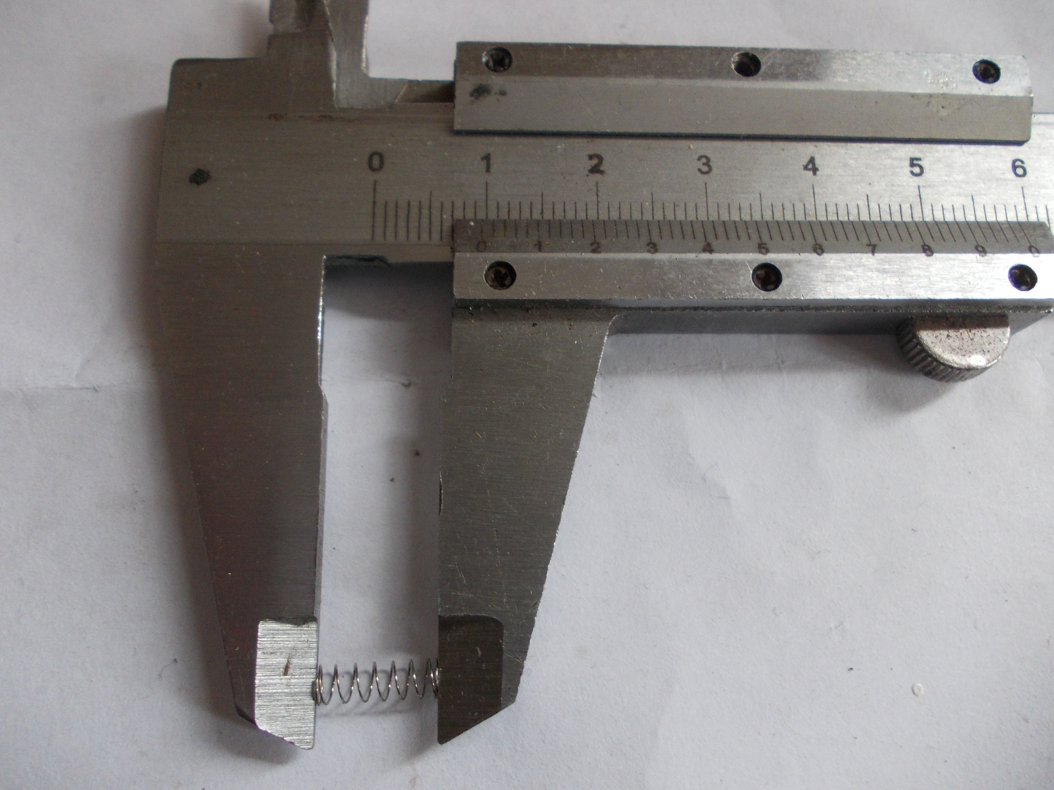

In the morning rinsed it down, went over the outside with a wire brush, powered it up, still no response. I know very little about electrics and even less about electric pumps but, one thing I do know, if you tap them with a hammer eventually they tend to free up and this is what I did and Eureka now we have a pump that is working. My next job was to check the internals, basically a spring and a ball bearing. The ball bearing has to be three millimetres round and the spring 10 millimetres long. Here we have a picture with the spring under slight tension due to the fact I couldn't take a photograph without the spring rolling away but, I can assure you, it was 10 millimetres long.

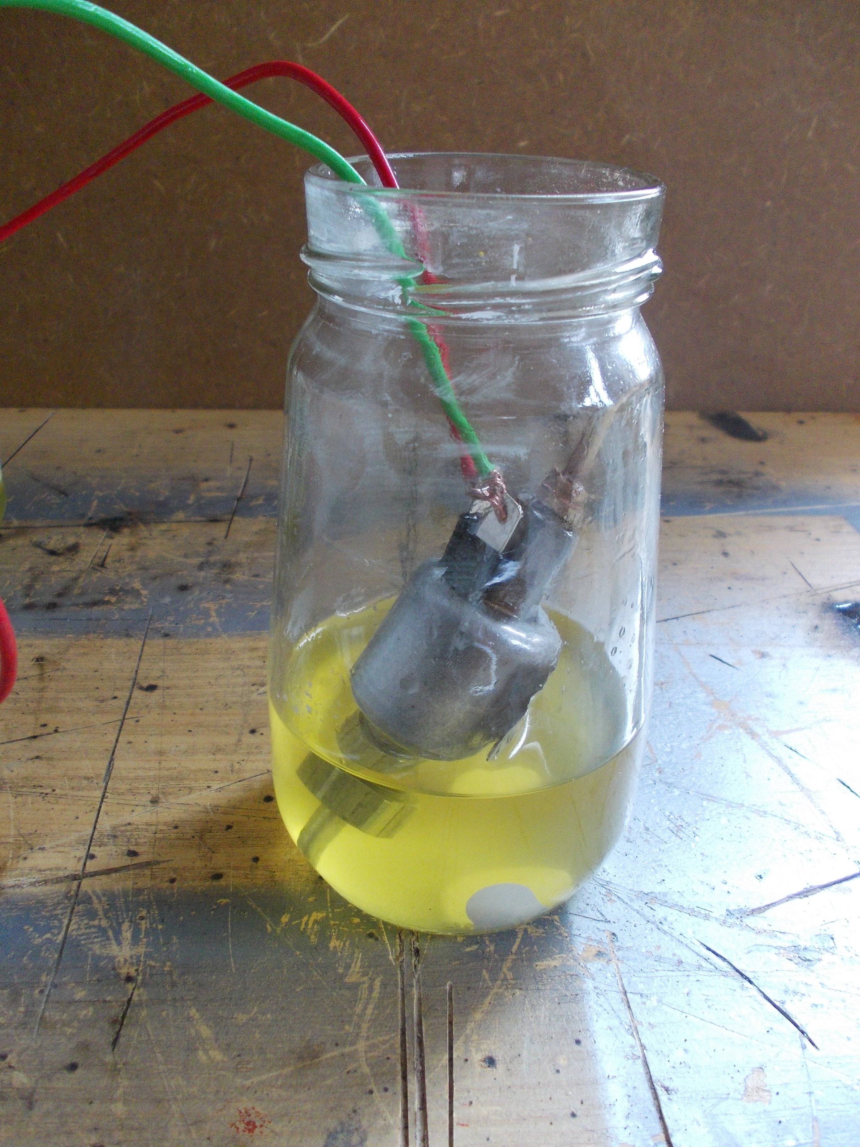

The moment of truth. Two batteries linked together, jam jar with some diesel in it and me flicking the live wire on the positive terminal and it works a treat.

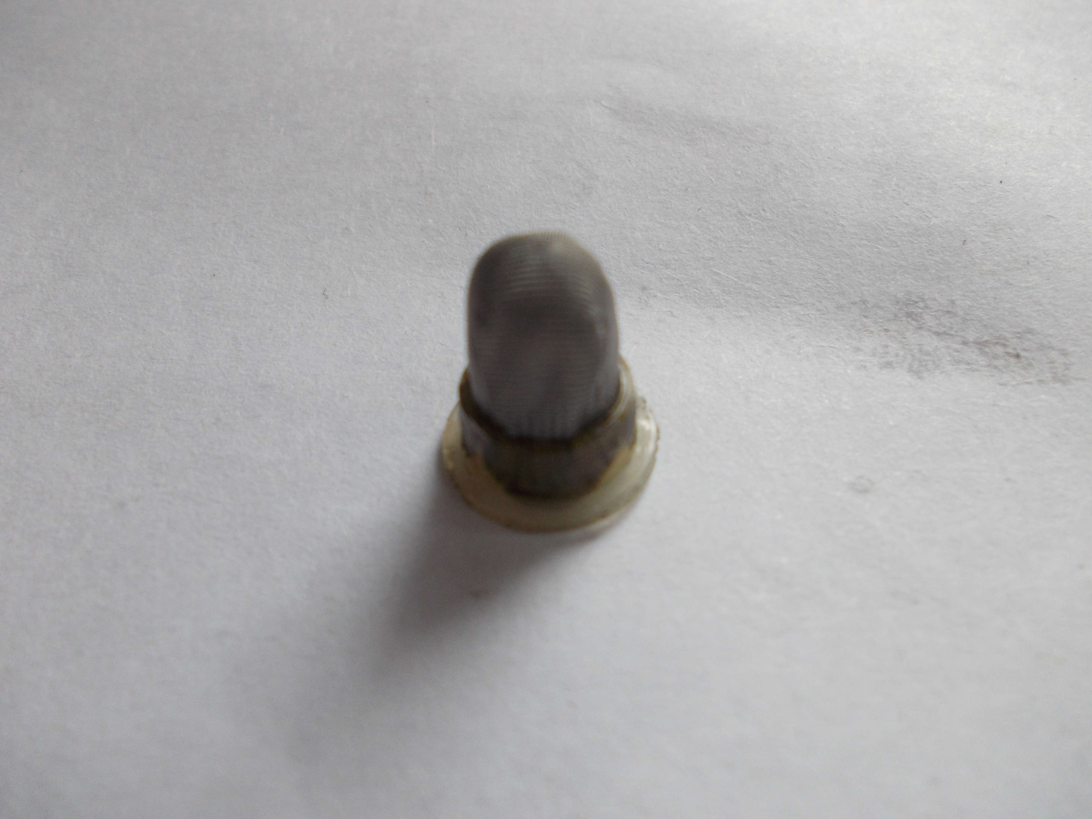

Here we have the filter that is situated inside the pump, from what I am lead to believe, not really needed if you're running an external filter and by cutting the gauze off you can get better results; which I have done in this case.
Here we have a Chinese pump next to the Eberspacher pump. I have run both pumps and I was happy with the results from both of them but the main difference, the Eberspacher pump is a lot quieter.
I am more than happy to use the Eberspacher pump as I believe it to be a more quality item.
Rae

BTW, did you try the 24V pump with a 12V supply?
interesting that the pump is labelled for both Petrol and Diesel. Read lots of comments about kerosene doesn't have enough lube but diesel does and the pumps will therefore fail with kerosene. What about petrols lube quality? must be different to both of those?
