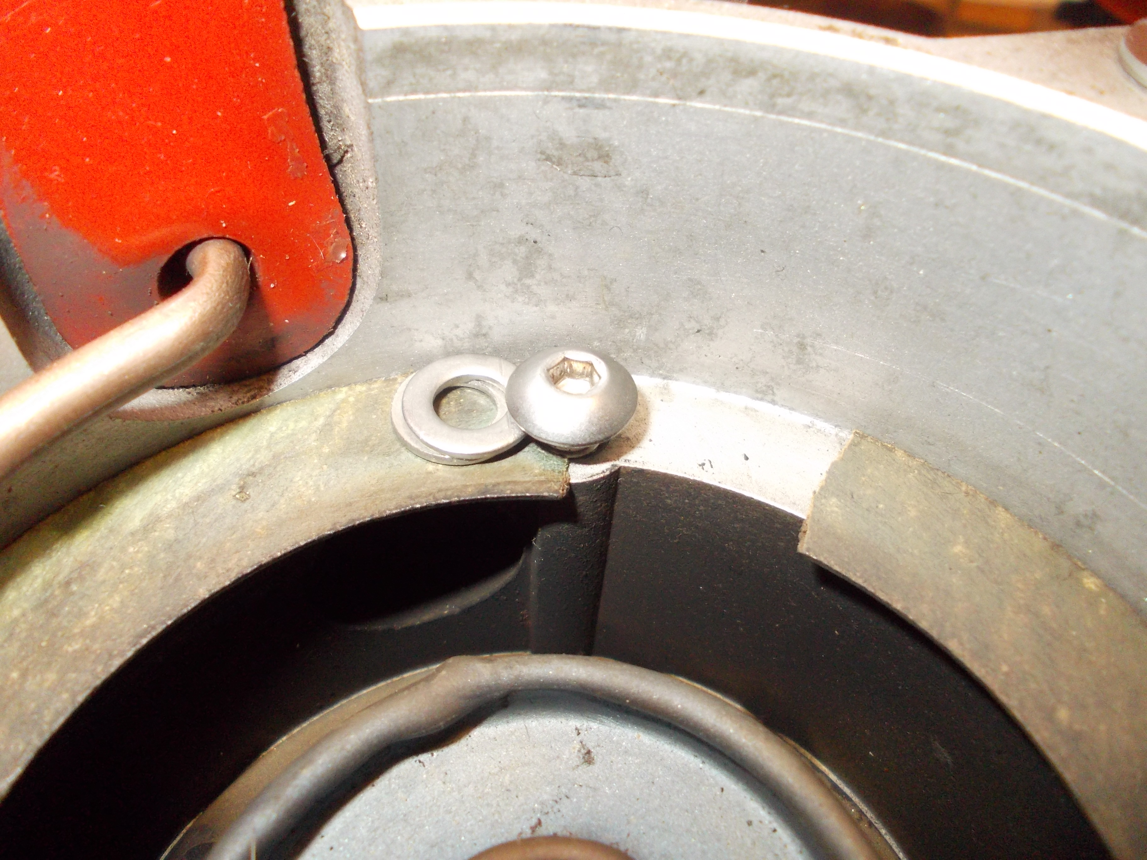

I was looking at the gasket today and I wasn't happy with the way it hadn't sealed and it was quite clear to see that it was not making a very good seal. Now, when I took it apart I remembered the screws were quite tight but in very good condition so the only thing I could think may have caused a problem was that somebody had replaced the screws with slightly longer ones. Basically, the plate is three washers thick so I decided to cut my new screws two washers thick.
As you can see from the picture, had the old gasket in place and with the screw fully screwed home I could squeeze two washers under the head.

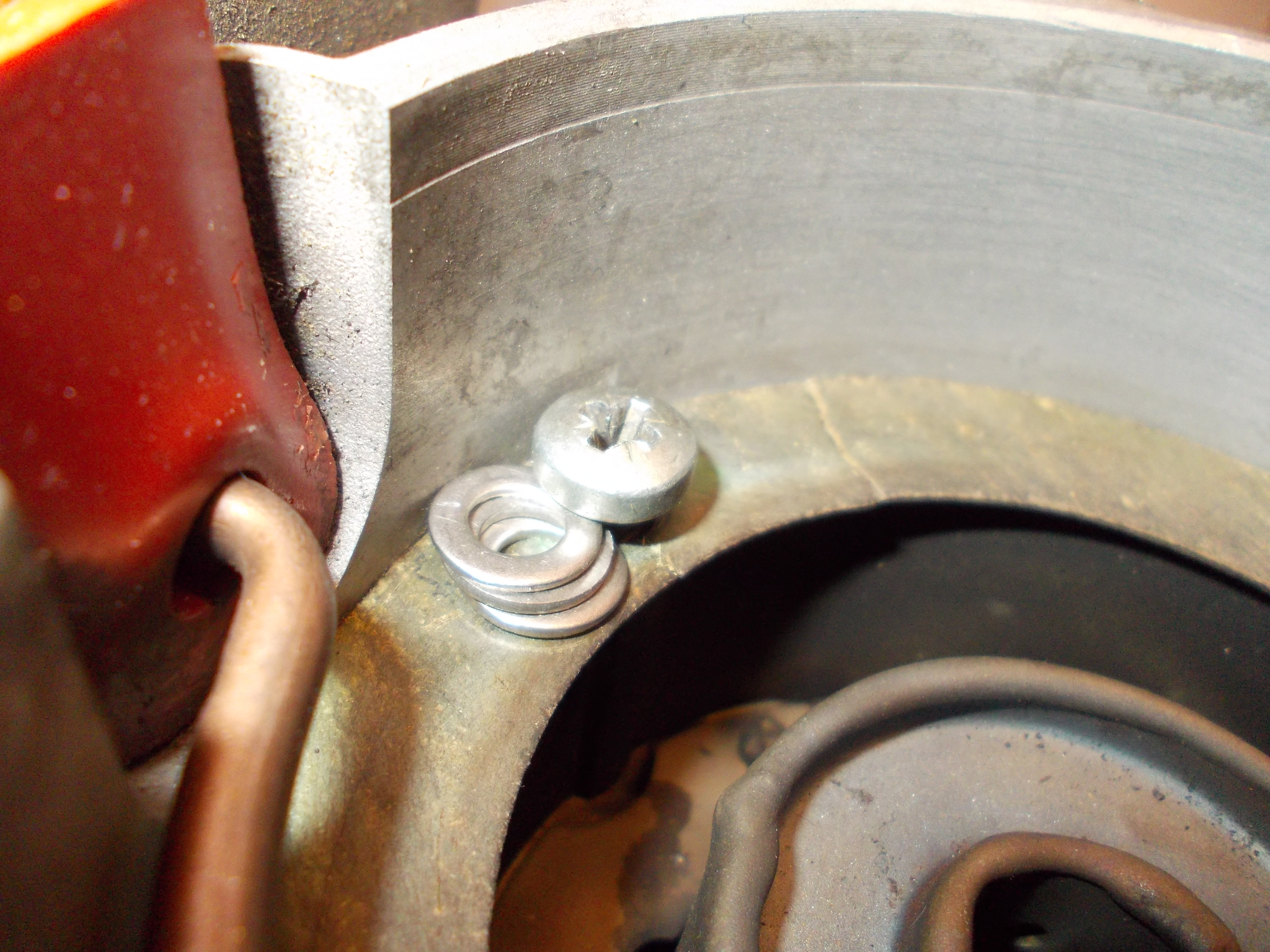

This picture shows the original screw, I can quite comfortably slide three washers under: they are only stepped for the purpose of the photograph.

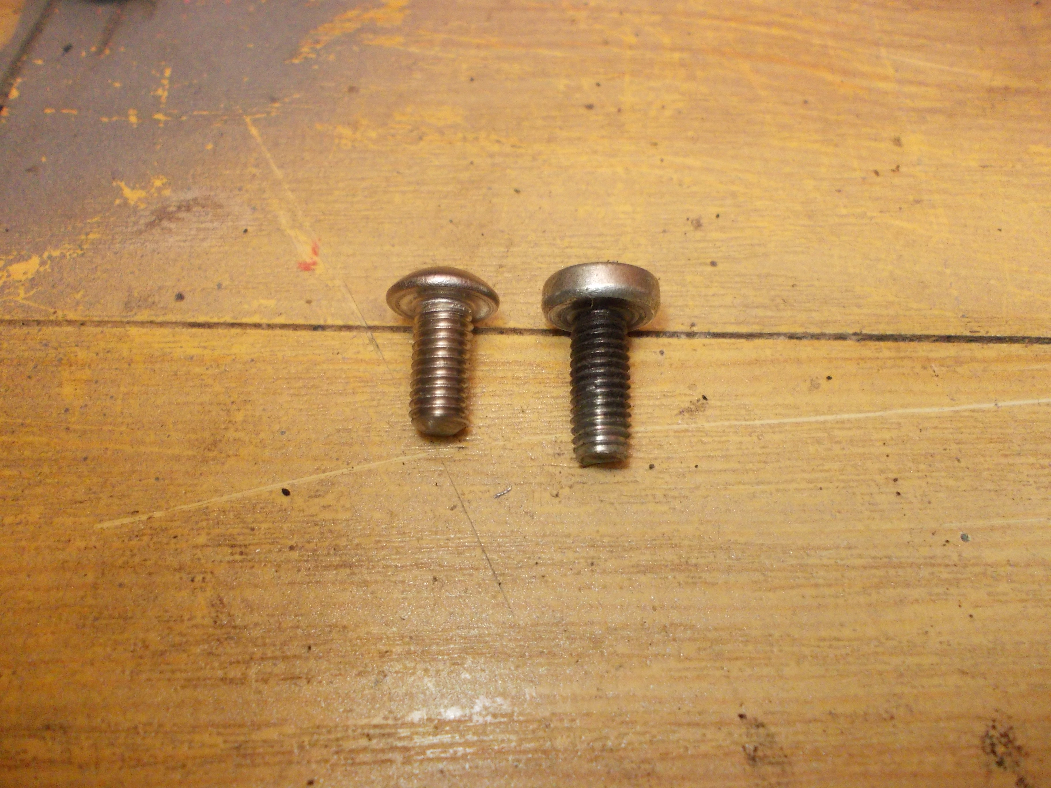

This will give you some idea of the difference in length. I believe this would make a large contribution for why the heater was not working.

Well spotted Rae. (y) Strange that anyone would fit overlong screws, and why :unsure:.
you can buy screws of any length so if someone bought a replacement after loosing the old one or knackering the head?
Possibly it broke the end off in the shaft (Maybe heat welded the tip to the housing?) and it is now effectively a shorter shaft to fit the bolt in?
