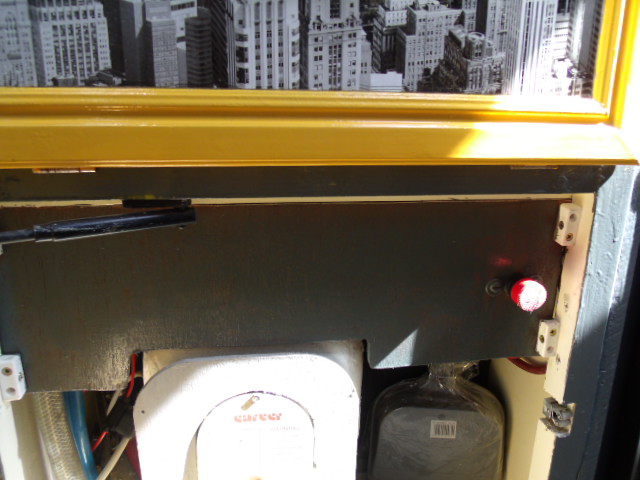

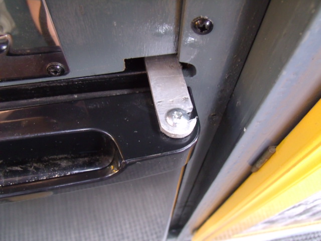

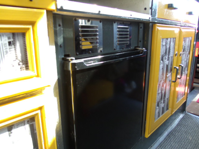

Small counter top sealed units work well, no vents required, though I fitted them anyway. and 250mA power to run it.
