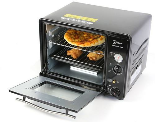

Much better to use a small table op gas oven, yes it takes longer to cook but so what, that's what I have and cartridges are easy to get.
