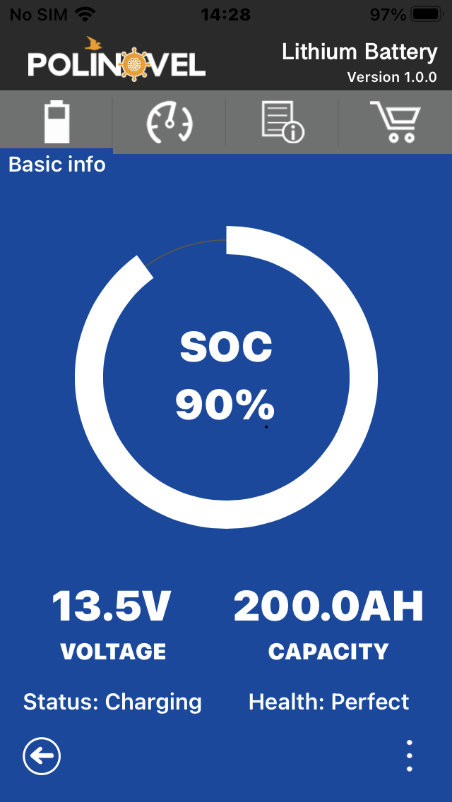

Battery was full yesterday morning, ran it down to 79% by late last night and now back to this with just the solar. Light tv use and charging iPads and phones only today.
Spring is on the way šŸ˜Ž highly recommend lifepo4 though.

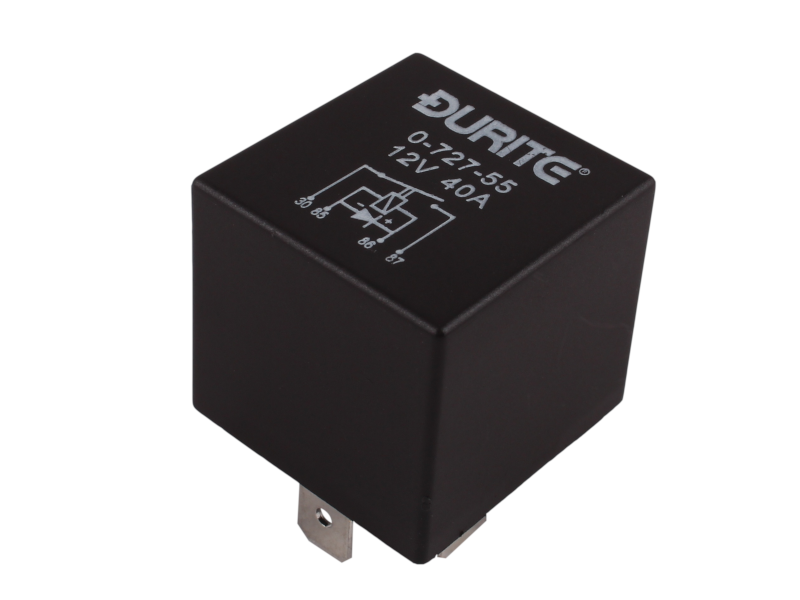

I have looked into it and discounted the idea as I only have a 100 watt panel on the roof. I am considering using the AES output to energise a relay and add some USB sockets. This is the relay I have been looking at.
Switch to a small compressor fridge and run through a smart soft start inverter.
No problem with the big fridge/freezer Trev. I even got the solar regulator that you are always pushing on the forum. I hope your commission is good. :LOL: These days many appliances run off a USB supply and extra USB sockets are handy to have.
