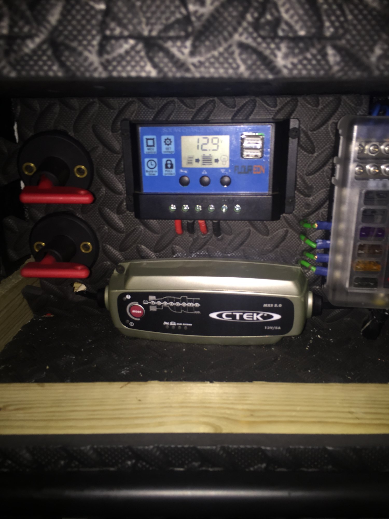

I’ve only got a cheap as chips Controller that doesn’t show Amps, & to be fair, I generally go by what voltage is in the Battery rather than what amps I’m pulling in.
But this morning I started on 12,4 & at the moment I’ve got -

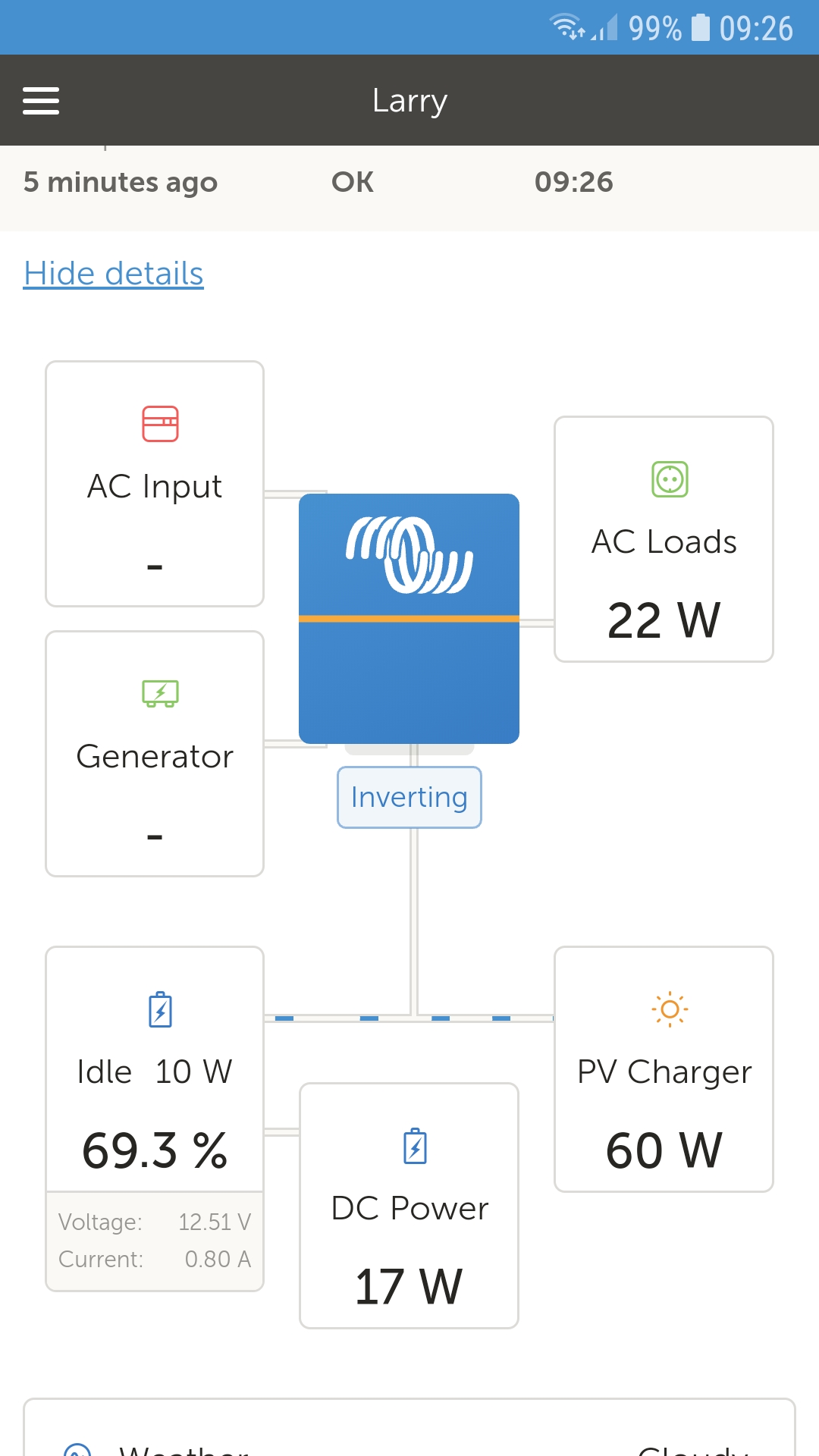

Sooo, what will I get today? 0900 and it's just about breaking even.

Would it be possible to maybe ‘Draw or Mark’ that diagram into more ‘Dummy Explanation’ of what’s happening some members might find useful.
Or Not 🤷🏻‍♂️
Bottom left: battery. 12.7V, and the current reading is what's in, or if a negative number, out of the battery. 0A right now.
That doesn't mean nothing is on, because the bottom right (PV charger) the solar panels are making 50W.
That's being used by some 12V DC stuff, the bottom middle 36W. That's the monitoring things and camera's at the moment.
The rest of the 50W the solar is making is going to the inverter and being turned into 230V AC (17W top right) that is powering a 24V battery charger that is looking after the engine batteries.
It has looked at all the power that has come out over night when the sun was down and it knows how big the batteries are, so it calculates that 86.7% of the batteries is left.
Hope that makes sense :)
