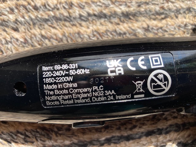

There’s you answer Marie, the powerbank you listed won’t run your hairdryer, you need to find one with 2200W continuous output or above. Won’t be cheap.
Maybe look for a lower powered hair dryer?
You'd need a big inverter too for that one cock.

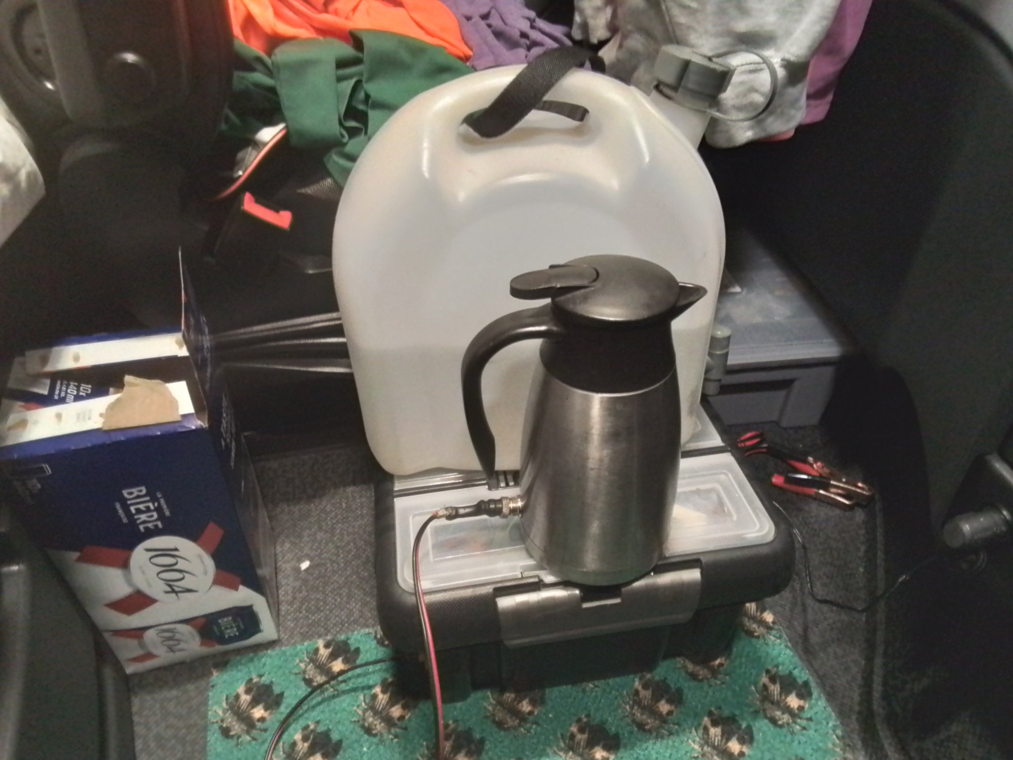

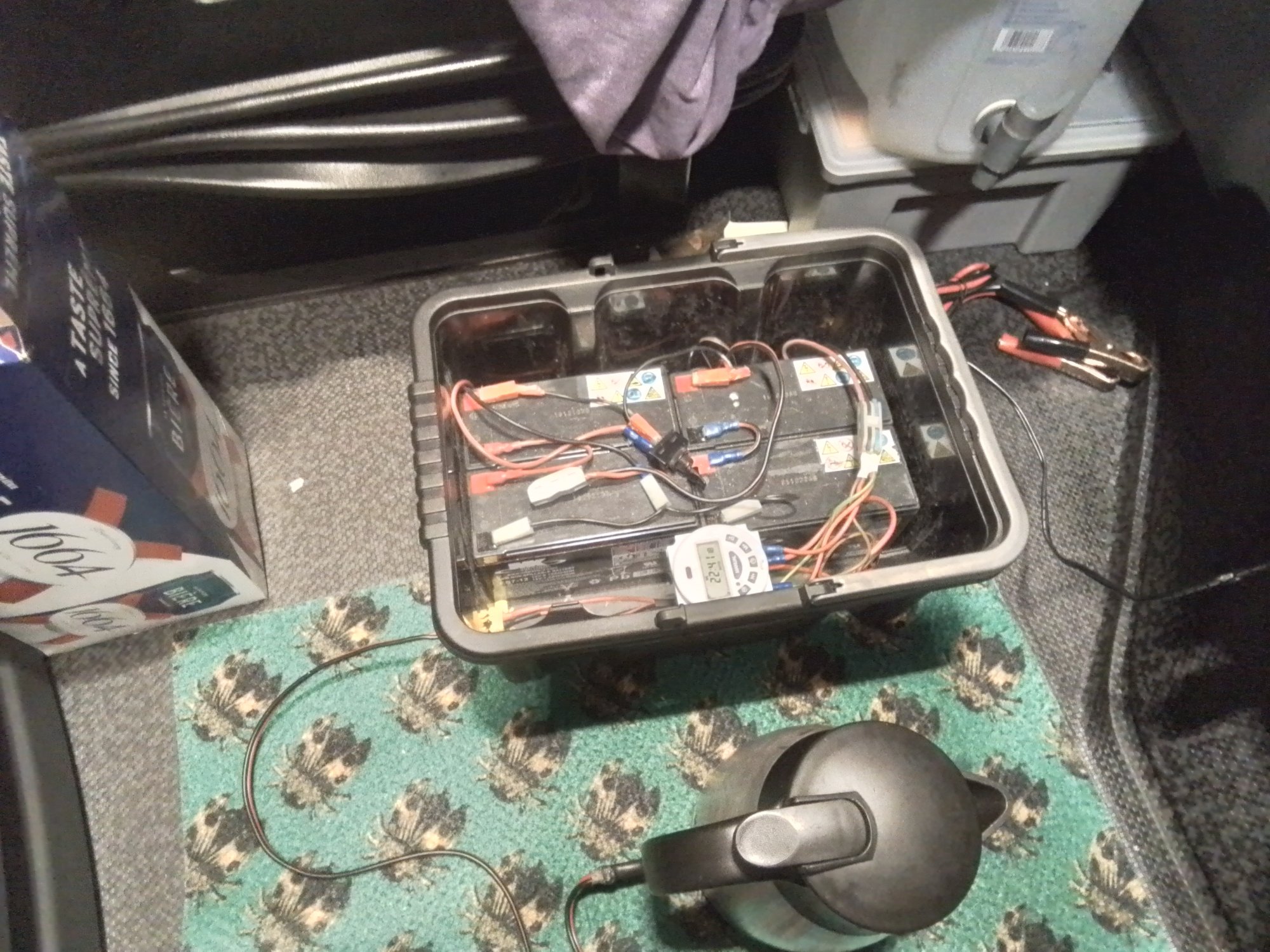

My solution for my 24 volt kettle in lorry is as pictured . If the lorry broke I'd leave all behind.any thing is better than nothing. But ! the van, I'd push it home.
28 amps out of scrapyard, £ 10.00 plus box there just alarm batteries. And lorry changes them. Had them since Christmas. No not a present. Lol
but will run em back in.
