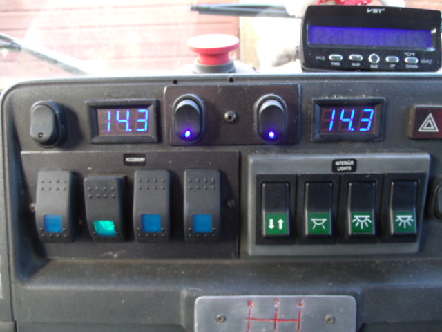

You should really label your switches TrevorI also have two voltage meters on the dash, one for starter and one for less batts, gives a good general idea of charge both stationary and on the move.View attachment 109426

Yes does all batts.Yes but my controller also has several settings for various battery types but the question was does it have one that charges at 14.8v which seems to be the sticking factor for most chargers with AGM batteries? Having said that, so far so good with this one. Even if its only operating at say 80% capacity and stays that way so far its pretty impressive. The test will be over the next few months and into September. Both of us are sat with Laptops plugged in right now, two phones in the invertor on charge on fast high powered chargers, couple of showers in a bit, then out for the day before an evening of TV or watching stuff on the laptops. I bet the voltage at midnight is still hovering around 12.6. So much daylight hours this time of year you can pretty much act like your on EHU. It was September we hit issues last summer but the old battery was clearly goosed.
