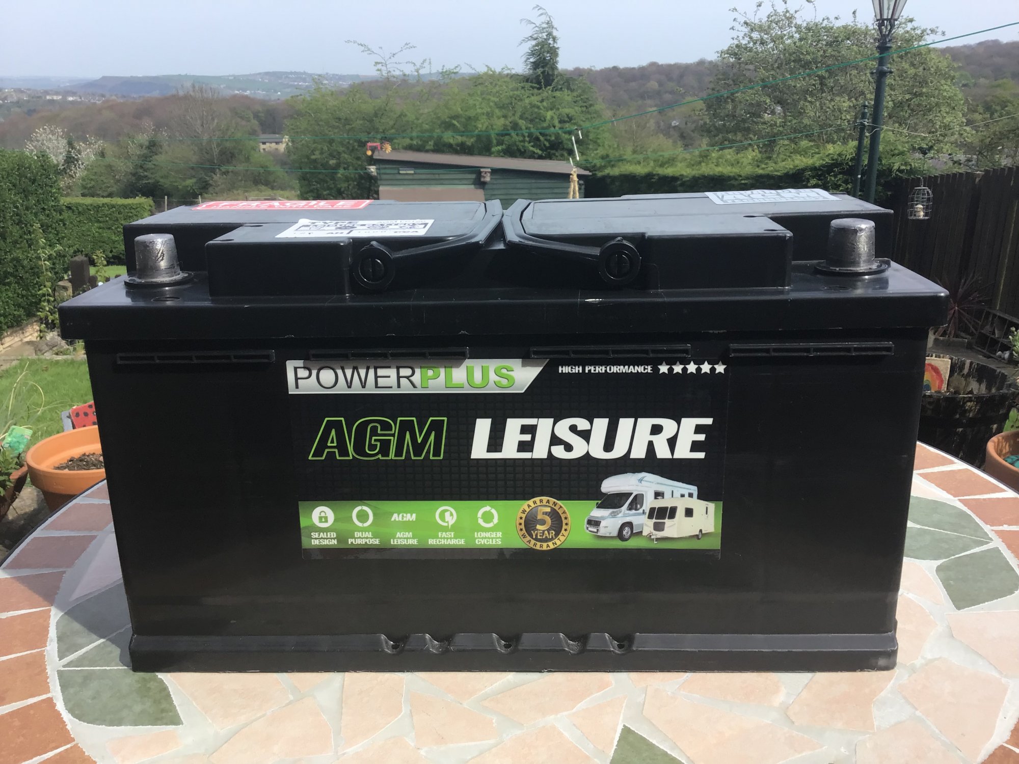

I have this agm 120ah that I bought about 12 months ago for a project that I never got around to using
That I probably never will so if any good to you I will let it go for £50 I have kept putting it on charge every 3 months or so, not that it ever needed it
If I remember rightly I think I paid £145 for it
View attachment 107852View attachment 107853
being an AGM, it doesn't need to be totally flat, so I wonder if you could put it at a bit of an angle and rest it on the frame support on the right hand side? or even make a little platform so it would be level with that support and give you what is maybe 30mm extra width, which might make just the difference you need if tight?Richard kindly dropped off his unused AGM 120ah battery last night. he got a job up in Scotland so came back via our village to personally drop it of for which I am very grateful. For fifty quid its got to be worth a punt. If its no good for my van ill pass it on to another member for the same price. Vans not here right now as its away getting MOT advisories done but as soon as its back (if it fits) ill get it plugged in and see how it goes.

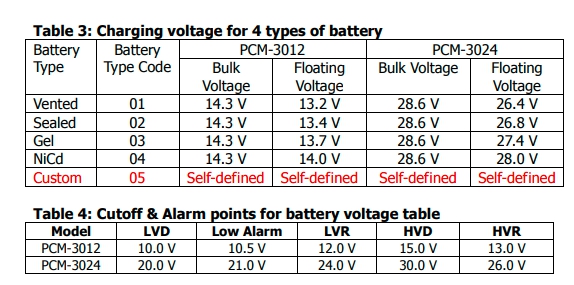

Cheers. I'll have a look when the van returnsThe way to do it is look up the data sheet for the battery to check what the specs are and use option 05 to set the parameters to those two key numbers of Bulk and Float. If you don't have that info available, I would use the Sealed or Gel options.
And to be pedantic, the voltage in the first column is not actually the BULK voltage, it is the Absorption voltage. (Bulk is CC - Constant Current, where the voltage varies, but the current is constant; Absorption is CV - Constant Voltage, where the voltage is constant (and set at the number defined) and the current drops down as the battery gets charged).
Certainly is looking goodLeft the TV, Satellite and a couple of lights on for four hours last night as a test and straight after the battery was hovering between 12.5 and 12.6 so all is looking good. I think ill maybe just leave the controller as is on number 2.
