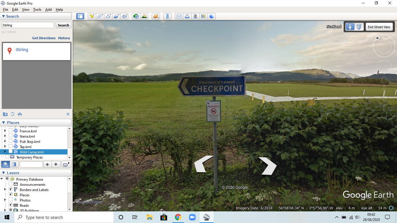

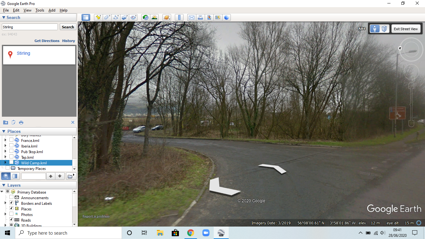

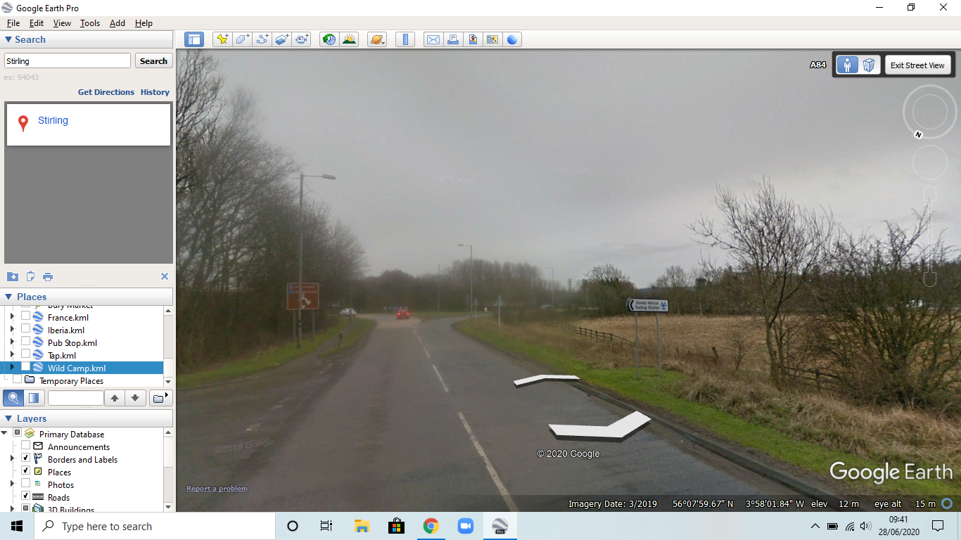

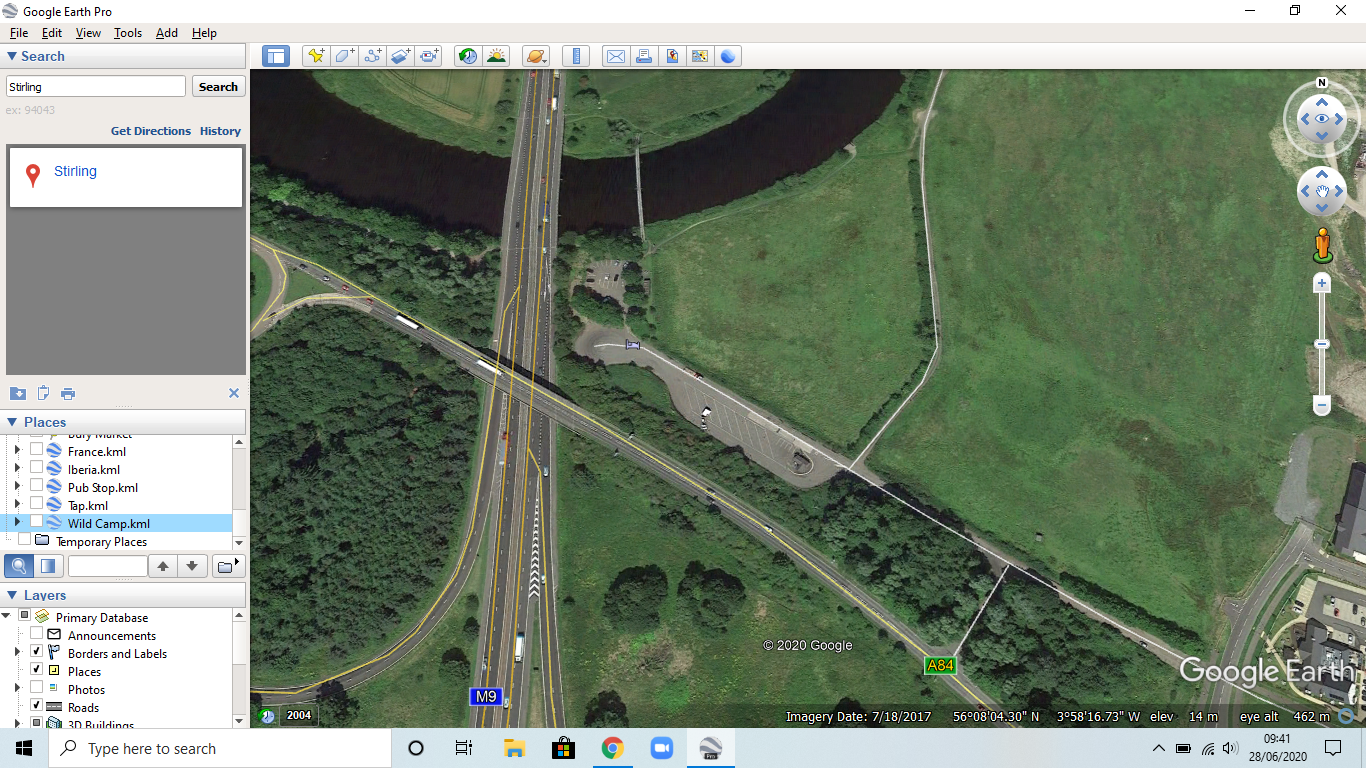

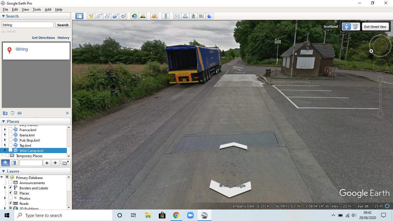

This is brilliant pal. Really appreciated. Didn't realise such places existed. Will visit as soon as back on the road for reassurance.It is right on the junction of the M9 ( J10 ) and A84.
1 Ariel view, 2 view from main road, 3 view of entrance, 4 view as you turn in, 5 view of the actual weighbridge.
The readout is at the top of the short pole with the instructions taped onto it and the dynamic weighplate is in the foreground of the last screenshot ( 5 )
Have pen and paper ready unless you have a very good memory, it will give you 3 readings, front axle, rear axle, total gross weight.
Thanks for yr help, appreciated!Yes, it’s the other side of the junction on the left.
