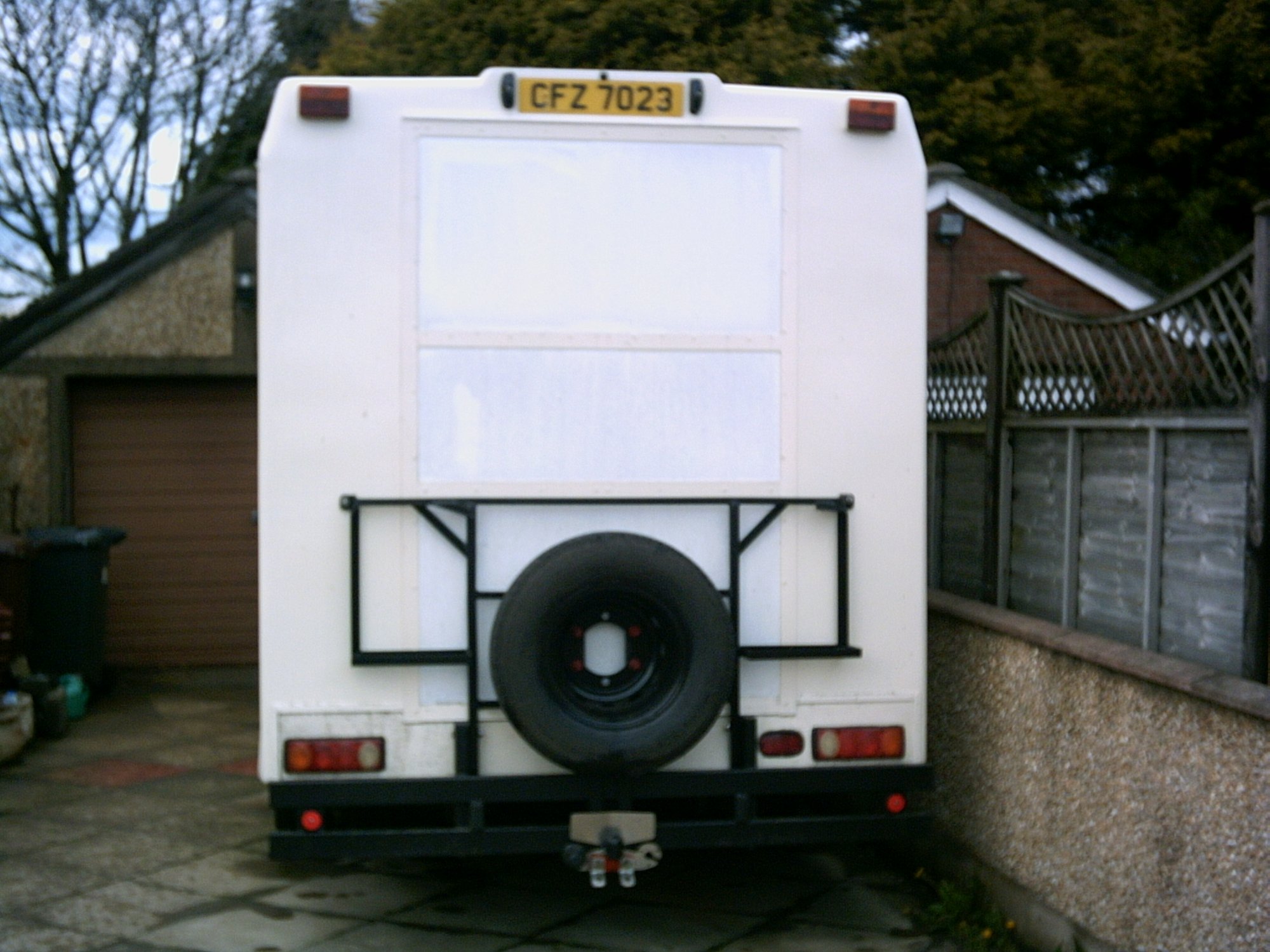

Never seen t bar testing and I have made many like the one on my van.
Towbars fitted to motorhomes first registered after October 2012 have to be type approved. The DfT don’t expect the tester to check the type approval label though! 🙄. They do however, have to check the electrics, but only if it’s 13 pin!
At first they tested the electrics but last few years gave up from what I seen.
