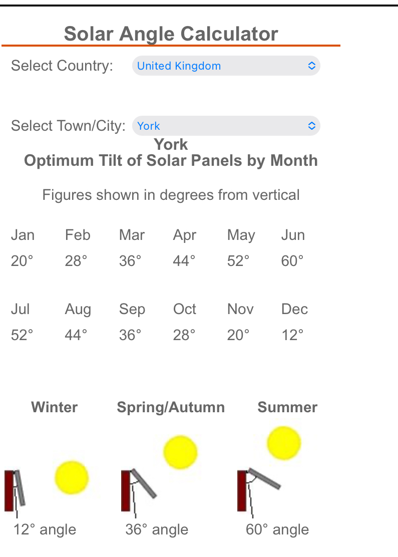

Interesting and obvious. Not just yorkshire, wonder what the stats are for places such as Malaga Spain?At the latitude of York a vertical solar panel can gather more sunlight than a horizontal roof mounted one for more than half the year.

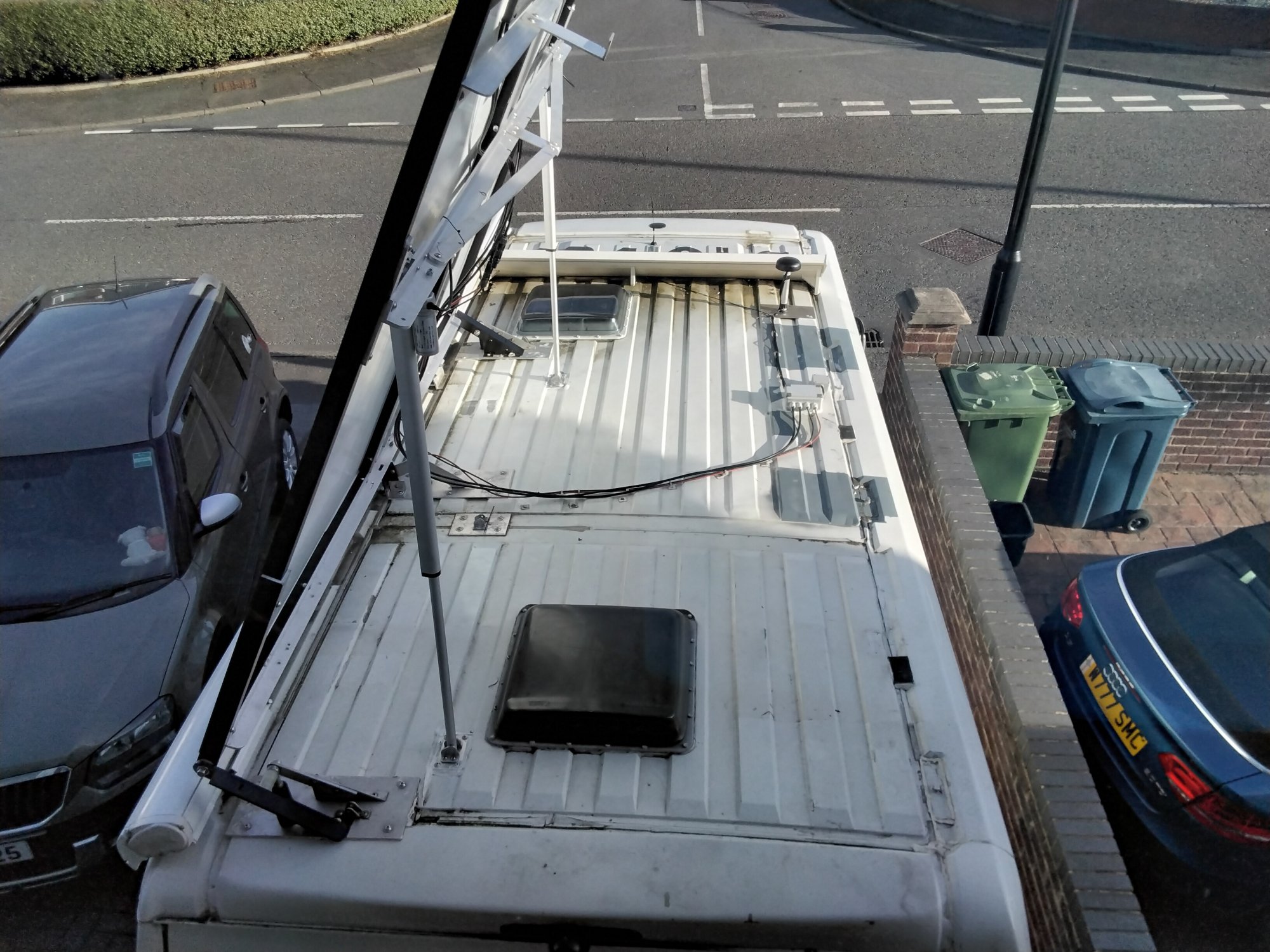

The other advantage I've got I can remotely tilt my panels up at any angle soo winterm9nth I can still get a good few ampsLUXURY.Ive actually got by on two 100w panels flat on the roof for the last 12 years,summer an abundance of power but between november to late feb I would ration the leccy.It can be done.Now though a 100amp lithium which I run and charge from a friends house is proving excellent.The two flat panels now are solely for keeping starter bat fully charged.The two verticals are for when im not parked in city.Your setup Windsurfer is what I will be putting on my next home hopefully this year or something very similar.
Is it solely the gas struts pushing up the panels.The other advantage I've got I can remotely tilt my panels up at any angle soo winterm9nth I can still get a good few amps View attachment 126906
Ahh,googled and now l see.They are linear actuators.
Thank yiu Steve lololThey are linear actuators.
