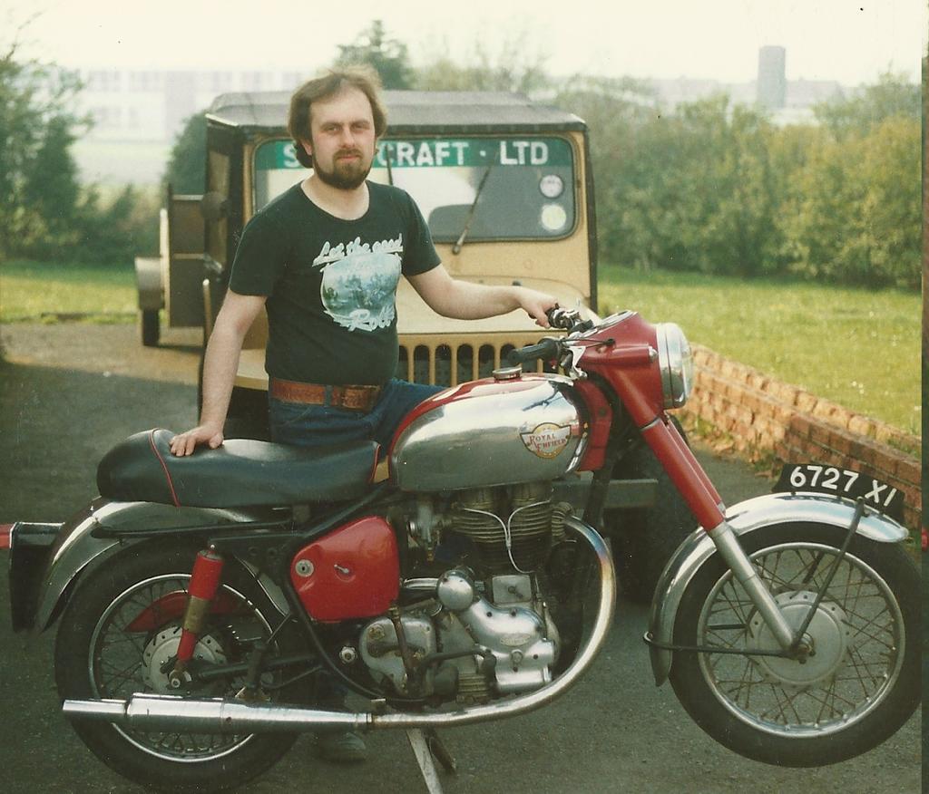

M/cycle chains these days are sealed and oiling them atracts dust/grit which wears them out faster.
That's not quite true. X ring and O ring chains have grease 'trapped' in them but still require occasional lubrication. We use non o rings on our KTMs and they require constant lubricating. Obviously a lot depends on the conditions you use your motorcycle.

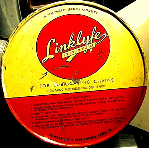

In the last 30 years chains have been o ring sealed and only require a wipe over with a almost dry cloth containing lite oil.
In days gone past you removed the chain and boiled it in a tin of duckhams chain oil wiping dry on outside before refitting to bike,hope this clears things up regarding chain and lubs.

LinkLyfe boil in a tin lube, now that would stick to the bottom of a motorhome

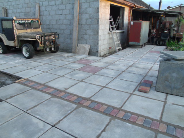

The trouble with a rubbery coating is that damp can get trapped inside it.
Thats true as when peeling back some on my old soda to weld rust holes were below.
No rust on my old f/glass jago jeep kit.
