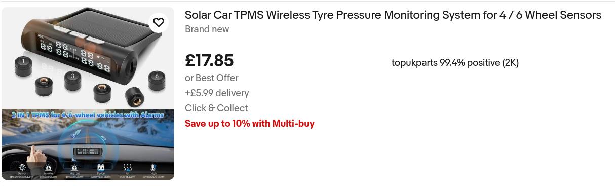

My cheap ones of ebay have no problem with 80psi, i had to buy a six unit as im double back wheels, do remember they only come into play when you drive.

Correct just like mine, you can if you wish use a power plug, i have never required it, only thing drives me bonkers is that it beeps like mad if a tyre looses a few pounds of pressure or goes up due to heat on long runs.
Are these the ones that work from the dust cap replacement?
