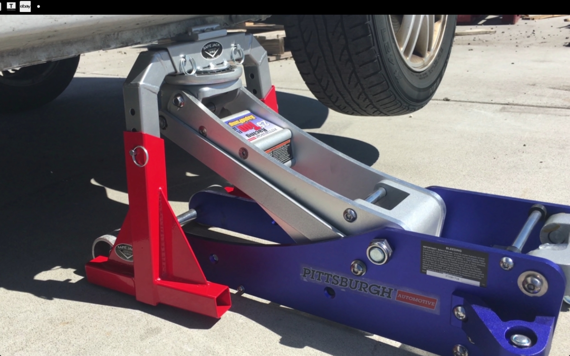

On the subject of Jack stands I use these, marketed as “safety Jack stands” I’ve had them a few years now and they have been invaluable for working under the vans fitting water tanks etc. Each is rated at 5 ton and as can be seen in the second picture they have spring loaded locking pins which raises the vehicle up by another 6” or so

Yep very useful to, I bought the above thingies after buying a BMW F11 and realising my Halford ramps were too steep and fouled the front bumper when it was time to change the oil etc.

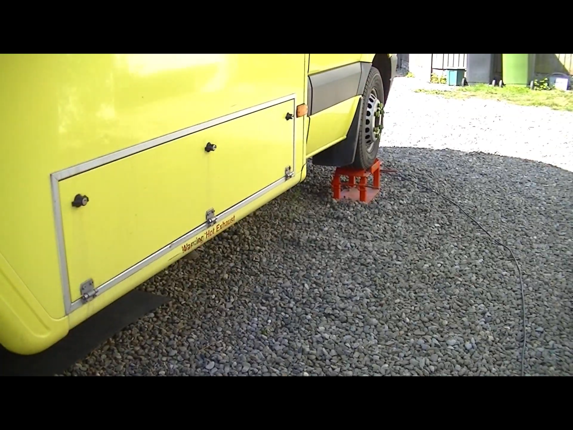

They can take the weight of my Dually sprinter as well which was handy when I needed to overhaul my Telma Retarder and one useful feature, due to the flat base, is they are even ok on gravel .

Jack stands not sure if they are new or not taken , from YouTube

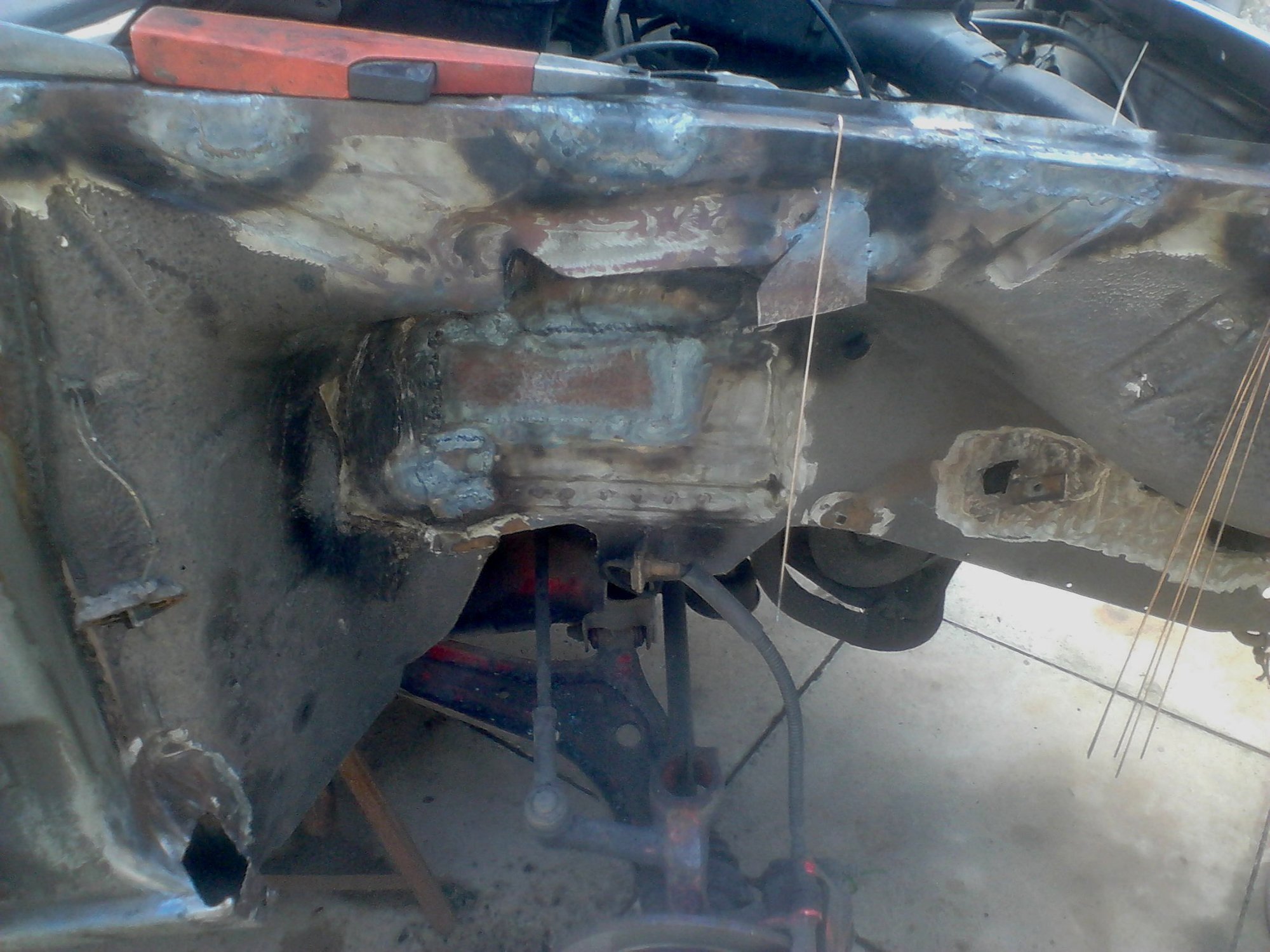

Usless as the on the weal sills, always jack on a suspension part like the wishbone/chassis if possible, many a sill iv seen collapse under load.

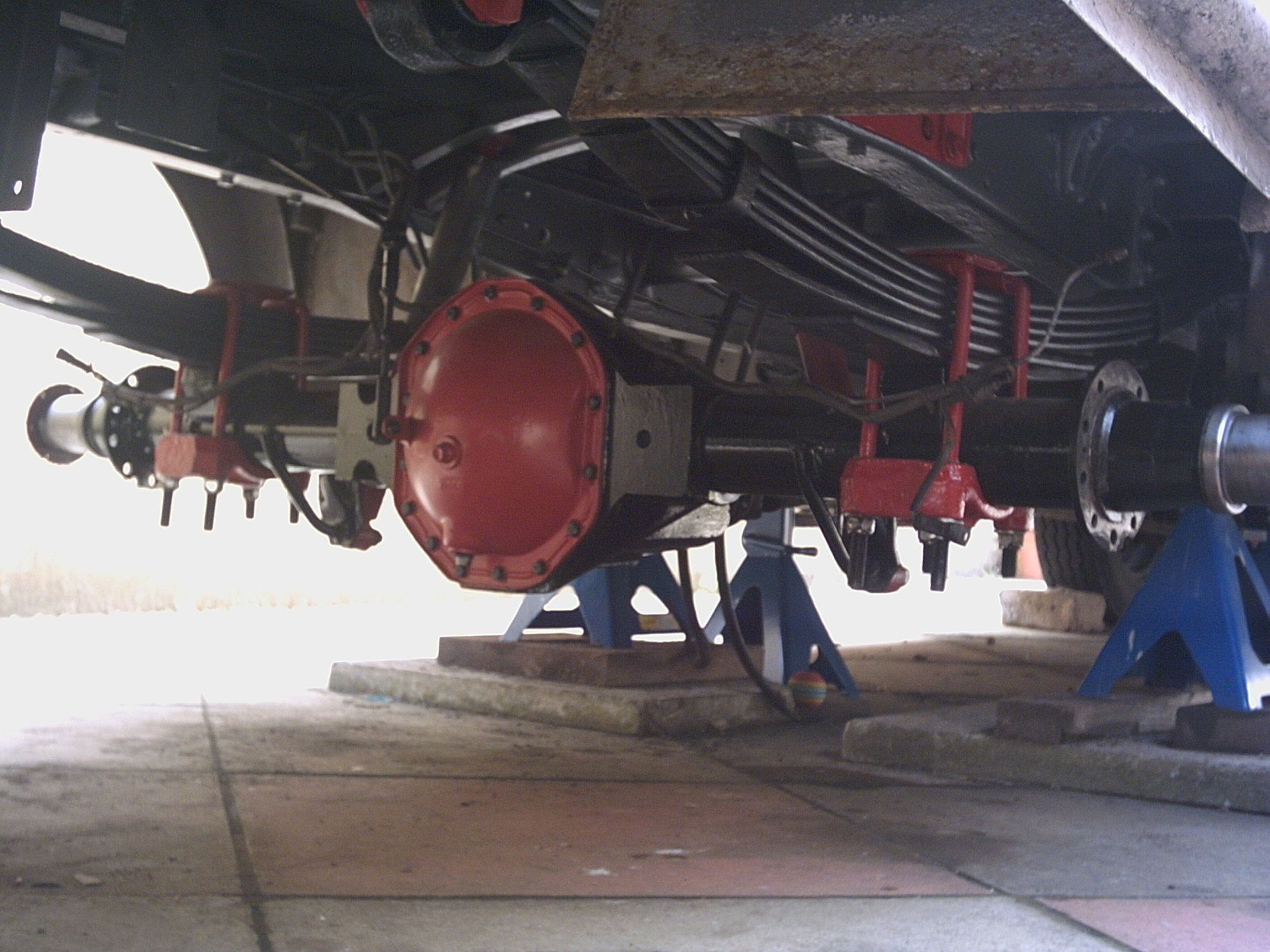

I wouldn't jack up old scoda on the sills either ,truck looks good though,
Saw a chap jack a newish Fiat up on the sill for it to fold up inside, shitron and renault are well known for this too.
