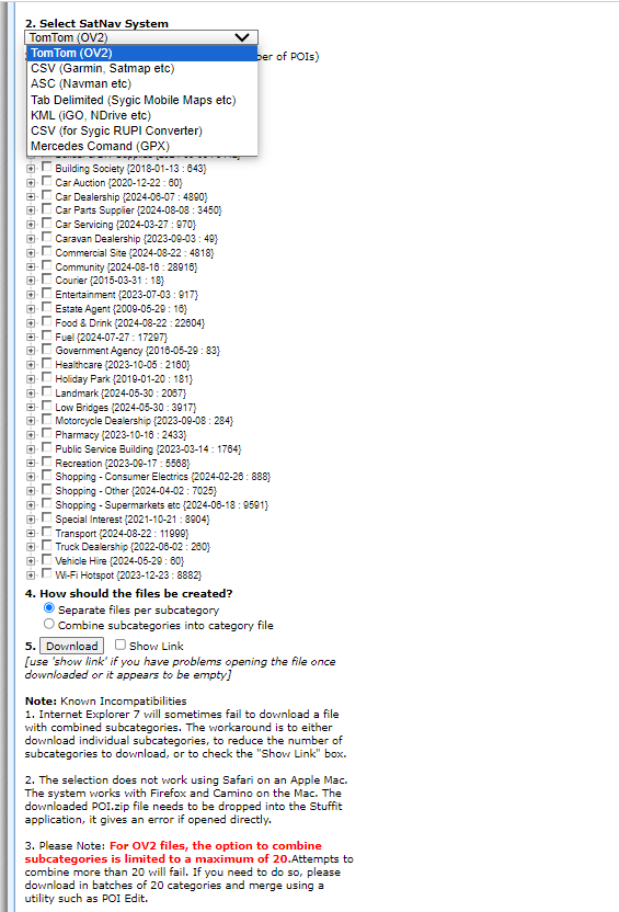

I have the TomTom 5200. They are available at £200 ish. I have downloaded poi. Its wifi or usb uploadable for updates and poi from TomTom my drive. You can set the size of your camper into it as well. I also have low bridges poi installed as I carry kayaks on the roof too.
OR maybe get the .ov2 file and upload through my drive e.g.
You can import POIs to a TomTom device using MyDrive:
  1. Open MyDrive
  2. Click on the My Places menu
  3. Click on POI files
  4. Click Import POI file
  5. Click Select File to browse your computer for the file you want to upload
  6. If your device is connected to your computer with a USB cable, the .OV2 file will be synced right away. If not, syncing will happen the next time you switch on your device and log in to your TomTom-account.
  7. 🤞

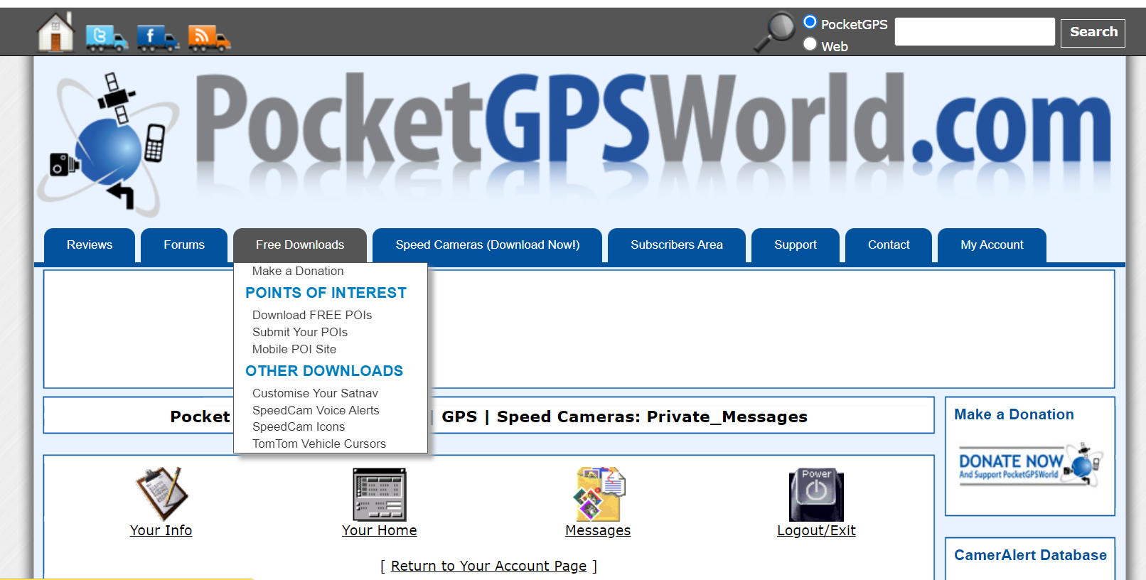

Did you manage to download the Wildcamping POI from this site ?
Cheers again.

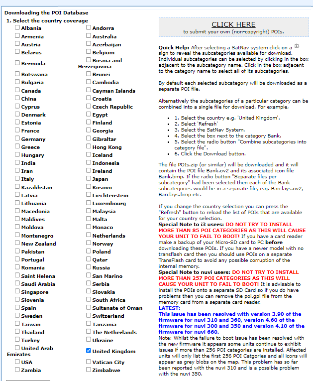

From the website link that you gave:
Adding POI files​
Note: This feature is not supported by TomTom GO Discover, GO Exclusive, GO Camper Max, GO Expert, GO Expert Plus, GO Superior, GO Camper Max 2nd Gen.
