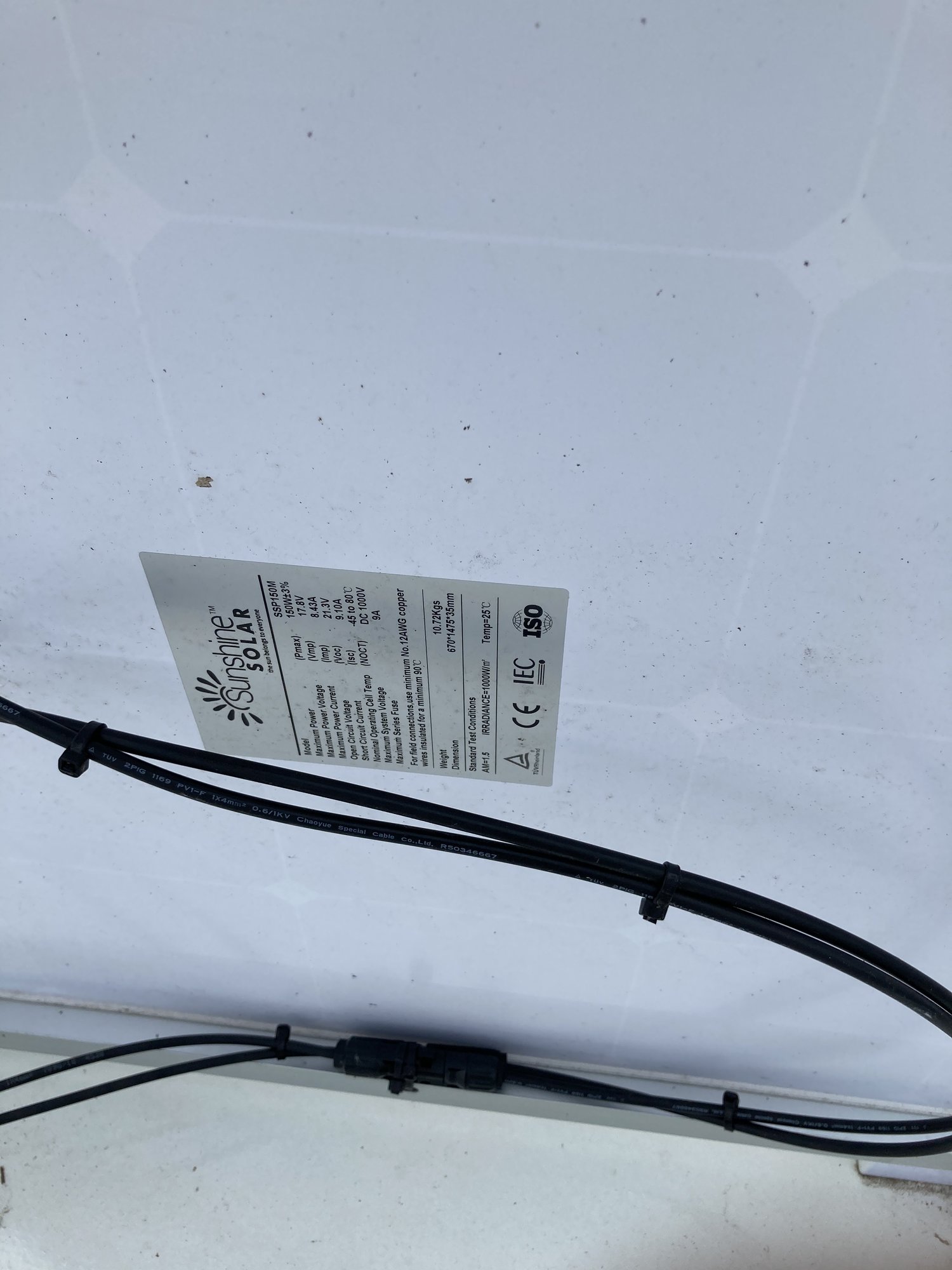

I’ve attached a photo of the underside of the existing 150 watt panel. I’ve made a tilting mount for the 80watt panel and would like to join them in parallel. My question is will they be compatible without the larger one frying the smaller one or the
Victron controller?
The combined short circuit current is 13.67 amps, this looks like the only figure likely to come close to the maximum capacity of the controller which I’m assuming is 15 amps?
