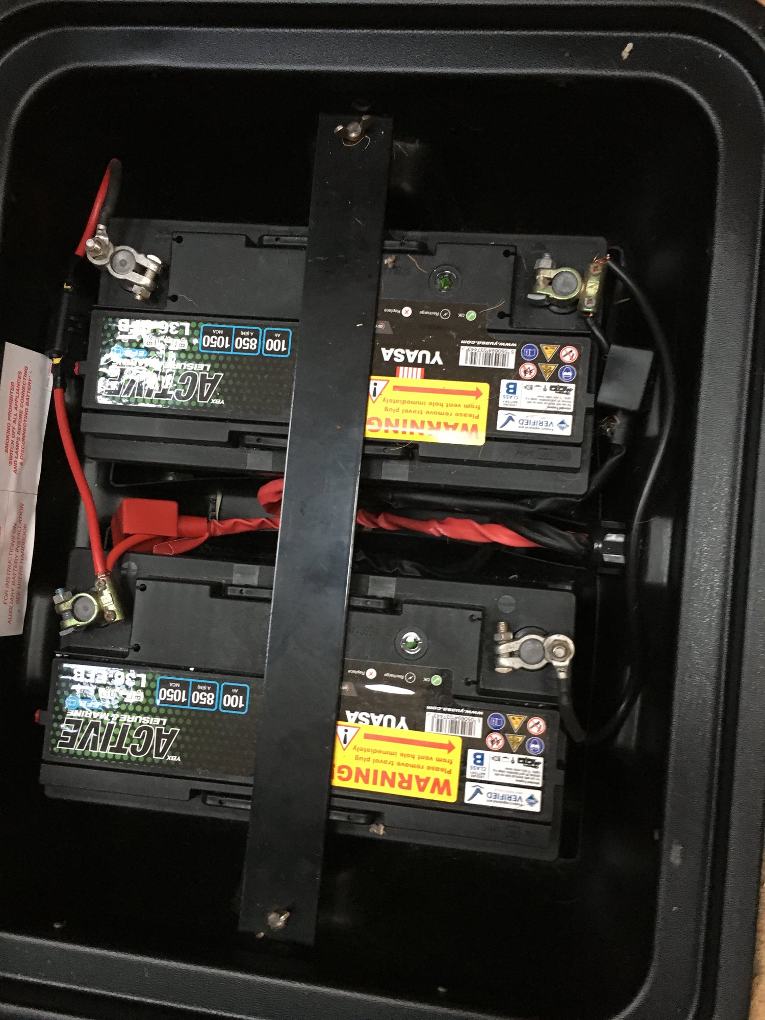

Trev - Hard to tell 100% from the photo, but I think it IS wired that way?Looks ok ,batts should be wired pos to pos and neg to neg, but the take of should be pos of the first battery and neg of the second batt for best results.

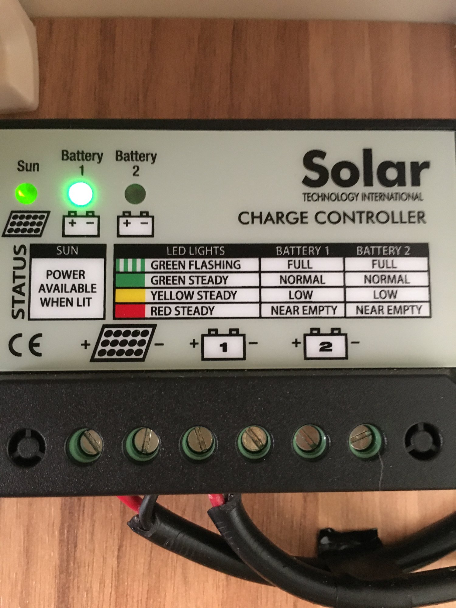

If you have a voltmeter could you please try and get the panel voltage from the solar controller?Oops forgot photos. View attachment 89347View attachment 89349
Yes, please.Ok. Meter on dc. Pointers to red. And black where they join the controller
Assuming you are asking to double-check if the panel is a 12V or 24V panel ....Yes, please.
I may also need you to disconnect one of the wires to get a voltage without a load on the panel.
Panels range in voltage even those that are around 18v. If three panels are being connected together it is important to know the voltage and amperage to connect them by the most method that will give the highest output.Assuming you are asking to double-check if the panel is a 12V or 24V panel ....
If it were a "24V" panel, then the voltage at the PV inputs would be around the 30V mark or so, but whatever it is, it would be over the maximum voltage a "12V" panel would read, no?
So even checking with load would still confirm one way or the other?
indeed so. But there tends to be just the two main variations to need to worry aboutPanels range in voltage even those that are around 18v. If three panels are being connected together it is important to know the voltage and amperage to connect them by the most method that will give the highest output.
