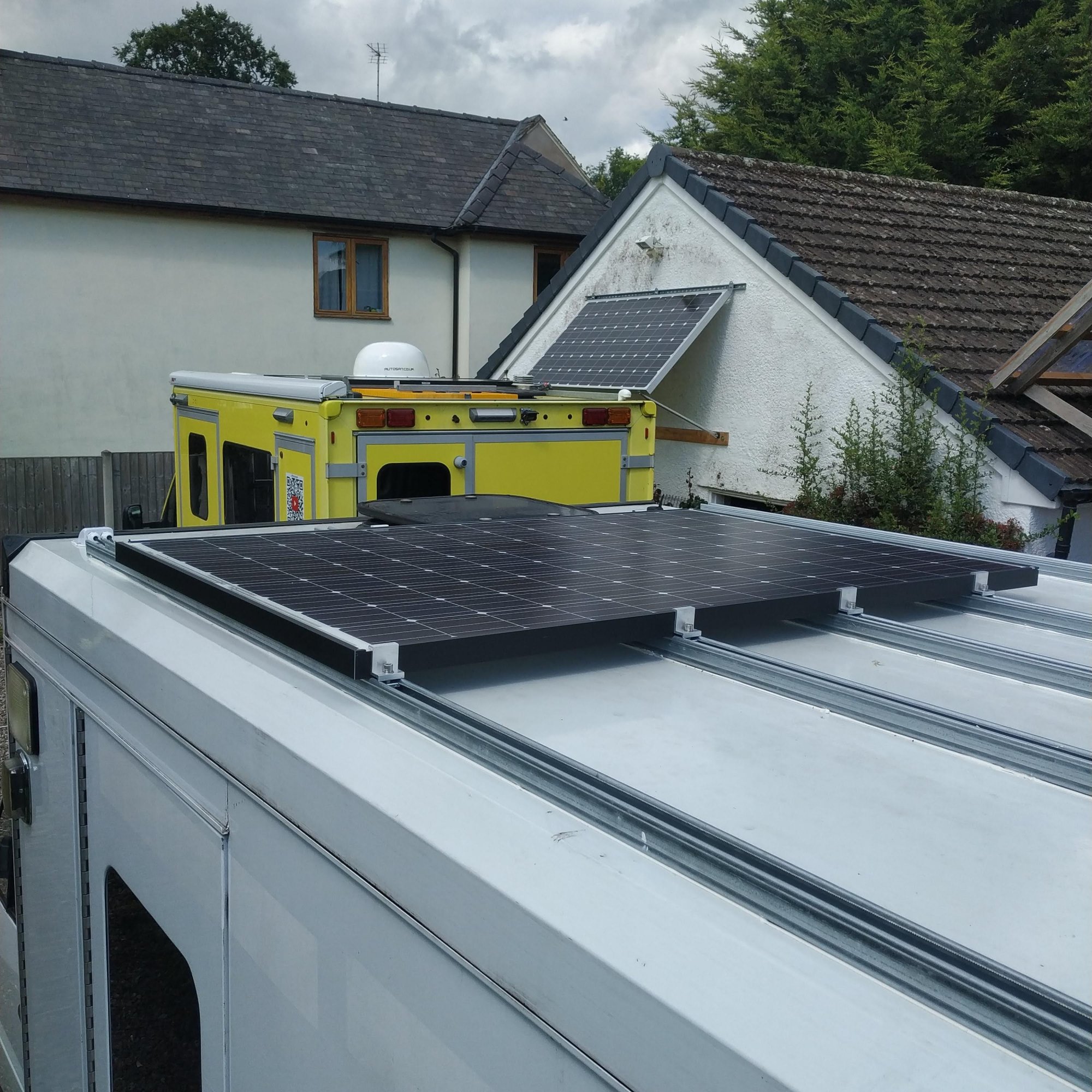

Good point, I really don't know? I know that partial shading limits the output of the whole panel to the current in the shaded zone, I suppose it makes sense that the same thing happens with a hot zone, ie the total panel current is limited to the current in the hot spot?Good idea about support for the middle just wondering if it might create a hot spot where the ventilation can't get to it?
I guess it's something you could experiment with after they're fitted, wait for a day with constant sun and then push a piece of polystyrene under the centre of one panel and see if it's output drops compared to the other.
