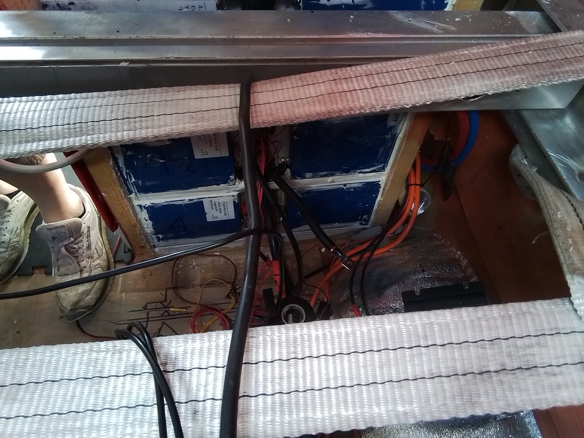

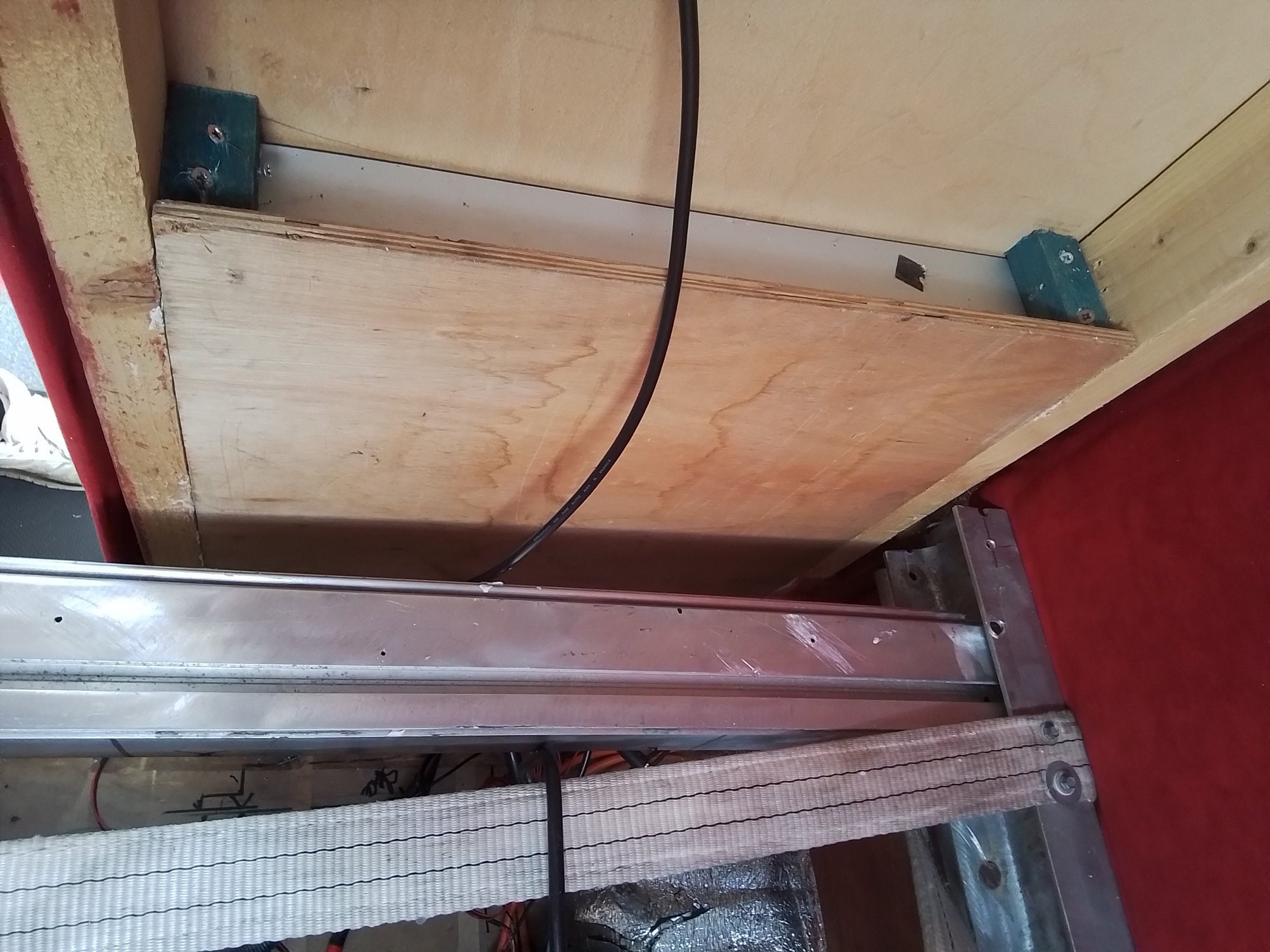

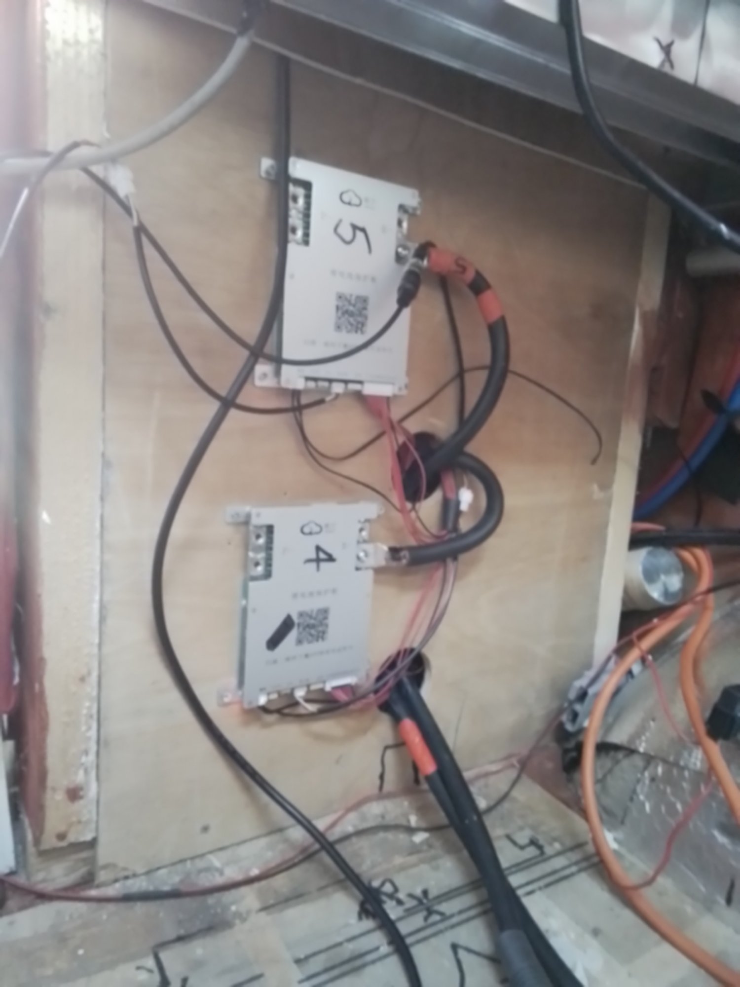

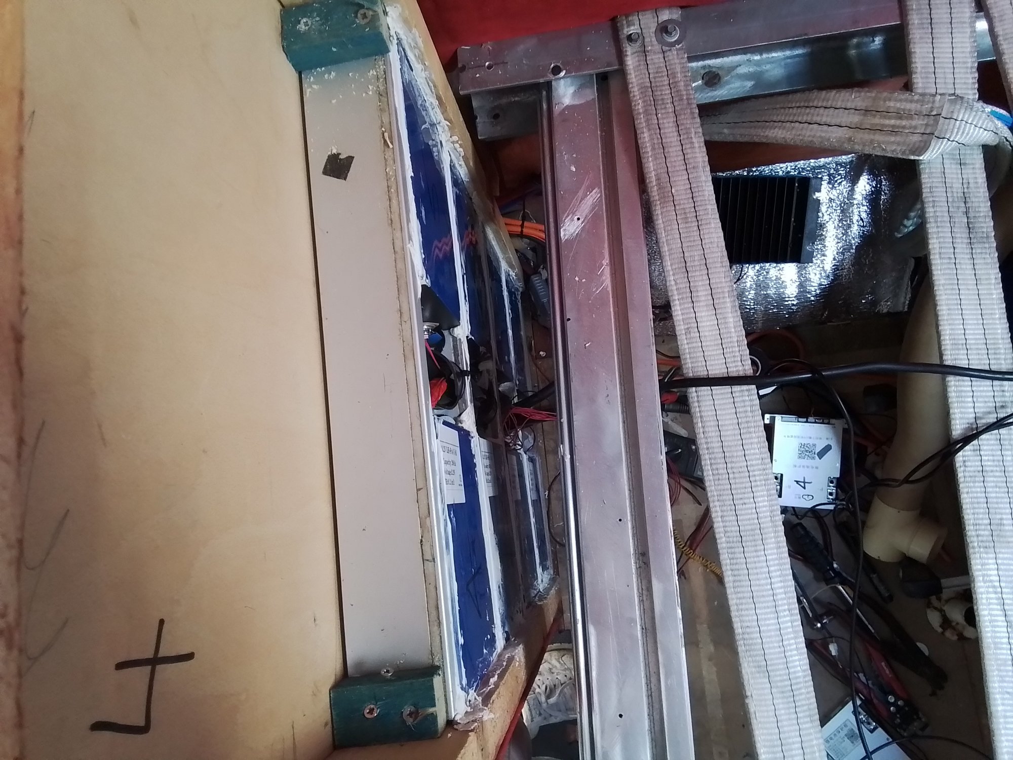

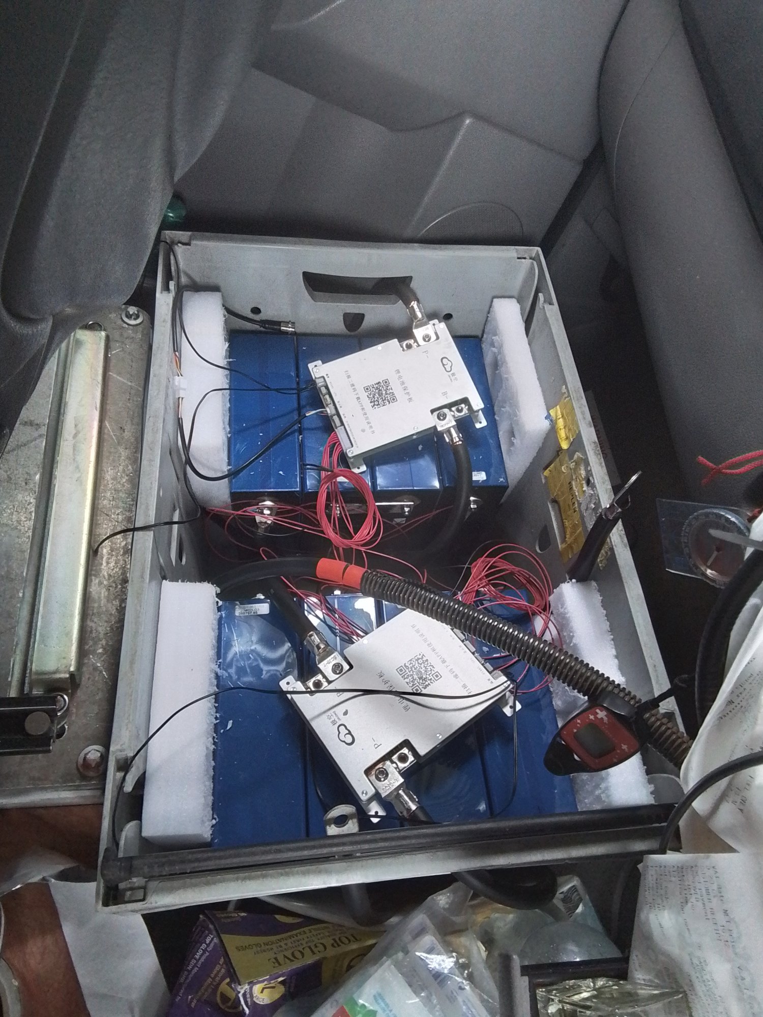

I put my battery's x2 in the shower wall the end of summer this year 2023 but they cost £1500, lithium 280ah cells x8 JK bms included in that price from S Wales, plus70mm wire and crimp connection's they don't need ventilation like wet battery's.
Battery's stacked on there sides, encased in 4 by 2 wood so wall is 10cm thick with 18 mm ply on the heavy side and 12mm in the frame the back as lid
From start up in a crate to done and coverdView attachment 124045View attachment 124044View attachment 124043View attachment 124042View attachment 124046
