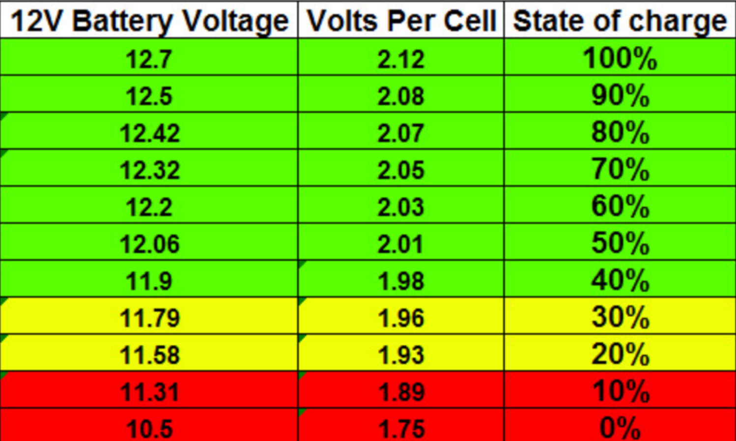

Interestingly there is a sticker on my sargent control panel which says do not discharge below 10.5 volts or it may damage batteries. I have always thought that would be far too low. I wonder why it's there ?Danger below 10.8 they say, im at worst never below 12.2vbut 12.4v is normal when running the fridge over night.View attachment 123150
