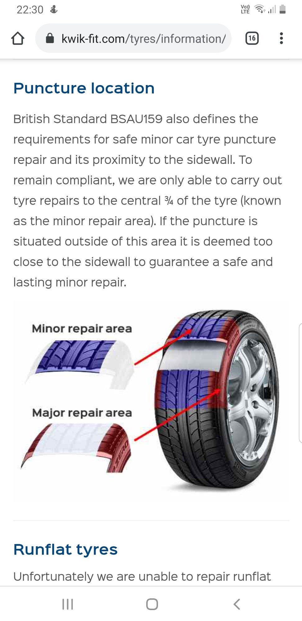

There's a British Standard apparently
So on a 200mm tread width you have to be more than 25mm in for a minor repair.
Nearer the sidewall counts as a major repair and would have to be fixed by a patch on the inside and removing and rebuilding the tread and then heat curing the whole repair.
There are plenty of specialists around the country.
Obviously costs more than the usual £10-20 at tyre 'shops' so only worth doing on fairly new tyres.

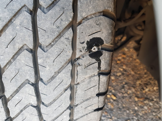

Found this in a tyre this morning, it has a v slow puncture. New tyre a few month back 😢.
Question is - is it too close to the edge for a repair? .(Blackaround the screw is where I made it wet to see if it was leaking)
Should be ok as long as it's not on the side walls!(y)
So all Ok then , it was 32mm from the edge on a 200mm tread (just as your example)
Should be good - they work from centre as it's easier to measure so 200mm tyre size gives 75mm from centre

If it wasn't so new I'd just have got a new one, so I went to independent (not quickfit etc) tyre fitters and they took a look and said it was just on the on the limit of repairable, so plugged and sealed now for £12.50.
