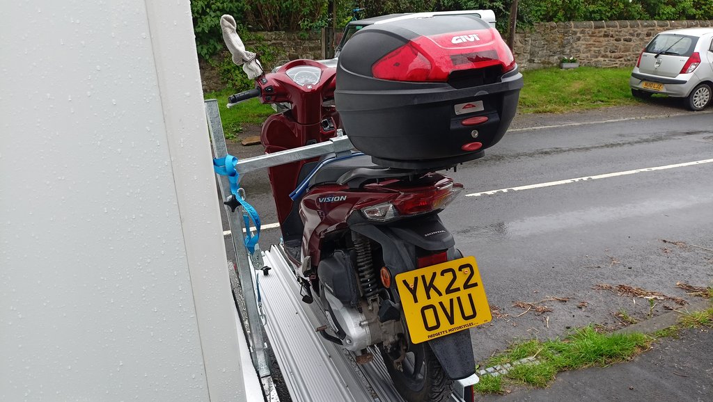

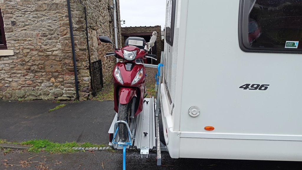

From the horses mouth. Instructions from the Armitage site on this particular rack.
"Firstly you must tie in the front wheel to the wheel loop to stop side movement using the endless ratchet strap supplied or optional handle bar strap, we then go back to the seat clamp and using the ratchet strap with the swivel snap hooks compress the bike down as hard as the ratchet will let you. This will only allow you to compress the bike so far that when hitting a pot hole at speed it will not jump out of the clamp but leave enough movement in the suspension so not to damage it, under no circumstance should you pull the back end of the bike down with another strap then use the ratchet on the seat post as this could then bottom out your suspension and cause damage. As you can see in the photo the ratchet strap on the seat clamp runs up and down the post, it’s only purpose is to compress the sliding seat clamp more than the Human body could compress, this combined with the front wheel strap secures the bike more than adequately keeping all the straps away from the paint work and plastics to prevent no marks or scuffs from straps flapping in the wind."
