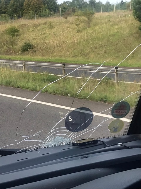

There seems to be some greater power trying to stop us Picts getting to Tintagel though. Today’s mishap........
Sandy thats a bummer about the screen hope that’s the last mishap and you enjoy the rest of your trip. Bonus good weather next week👍
Hard to change bonded screens,go to the best for that one,ins should cover you,aib do.
