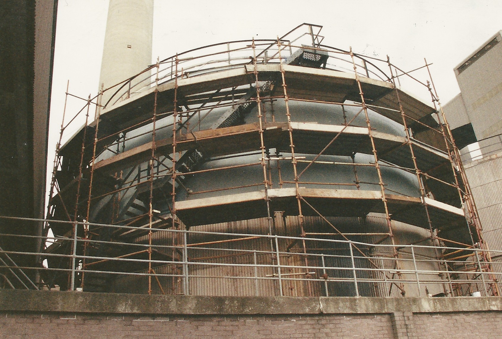

Trev didnt know you used to work at Chernobyl are you sure you know how much pressure to put in them tanks? :rolleyes:
Big oil tanks at Killroot power station outside Carrickfergus, shotblasted and 3 coats of chlorinated rubber put on with an airless gun, paint fan about 6ft and pressure 3000psi :eek:
Trev is this a before or after photograph as if its after looks like you missed all the corrugated sheeting at the bottom with the new rubber paint?
