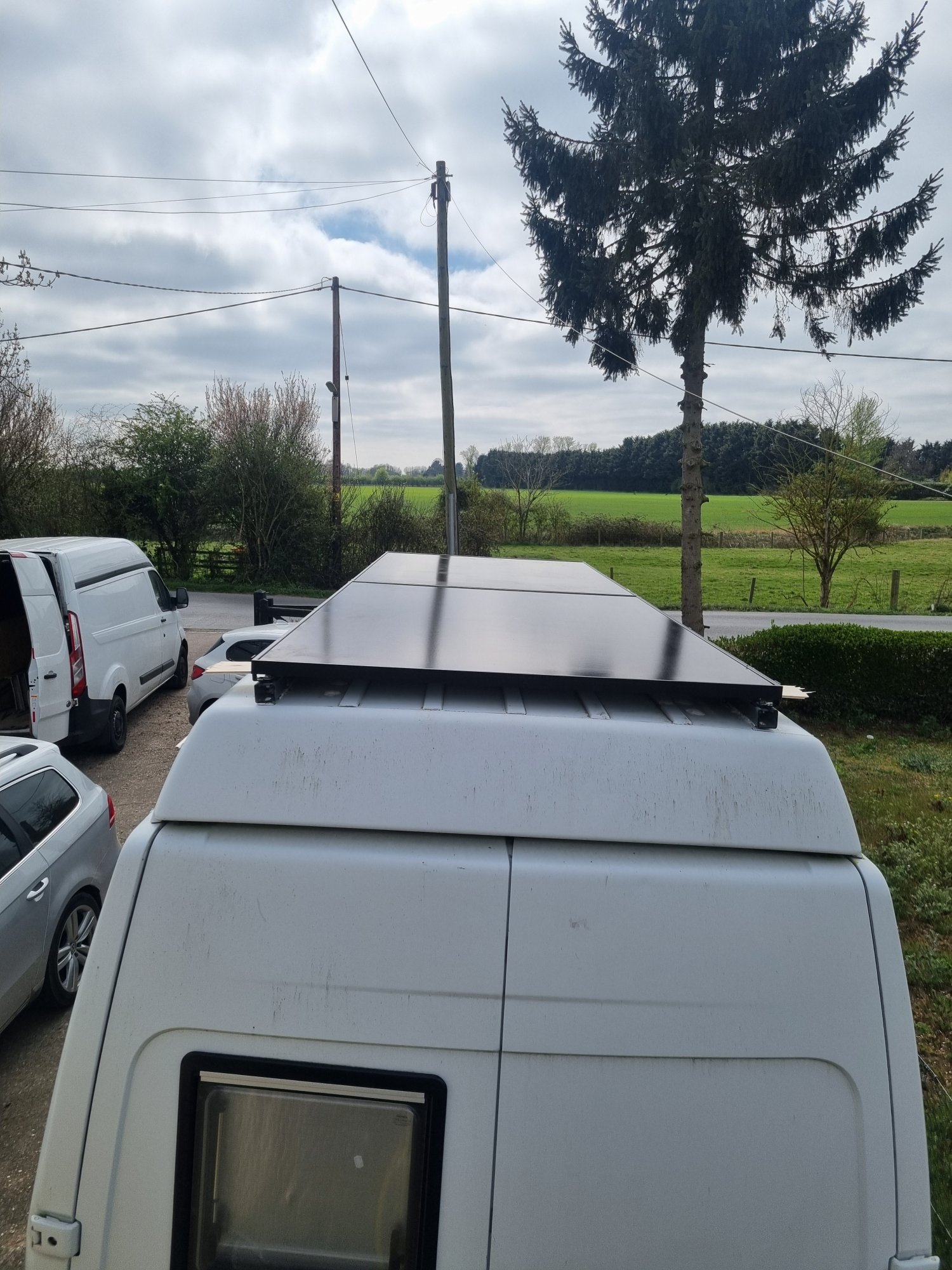

I'm happy to do the panel jigsaw, just want to get as much solar as we can get 👍. How did you secure the panels to the roof? We've had our single, large 330w panel on the Transit roof for several years and several thousand miles. I know this is frowned upon by many but it's secured to plastic corner and mid frame brackets with bolts and in turn the plastic brackets are stuck to the roof with sikaflex. The roof was thoroughly cleaned and keyed first as we're the plastic brackets. I assume I will need to do the same on the Burstner as even if I wanted to it would be difficult to bolt them to the plastic roof.
I used 2 Unistrut bars Sikaflex'd and bolted to the roof and then used 'L' brackets to attach 2 x 425W panels to my plastic roof. I only used 2 bolts, 1 at the front of each Unistrut bar but to be honest I don't think they were necessary.
It is only the front sloping part of the roof that is plastic the rest is aluminium. I bolted the panels to aluminium angle equal to the longer side of the panels and glued them to the roof with sikaflex two years ago …….still there afaik 😉
My panels have been Sikaflexed to the roof over 7 years now using the plastic corner and centre brackets. The brackets are a full moulding so bottom surface area is all plastic, no cut outs, have seen some with not much surface area.
I have no qualms using just adhesive but I do check with manufacturer for recommendations and then do what they say.
If I had a panel van or if my Moho had roof rails I would use unistrut though. More flexibility with that I think and easier option to swap panels/add tilt at later date. At one point I was thinking of sticking unistrut on my Moho roof but didn't, would have to check weight differences now if I wanted to do it
Sikaflex it is then 🙂👍
In that case I think I'll continue with the Sikaflex method, as I say, it's done ok for us on our panel van conversion 🙂👍
