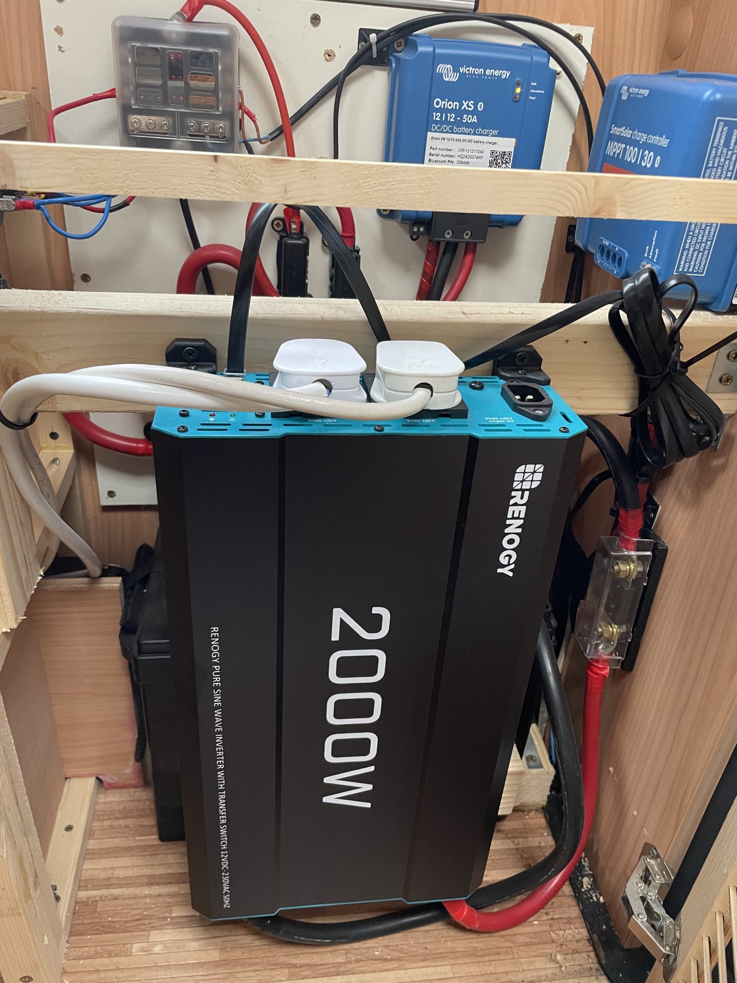

360w solar 300ah Fogstar drift victron smart mppt and Orion 50a b2b with 2000w inverter. To house the new electrics I removed the auxiliary heater fitted under the table and built an electric cupboard in its place. The heater started leaking coolant after a couple of months of ownership while we were in Spain prior to that I hadn’t realised it was part of the engine heating system until we started getting pink puddles on the floor.

Electrics cupboard housing battery inverter and all associated controllers fuses etc.

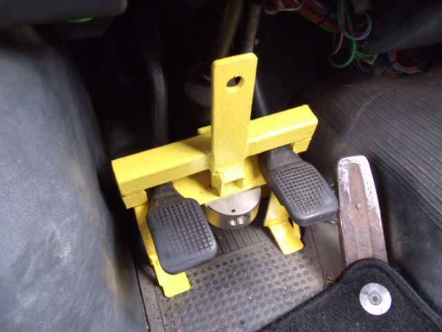

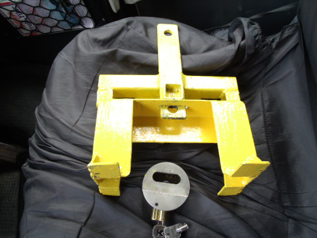

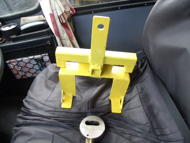

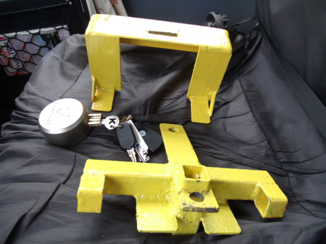

Pedal lock is much better, i made my own after looking at ones on ebay.

No I can’t claim to be a carpenter just a have a goer 😂 I don’t have a disc lock I use the bar through the wheel type. Hope it goes well for you on Tuesday.
Looks good though 👍🙂. Yes, same as me😁. Thank you we are VERY excited 😁
That looks great trev, and very sturdy. Wish I had a welder....not that I'd know how to use it😂. We will be having a pedal lock (any recommendations anyone ?) and a host of other anti scrote devices to put them off. We've sunk all our savings and then some into our purchase and want to keep it!😁

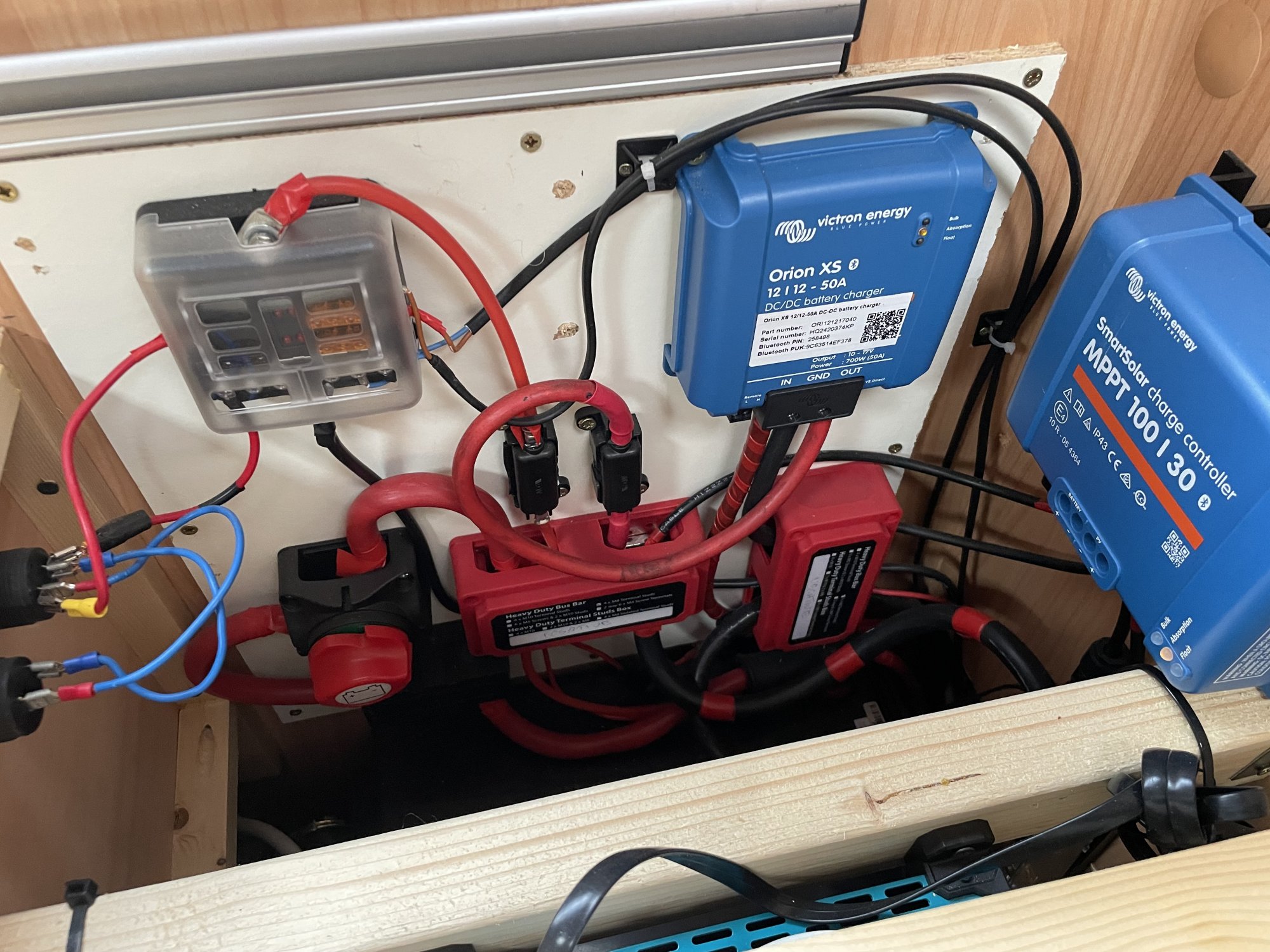

Inside the cupboard the 300ah Fogstar is behind the inverter it wouldn’t fit in the original battery locker that is now used for outside storage. Obviously space is an issue here and cramming it all in was a bit of a game but it is all secure and out of sight.

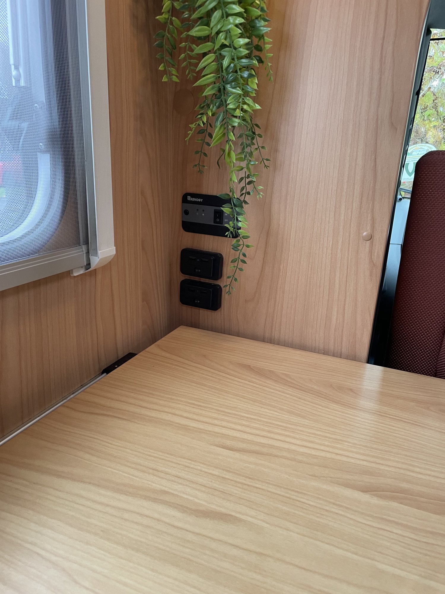

All of the cabling either comes up through the floor or runs up behind the panel to the right of the table covering the cab to body join. Where I have mounted the inverter remote switch and usb sockets

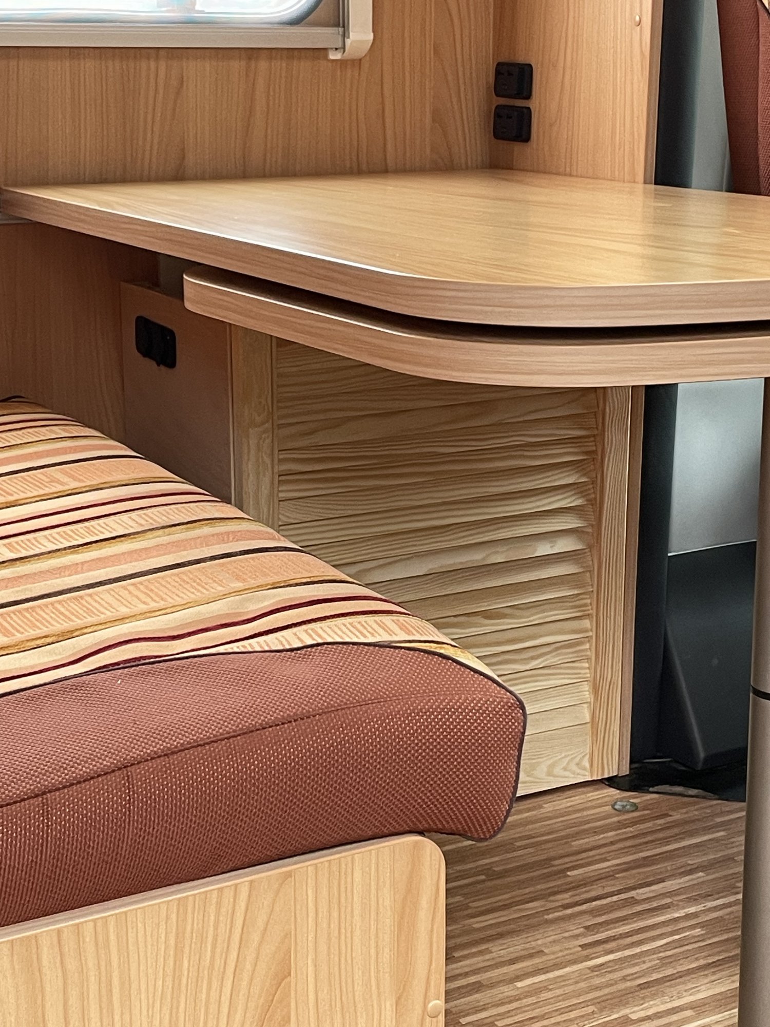

The table forms the lid for the cupboard with a gap for airflow.
Thats a lovely neat and tidy installation, thank you for those photos, and the idea. Can't wait to get started on ours🙂👍. I'm off outside now to remove the ecoflow alternator charger from the Transit. This is a great group and has a mine if information. That you all for your help past, present.....and future 😁👍.
